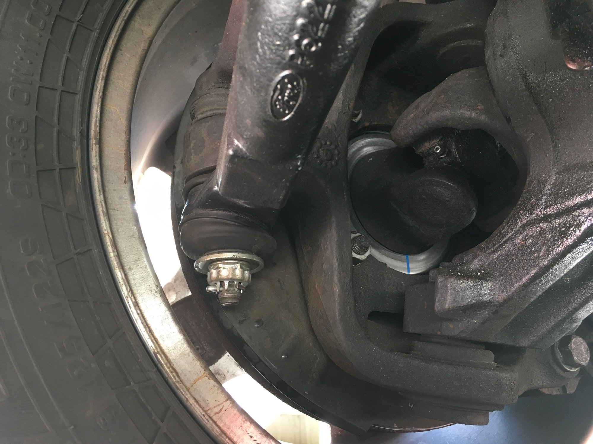

I had the front of my truck on jack stands this weekend and noticed there’s some up and down play in both front axles. If I grab the u-joint I see some movement where the axle comes out of axle tube near dust shield and where it goes to hub assembly. What I want to know is if some movement is normal? 1/8” inch maybe. Called dealer and they told me they have some play even new ones. Seems dumb that they would have play. But maybe I’m missing something. I Wanna hear from you guys. The truck makes no strange noises and 4x4 works fine.

There is some play but an 1/8 might be much...always good to check the needle bearing in there by pulling the wheel bearing out.

That play is normal. The axle shaft is only supported in the differential and in the wheel hub assembly. The rest just floats. You will have some play.

Dealer will replace all of my dust shields under warranty with an upgraded version. They will check play in axles but told me a little play is normal. We’ll see tomorrow.

Update. All plastic dust shields replaced with newer dust shields. If anyone still has Powertrain warranty and has dust shields falling out go to a ford dealer and get them replaced. Didn’t cost anything. I also checked play in front axles on some new trucks. They have play like mine.
