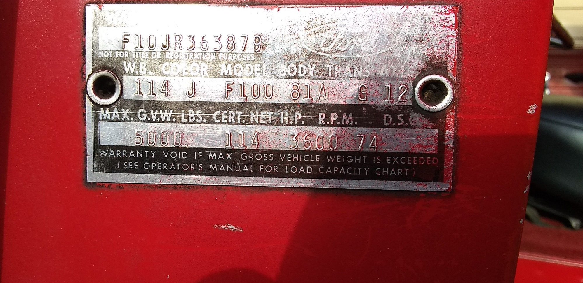

Wrong Bed?
And here's the identification plate.
Old Jul 8, 2019 | 11:39 AM
TA455HO's Avatar
TA455HO
Lead Gopher
Joined: Aug 2012
Posts: 10,015
Likes: 1,566
From: Seattle

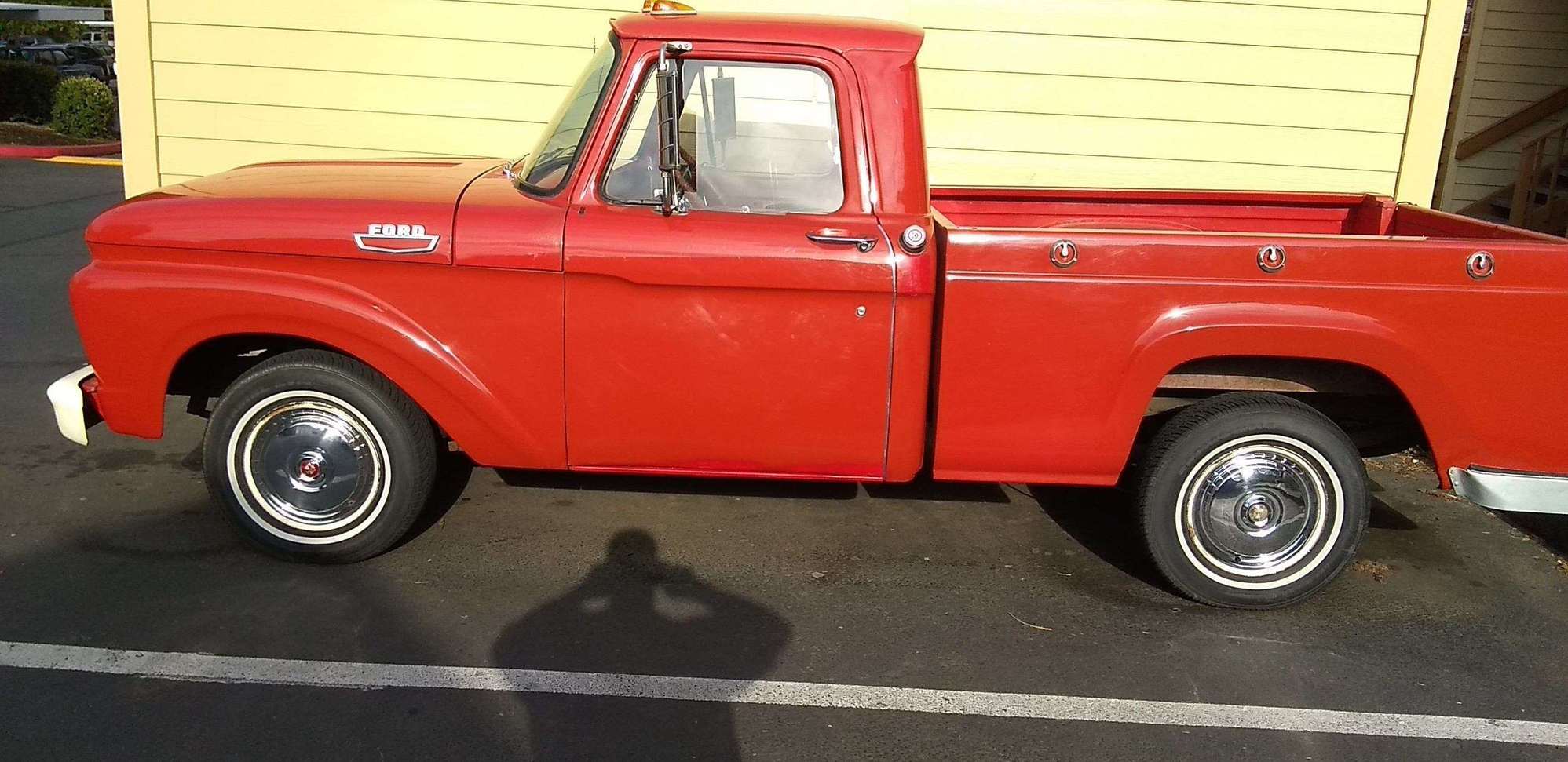

As the unibody trucks were being phased out they also offered a separate styleside bed using the older 3rd generation bed. It's technically not "wrong" since it is correct for a truck like this.
Looks like a fairly clean truck, but no match for your Ranger as far as cool factor. This truck is a Standard Cab instead of a Custom Cab, too.
F10 - F100 5,000 G.V.W Rating
J - 223 6 cylinder
R - San Jose, CA assembly plant
363879 - 1963 model year - built December 1962
114" Wheelbase.
J - Rangoon Red Color code
F100 - F100 2x4 5,000 Lbs GVWR
81A - Standard Cab
G - 3 speed C/M
12 - Ford 9" 3.89 (3.3M) Non-Limited Slip
5,000 lbs. Gross Vehicle Weight Rating.
114 net HP @ 3,600 RPM
74 - District Sales Office - Seattle, WA

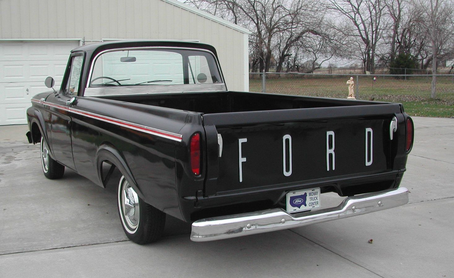

Wow that is bizarre and here it is on a 63 what trim package is that?!?

That's a Unibody with a BBW (Big Back Window)
