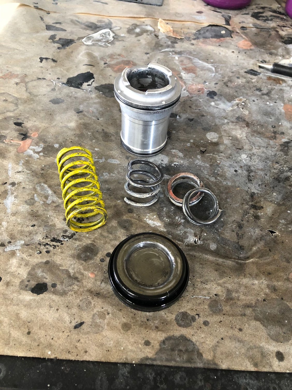

I want to give an update to the problem as I discovered and fixed the issue and hope this information can be useful to someone else in the future.
First, the symptoms that I described in my original post was not entirely accurate. It wasn't that there was a delay shifting into 2nd, but rather I had to rev the engine high enough for it to shift into 3rd gear, I had a complete loss of 2nd gear. While there was a CM code of 668 in the PCM, I checked the resistance of the Range Sensor at both the sensor and PCM ends, which was within specs.
I dropped the pan and removed the 1-2 shift accumulator piston and springs. The bottom spring (white) was broken into 3 pieces. The top (yellow) survived. Ford TSB 97-11-11 corrects a problem with the 1-2 accumulator piston that was used on the 4R70W. You can read about it here: https://www.tccoa.com/articles/mn12-...tsb/TV1111.pdf
After changing both springs, replacement piston, and a new cap, the transmission shifts great now. All I reused was the snap ring retainer.

Cool. Did you stumble upon the TSB and then investigate? Just curious how you decided to check that.

That's correct. I came across the TSB after scouring the internet for hours looking for people with same tranny problem. I bought all the parts several months ago since they are so cheap. Removing the pan on this transmission is a little more difficult than most as the tranny has to be unbolted from the mount and lifted to access two bolts because the cross member is in the way. Also, I have a custom exhaust for my headers that interferes with complete pan removal so I had to drop it, first. Not a huge deal by any means, and certainly worth it to have all my gears back!
