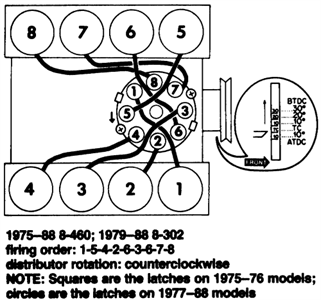

caravaggio2000's Avatar
caravaggio2000
Joined: Apr 2018
Posts: 1,244
Likes: 12
I don't have a 460, so I'm not sure how correct this picture is, but it doesn't look like what you have going on there as far as order.

The distributor had wires and a block on it and a notch in so i cant really mess with the orientation of it and idk if it is bad but to me the distributor looks a little tilted but the rotor spins so idk if that might have anything to do with it

I'm not asking if you moved the cap; there is only one way for it to go on. I'm asking if you rotated the distributor itself, clockwise or counter-clockwise, while you were installing everything else.
Test for spark, That's your next thing. It works just like a mower. Take pictures of your plugs for us while you are doing all that.
