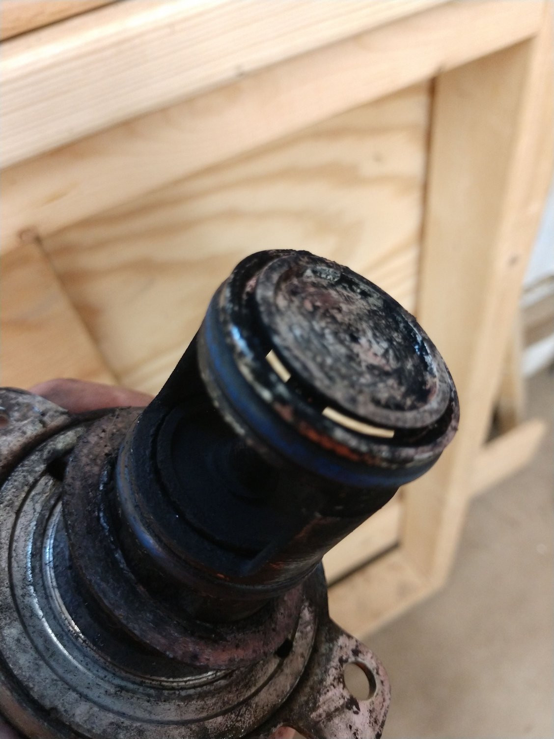

Before I did the VGT relearn I pulled the EGR valve to check it. Both it and the cooler were dry, no indications of a coolant leak. The valve was dirty but not bad, definitely way better than the first time I pulled it. One thing I noticed though is the valve does not seem to be closed all the way. Could this be part of my problem? The last code I had was a P0404 code. Also, I found a thread in an ag forum I'm on where a failing EGR valve is described as causing a lope at idle, more noticeable when cold, excessive black smoke and sluggishness that disappears around 2k rpm. This sounds very much like my truck. Is there a good way to test the EGR valve that I would be able to watch it open and close?

Wanted to close this thread out. I bit the bullet and ordered an EGR valve from ficm repair and got it put in this past Saturday. I did the relearn and heard the turbo changing pitch as well as watched it on TP, good news. Test drove the truck a bunch and am happier with it now. The VGT% still goes to 85% after idling a bit. However, now when I get on it, the turbo comes off 85% almost right away. Way less lag than before. Also, no white smoke at startup or black smoke when driving.
The EGR valve took care of it.
