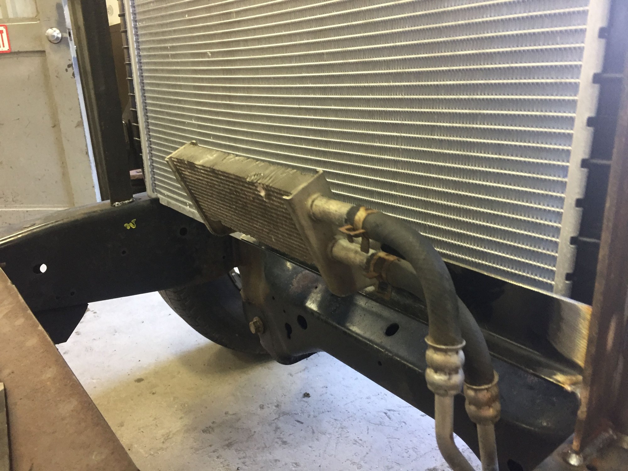

Power steering plumbing.
Here’s hope to these compression fittings working. 🤞🏻 Almost made a boo boo on this and was about to mount the plumbing solid and it wasn’t until after I had cut my piece of steel tubing wrong did it dawn on me that I needed movement to tension the power steering belt.
Power steering cooler mounted.
Another angle of power steering cooler.
Fuel line bracket.
Another angle of fuel line bracket.
