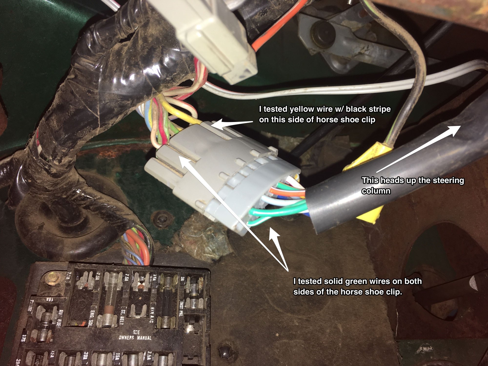

if you have voltage on both the left and right wires the turn signal switch is at least passing current (you didn't specify if the test light was flashing when you tested), you need to confirm continuity from there back to the rear. If I remember, you said you checked the socket with a test light and had no voltage. assuming your test light had a good ground, then I suspect you have an open somewhere between the turn signal connector and the brake lights...
Old Jun 16, 2019 | 10:45 PM
RustyTank's Avatar
RustyTank
Joined: Jan 2018
Posts: 72
Sorry dlburch, I didn't mean to be vague. I checked the solid green wires on both sides of the horseshoe clip as well as the yellow wire with black stripe, which was only on one side of the horseshoe clip. All three wires had the same result, the test light flashed on while the brake pedal was pressed, then off when I released the pedal.
Here's a pic to show you exactly where I checked.
