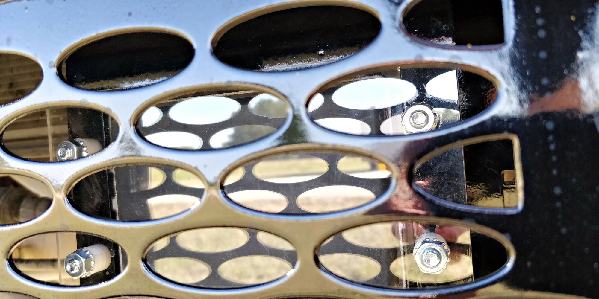

This is the perforated metal grill down low on the Ranch King. You can see the glass plate behind it.

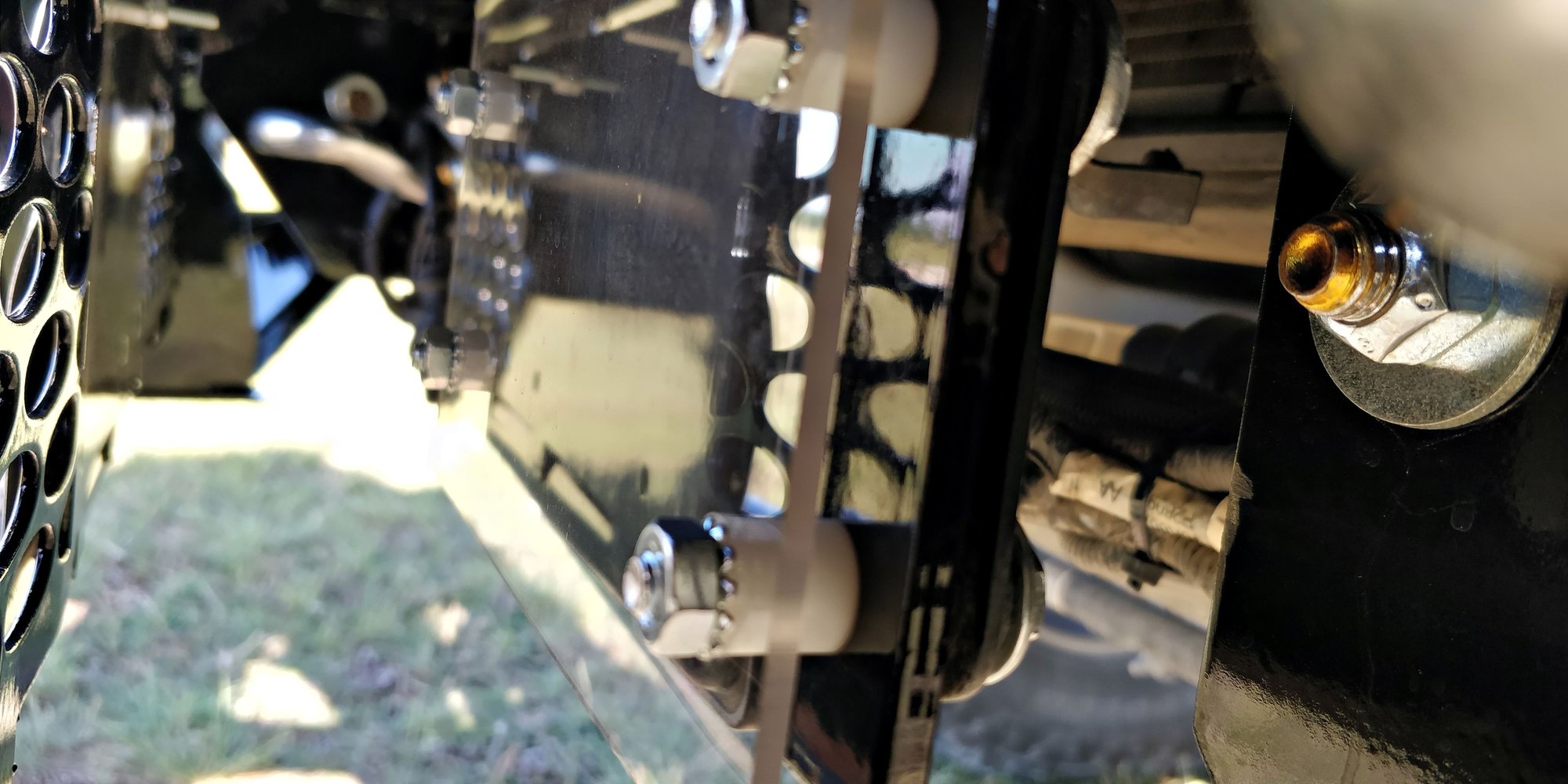

Here is a side view of the glass plate. Looks like I'll need to clean in there if I hit serious mud.

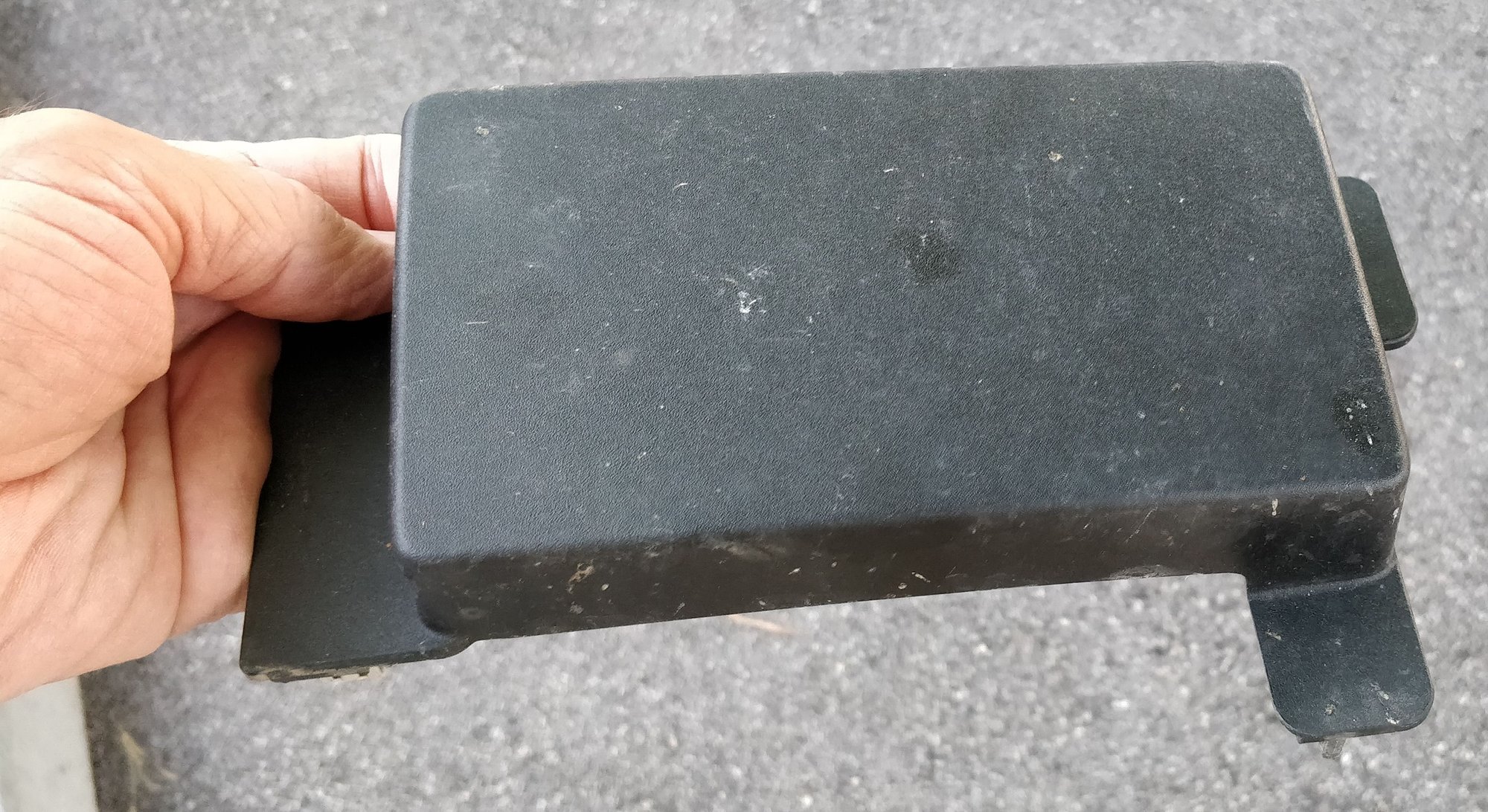

The stock Ford cover, apparently transparent to radar. Maybe I'll affix this in front of the glass plate.

Perhaps replace it with shatter resistant acrylic if it is actual glass in there now?
I've seen a lot of trucks here in Texas with those bumpers and I haven’t heard of something damaging the sensor yet

RenoHuskerDu, I would put that plastic cover on. I don't understand how the radar can work with a metal screen in front of it.

Well it does work. As soon as I left the dealer, I tried it out. As for the plastic cover, it snapped into slots on the stock bumper. I could surely rig up a way to install it in front of the glass, but that would mean the radar would have to pass thru 3 obstacles instead of one. So at that point, I reckon it might have some trouble.

I called Ranch Hand, they're here in TX, and asked what that clear plate is. It's a polycarbonate thang, and they haven't had one break yet. It also keeps the radar from focusing on the expanded metal grill. Neat.

I ran this same setup for several years and never had a problem. The clear cover is strong enough to handle anything that might hit it. Drive without worry.
