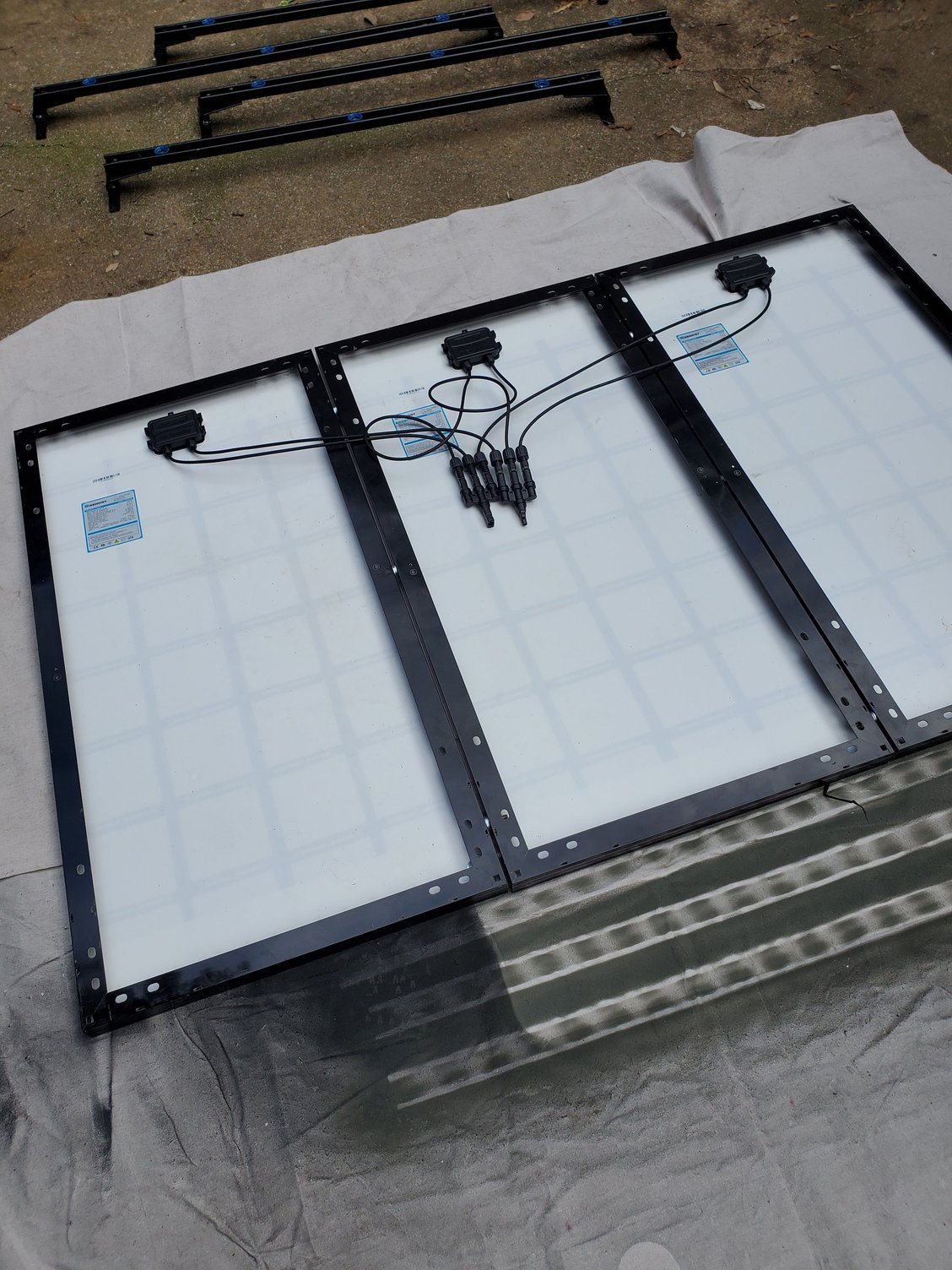

I picked some Renogy panels specifically for the size; these:
I got three. As a bonus, the price changed while I had them in my cart, saving me 120+ dollars for the three.
Combining three panels' wiring is trivial with these,
Bolted together with washers in between to let water and heat escape.

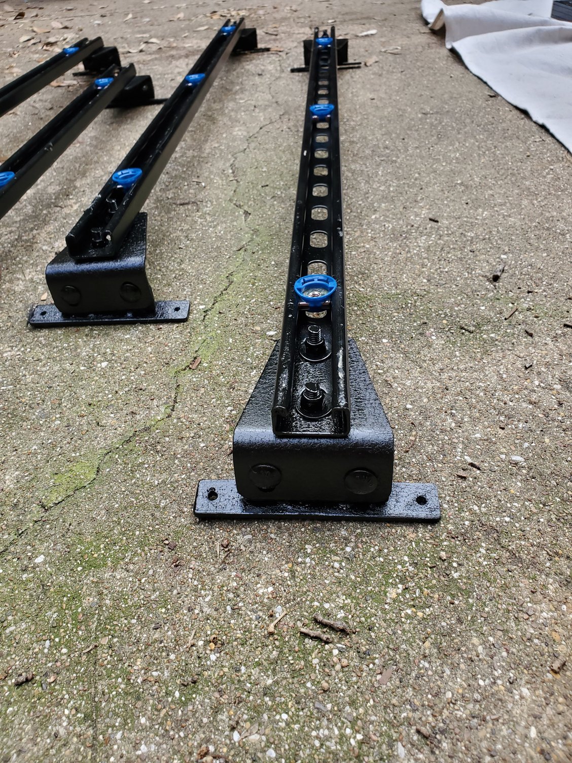

Of course, there are batteries and cables, a ground, programming. The racks are made from these:
The pictures of these don't match the actual ones. The actual ones work in the slide track on the roof.
Cross members are superstrut from home depot and everything is held together the fastenal carriage bolts and regular bolts. As you'll see in the last picture I decided to tuck the cross members in from the sides vecsuse, basically, we have a very narrow treed driveway at the farm so no need tempting any snags, though I did consider having the rails stick out some for side lights. I can still do that but they would be bolted to the aluminum solar panel frames. I probably won't do that. I hate mentioning but anyone who has read my other threads knows I have a vision impairment so I am all about the lights, and, unrelated, I have a very hard time proof reading my posts so please make allowances.
These are VERY sturdy. Not to bore with details, just be assured I measured and just sorted out the bolts and nuts,. Cutting everything with a simple angle grinder. It took two ten foot pieces of superstrut. The little blue and gold nuts are also from home depot and the way they go in dictated the orientation of the open side of the superstrut. Or maybe all from Lowes, I don't remember (they are next door to each other here). In any case, cheap. This is the way to make a cheap and sturdy rack for sure. The mounts arrive with some just OK powder coat so I shot them with self etching primer and black automotive enamel, several coats. The cross members AR a very heavy zinc (yellow) and though I cleaned them with alcohol I'm not sure any paint is going to really stick. We will see. I actually wish I'd not painted the cross bars. My truck has gold accents anyway it might have looked better with gold bars! They are mostly covered so it isn't a big worry, either way.

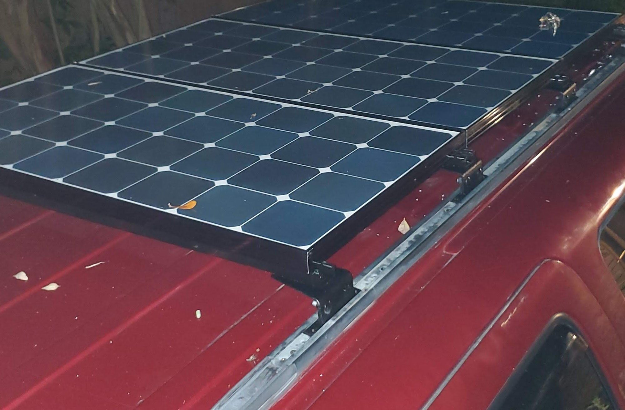

I assembled the whole thing on the ground and had help putting it on the roof. In retrospect the spacers between the panels were a great idea because they gave me a little flex to tilt the feet on the mounts into the track. Without that flex I would have had to remove the end of the track. I couldn't assemble them in the roof vecsuse the way I put the bolts and nuts you simply cannot get to everything (for theft deterrence). However, once the mounts are in place it is SOLID and all flex is gone. Not to overstate, but seriously, seriously solid. Not only is it not going anywhere, I put some thought into the orientation of the bolts, and used galvanized carriage bolts that are captured perfectly by the slots in the mounts, to make it nearly impossible to steal. Sadly one spun and whoa it was a real turd to get off with a nylon lock nut halfway down it. I used nylon lock nuts in some places, and lock washers in others. The result is a comfortable space between the roof and panels so they don't get too hot. A side benefit is that, at about 80 inches long and 40 inches wide, they shade my truck and keep it cooler.
I already have a hard, NMO antenna for my cell booster that is just out of frame so the height of the panels is fine.
These aren't going anywhere. You can rock the truck with them and they don't budge. Note this is before I put the bolted washers on the front and back of each mount to lock them in place. The wiring boxes are underneath now and somewhat protected.
Shows height.
