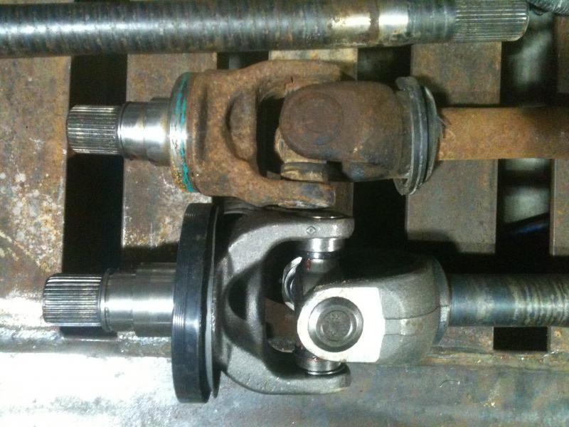

Stub Shaft
Does anyone have a part number or know where a guy can get just a stub shaft alone without having to buy the the complete assembly with both shafts, seals and a joint?
The axle shafts in our trucks have very large 1550 series u joints that allow a lot of steering and fit in the 2005+ Dana 60 steer axles. I crawl rocks and break parts for fun... :P
Thanks in advance-

I didn't come and post looking for common easily found parts, I know better than that. You won't find a chromoly stub shaft for a Dana 60 that takes a 1550 u joint, they don't exist yet. The factory shafts handle a ton of abuse and are serviceable before either the aftermarket wakes up or before we are forced to sped 3.5-4K on one of three solutions currently out there.
I'm just looking to see if anyone happened to work at a dealer or knows something as I can find the inners and outers but we only break the outers, so it would be advantageous to just get the outers.

Thanks, but those are for the Super 60 which are longer.
The regular D60 stub is 7.03" and the Super 60 stub is 7.5" in length.

That is the correct stub shaft for the 450 and up.
Spicer doesnt offer the narrow track stub shaft separately.
Uses the spl70x joint. Aka 1550.

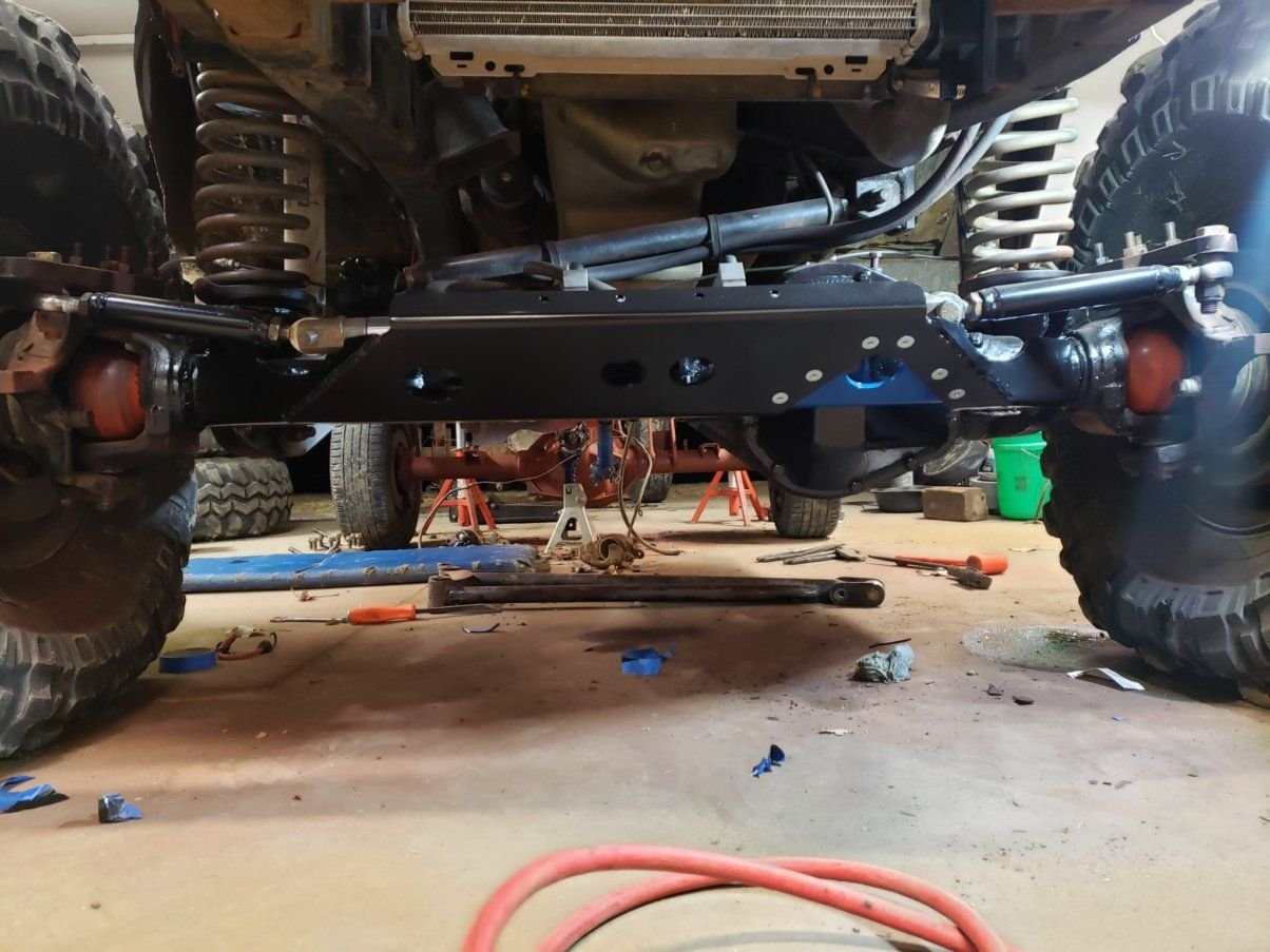

The unit bearing design is fine and now prefered due to service and how far less moving parts are involved.
There are solutions out there, they are just mild to wild. Either you spend $150 on a factory inner and outer (which is still an excellent deal) or you spend $3500 on stuff like this.
...or $4500 on this and end up with even less steering angle than the kit above.
One of my contacts was able to get ahold of some folks at Dana and got the ball rolling to get that stub offered as a single unit, but only time will tell how long that will take. I wouldn't mind paying $250 a pop for a 4340 stub shaft as it is obviously the weak point being so short. The thing is when the stubs break it doesn't even kick the moon clips out, it just shatters inside the unit bearing. This tells me that once we get an upgraded stub shaft we can go down the path of full circle snap rings on the joint and get even more life out of it.
