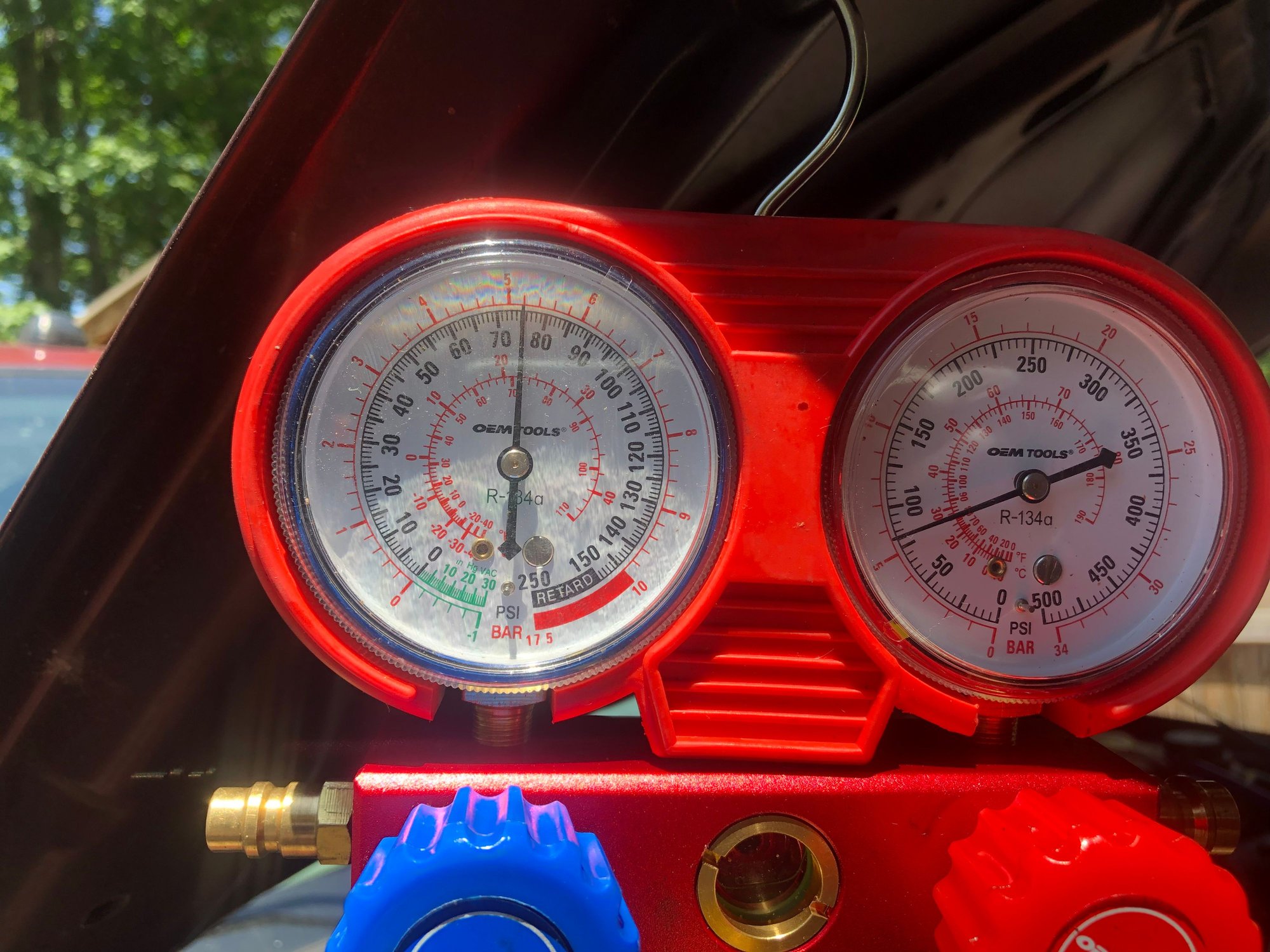

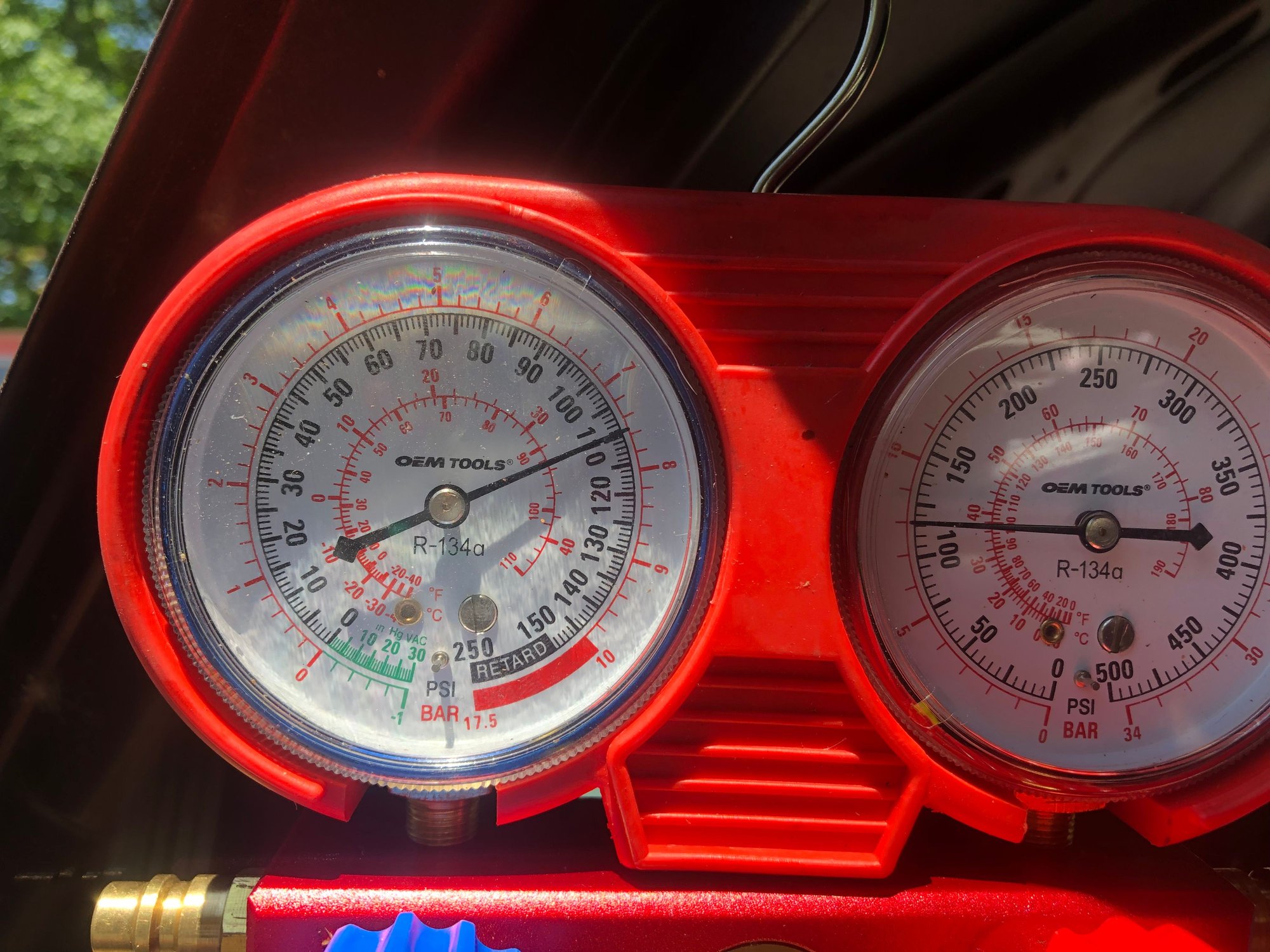

So my ac hasn’t been great for a while, but it seems to have stopped cooling. Turn it on max ac and it just blows warm. It usually starts blowing in defrost but then eventually comes out of the dash vents. The compressor clutch is turning. I put a set of gauges and both high and low side were within a few psi of each other at about 75. After I shut the truck off and it sat, the pressure crept up to around 100. Any thoughts where to go from here? Orifice tube? Pressure switch? Should I have the system evacuated, I can pull a vacuum and recharge.
Your compressor isn't doing any compressing.
Probably the system was just warming up, either from an increase in the ambient temperature or from absorbing heat from a hot engine. That's your static pressure and it's temperature dependent.

Assuming your report of the action of the clutch plate and the shaft turning in unison is accurate, I'd say either the compressor shaft has sheared internally or the reed valves are gone.

Equal pressures (or nearly the same) from a spinning compressor indicate a bad compressor. Going to be hot this weekend in Bedford, Va so you'll be feeling it too! Time to find a good AC shop.
