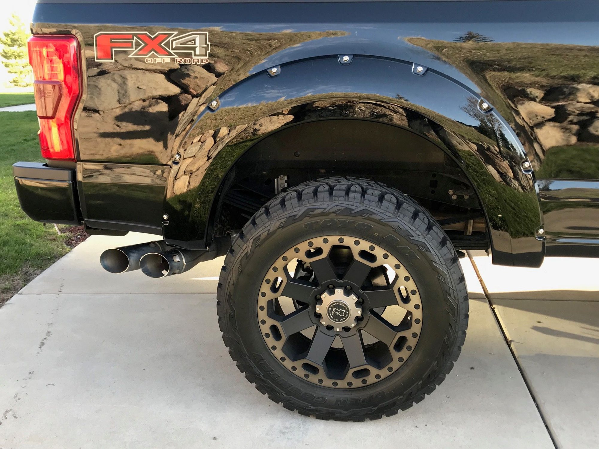

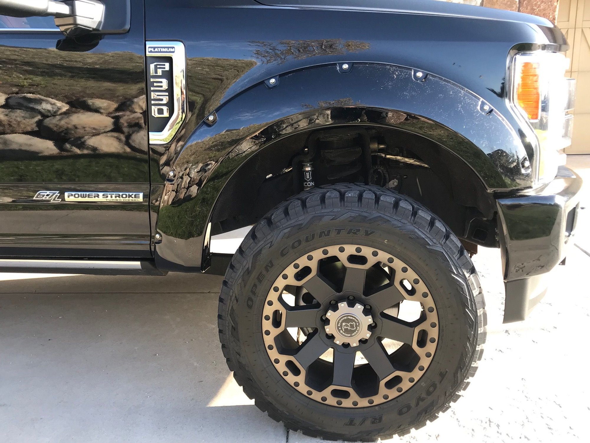

Tedorama's Avatar
Tedorama
Joined: Apr 2013
Posts: 171
2.5 inch level spacers
Adjustable Track Bar
Sway Bar Drop Brackets
Icon Shocks
King SS
22x10 Black Rhino Warlords +12
37x12.50 Toyo RT
slight rub when backing up over dips on air dam is all
