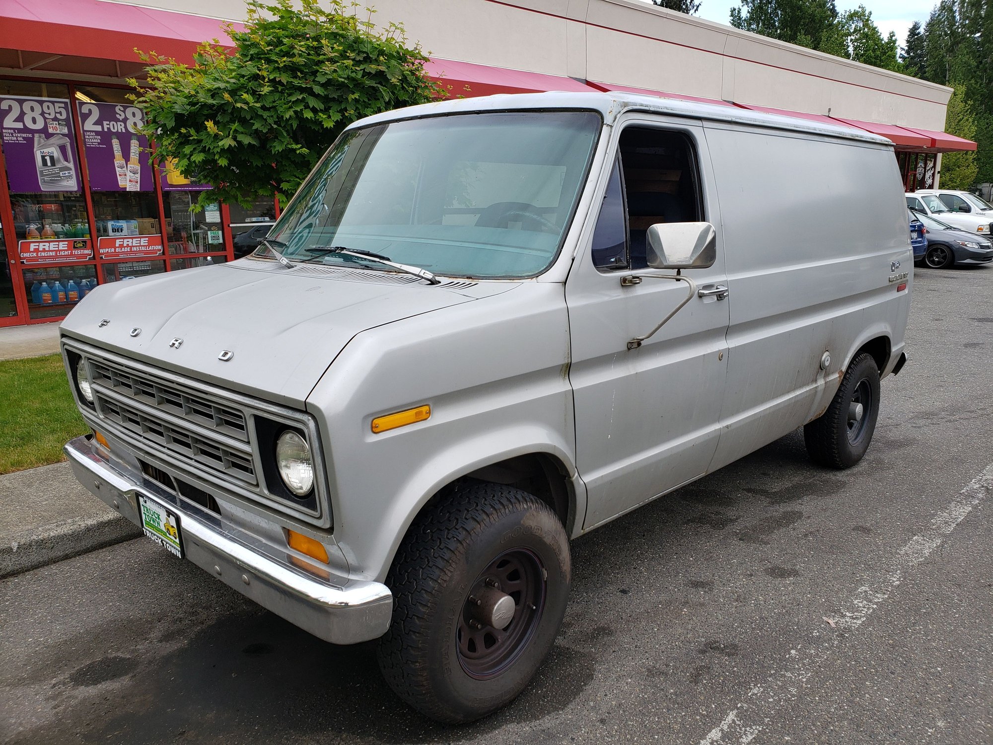

Just picked up a '77 shorty! What was I thinking? It has the 300 I6 with 3 on the tree. It runs real smooth and is entertaining to drive. So little power compaired to the 460 in the truck. Anyhow, I want to do a road trip with my kids this summer. Hope this works.

That looks to be in remarkably great shape at least body-wise. I don't see any significant rust.
The chrome windshield moldings are missing--those could be found in a lot of scrap yards, up to 1991 should fit perfectly. The attachment clips are still available too.

It only has 2 small.places of rust that needs addressed. Thanks for the advice on the window molding.

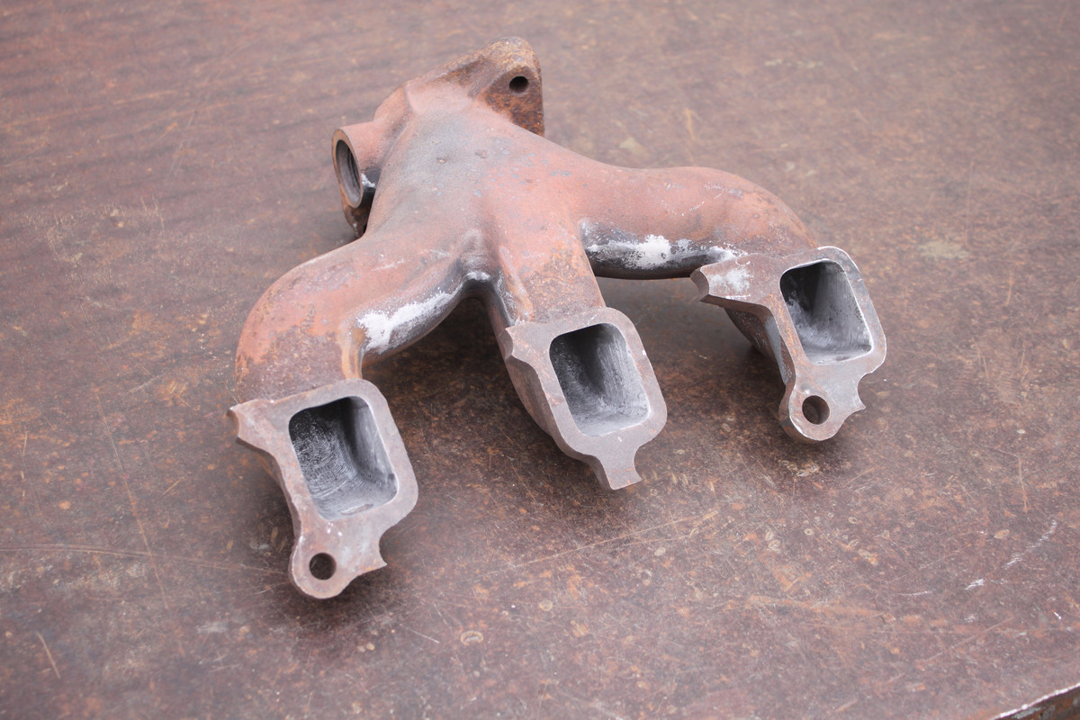

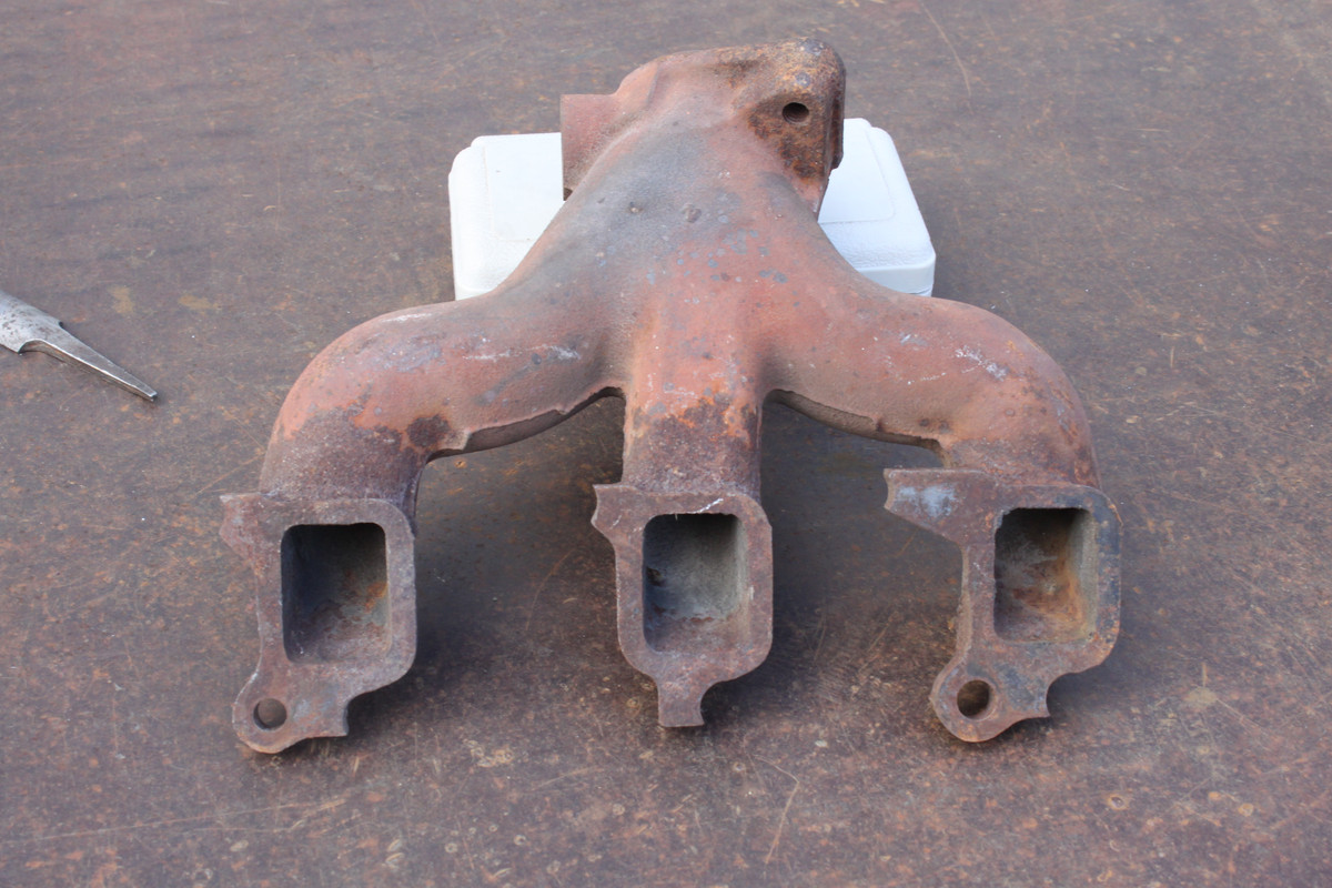

The 300's have a similar bore and stroke to the 400 V8's. Yet Ford decided to throw a little 1V carb on a restrictive intake manifold and a run a restrictive exhaust manifold. I think they didn't want their base engines showing up the 302's.
Yes you can throw a lot of money at them. But there are also a lot of improvements that can be done fairly cheap. Sometimes it takes a little creativity to do it on a smaller budget. But they are easy to work on, so it can be a lot of fun.
One of the best bang for the buck mods is a freer flowing exhaust. You can just do the exhaust system itself. But changing out the manifold gives a much better improvement. One of the most common mods is swapping out the stock carbed exhaust manifold for a pair of the 300 EFI exhaust manifolds. Starting in 1987 the 300 went to fuel injection ( 87-97 ) . And when it did they went to a pair exhaust manifolds that are basically a pair of cast iron shorty headers. These will bolt on to the older engines and flow much better. I've bought these used for as little as $20.00 for a pair. But the going rate is usually around $50-$100 a pair. And with a little time and a few supplies you can port them to flow even better.
Here's some pictures of one of the efi exhaust manifolds that I ported:
Before pictures .
After porting.
