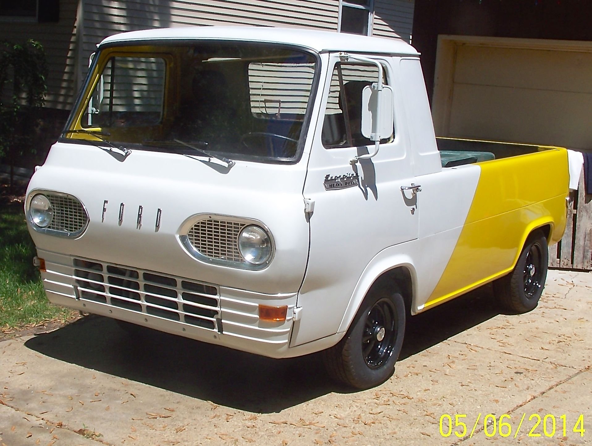

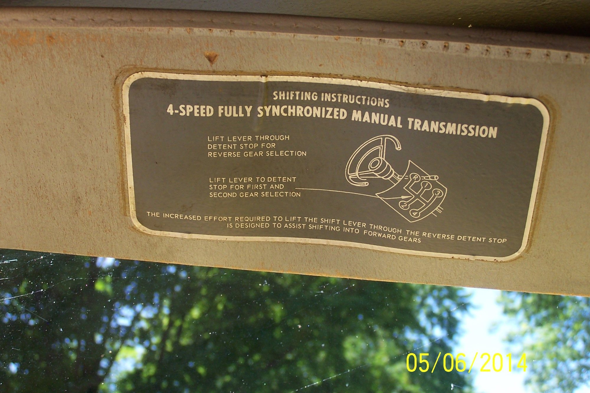

The first series was 1961/67, only E100's were available. Some had the Falcon name on them that confused some people into thinking they owned a Falcon.
I had a 1964 Econoline Heavy Duty, one ton rated, five lug wheels, 9 inch rear, upgraded platform (frame, for lack of a better term), four speed column shift. Not called an E-350, yet it was in everything but name.
Cosmo

Wow, 4 on the column, never seen that before.
Old May 12, 2019 | 04:46 PM
john jamieson's Avatar
john jamieson
Joined: Jul 2015
Posts: 2,069
Likes: 139
From: tucson
That would be neat in a truck. I wonder what transmission the used?

Originally Posted by john jamieson
That would be neat in a truck. I wonder what transmission Ford used?
Dagenham four speed, also known as the "paper four speed". Guess how reliable?? Ratios were a bit off, though the 1:4.57 gear didn't help. Truck was DSO special ordered.
