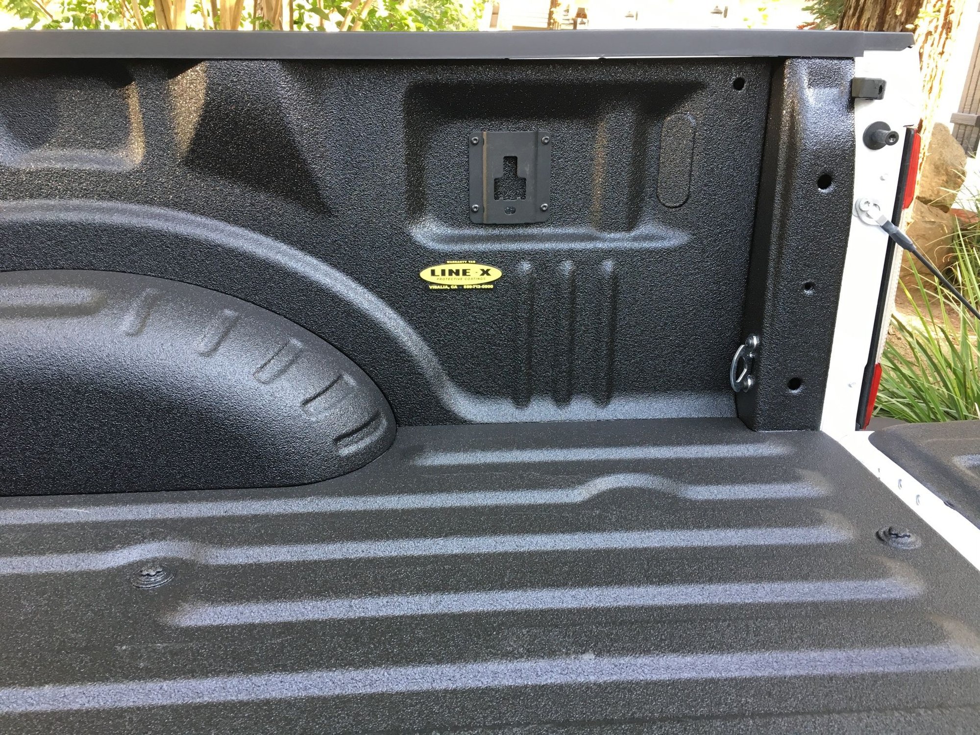

I have had my truck Line X'ed and they removed my bed bolts, box link brackets, and tie-down hooks. Factory liners, they don't remove anything. They spray over bed bolts and mask off around the box link brackets. They have done a nice job and I am very pleased. I got the LineX premium. It does have a tougher application and has UV protection. Well worth the money. You will not be dissapointed. Please don't attempt to do this yourself. Plus LineX has a lifetime warranty nationwide so if you're out of town and have an issue, you can take it to any facility to fix your issue no questions asked. Here are my pics.

So I went the Rhino Liner path via the dealership when I bought the truck. They did exactly what 2019RRSDLARIAT's pictures show as a standard practice. I do not know however, if the dealer gave them replacement bed bolts AND I've noticed a squeak back there recently. I'm wondering now if they reinstalled the bolts, and they've loosened up.
The other thing to consider is that I've had issues with the box link brackets. They were removed and the liner was applied underneath (as opposed to spraying around the brackets). The problem is that things don't fit in there anymore. I had to shave a bit of the plastic down, or use a literal sledgehammer to get thingamabobs into the bracket.
If I were to do it again, I'd spray over the bed liner bolts, and go around the box link brackets.
