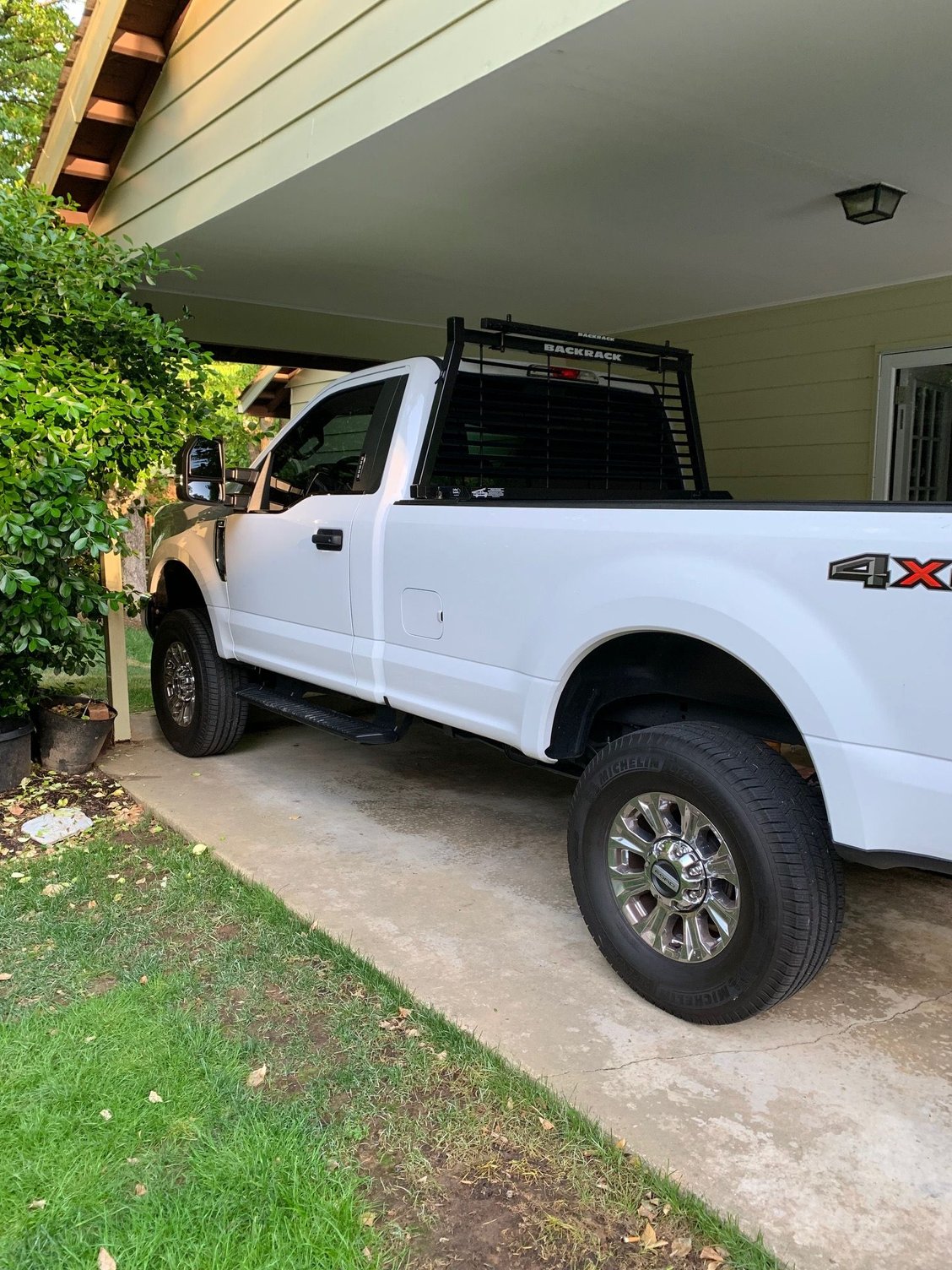

Xl with RC 2" leveling blocks, Springs ride better blocks sit 3/4" higher. all 11 trucks run same wheels tires Zero DW or Bump steer ready lift Track bar bracket and Fox Shocks everything else stock, shims are in the Spring box.

Yea they all do and 430 rears. Reg cabs may sit a little higher First pic below is 2" Blocks 2nd pic is 1 1/2" blocks both with stock wheels

Those regular cabs just look sick!!! I want one! Are those wheels Method Double Standards? Damn it I should have ordered a white truck...

Yes
