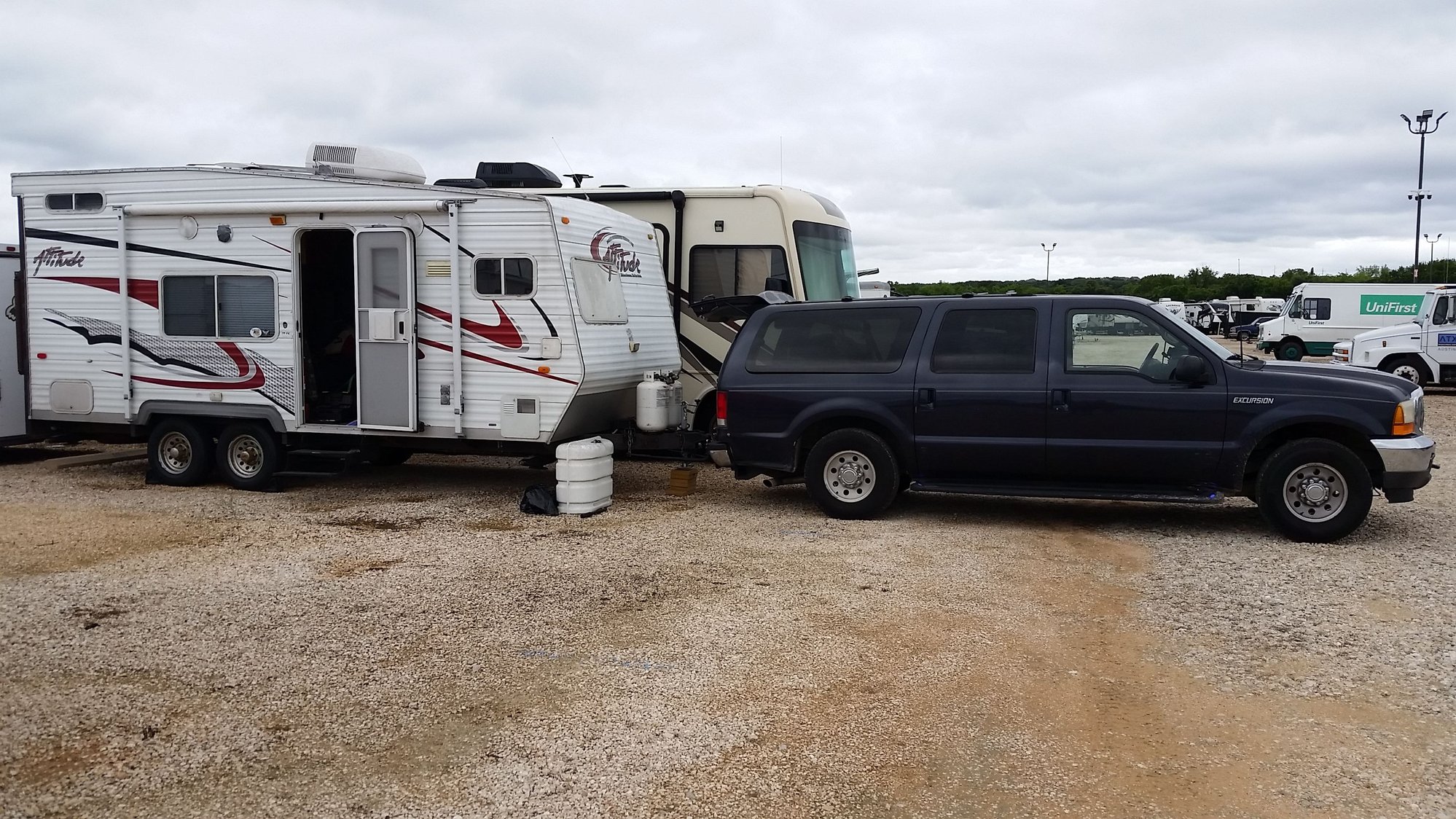

from the pics I would say sooner rather then later on the bags.

I’m not an expert by any means, but that picture looks
like way more sag than I would expect. It looks
like you are using a WD hutch, what is the tongue weight of that TH?

Do you know how much tongue weight you have there? That is dropping pretty hard.

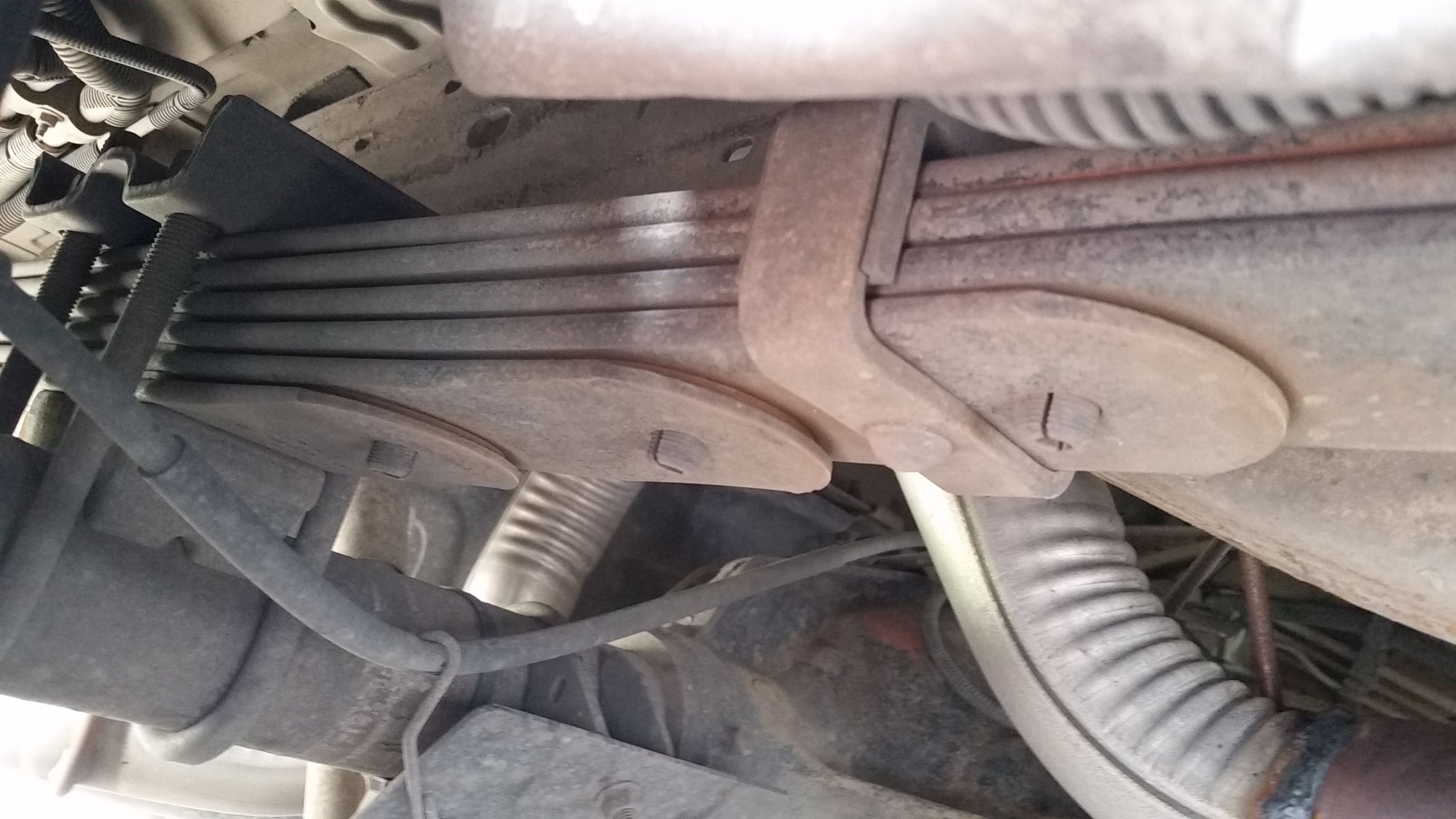

Springs look like (based on reading a bunch of spring threads) stock Ex springs:
Thanks for your comments!

yes those are stock springs, post the 2 measurements i detailed above and i can tell you uour exact tounge weight

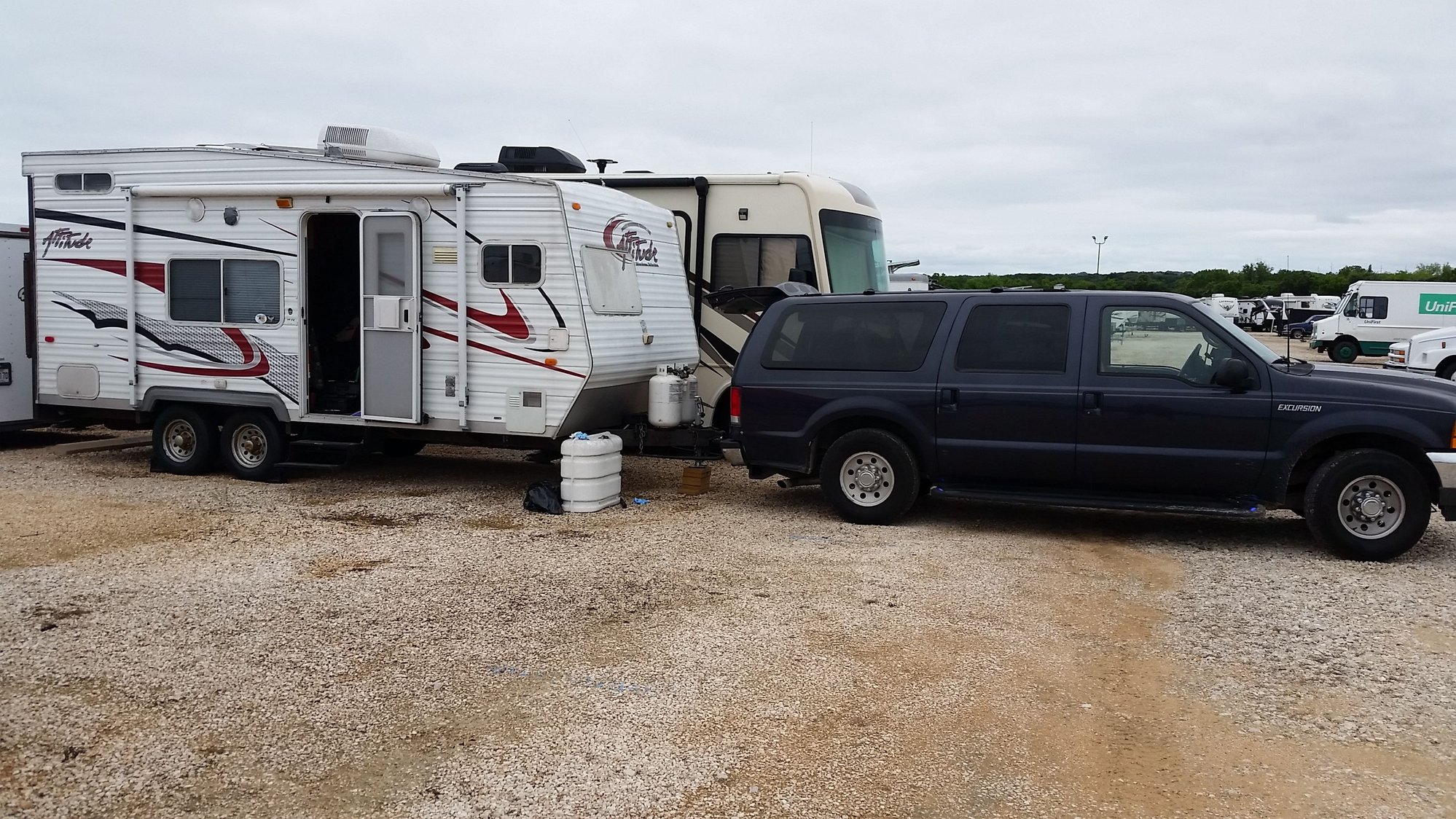

I spent a little time fiddling with my hitch today. First pic is without the WD bars hooked up.
2nd pic is with the bars hooked up, 1 link shorter than the picture above (6 links).
This did not level the Ex enough. So...
Final pic, I tilted the hitch head back. Trial and error I ended up adding 3 washers to the spacer stack. Bars hooked up with 7 links like picture at start of thread. Hard to tell vs. pic 2 above, but it made a difference. Ex is almost exactly same height as unloaded.
