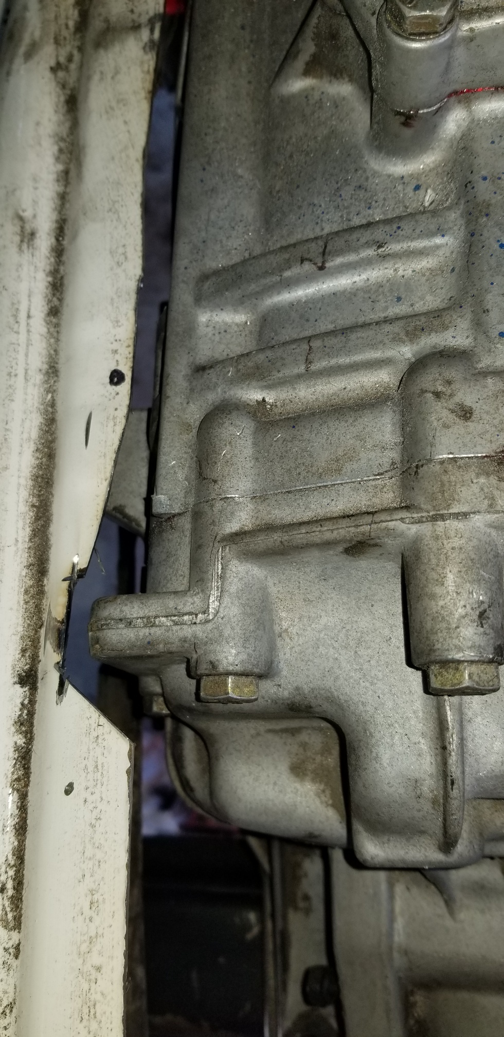

The 3rd gear synchro is worn and makes shifting up into that gear slow and I lose acceleration. When I shift up into 3rd and accelerate, it makes a terrible rattle-like noise.
I'm spending time trying to shift smoothly despite the 'bite' I feel on the stick when going into 3rd. I'm also eliminating sources of possible rattle. We'll see.
