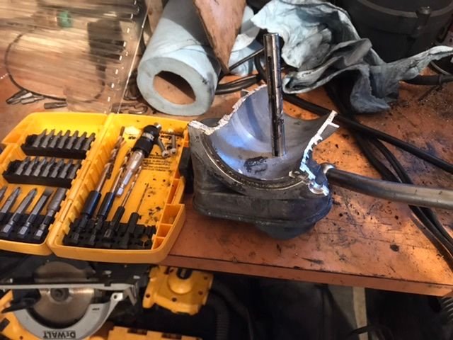

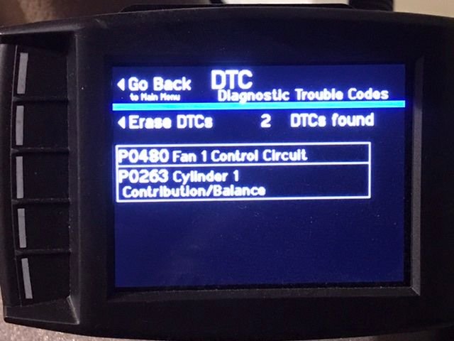

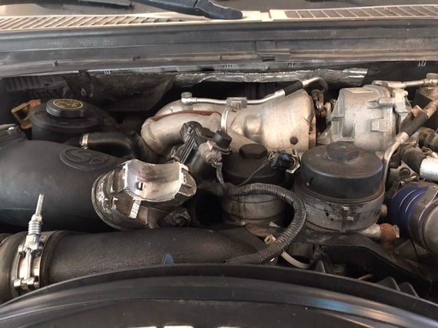

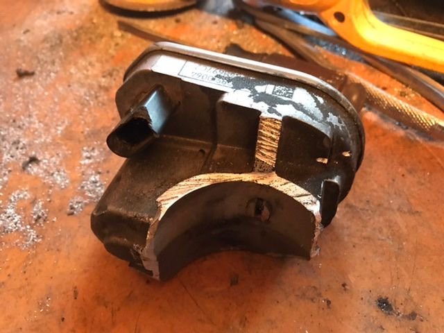

P0480 Fan 1 Control Circuit Code showed up after EGR delete and added H & S Tuner, I read how to fix
Originally Posted by copsey
If you still have the EGR valve plug it back in and lay it in the valley. For some reason the EGR valve not being connected can cause fan control issues. I had EGR delete with some odd fan control issues that were resolved by plugging the EGR back in and letting it sit in the valley.
Last year I switched to the 7.3 mechanical fan so I have an EGR valve not being used if you need one.
wow, thanks a bunch for helping here as this was a problem that had me stumped and your recommendations fixed my problem totally...
I have a 2008 F450 6.4, completed a EGR delete and installed a H & S Tuner, right after I did it this P0480 Fan 1 Control Circuit code showed up and would come back after clearing every time... I looked high and low, but couldn’t figure it out till I read this thread and tried it!!! It worked perfectly.
I chose to hook up all 3 electrical connections to the EGR parts I originally removed as who knows maybe they affect other things? I also cut them down in size so as not to take up to much room as you can see in the pictures. I’ll wrap them in tire rubber and leave where they are in the picture.
I really appreciate this thread and thank you for posting it as it helped me finally fix a issue I couldn’t figure out why the code kept popping...
This fan 1 control circuit fault showed up after I removed the EGR and won’t go away until I rep lugged the EGR valve back in... you would think that the H & S tuner would of fixed this...
I cut the parts down in size to reconnect them back up and leave under the hood so the code won’t show up.
I’m not sure which device made the code go away, but I decided to just hook up all three and leave under the hood. As long as the code went away I’m happy
