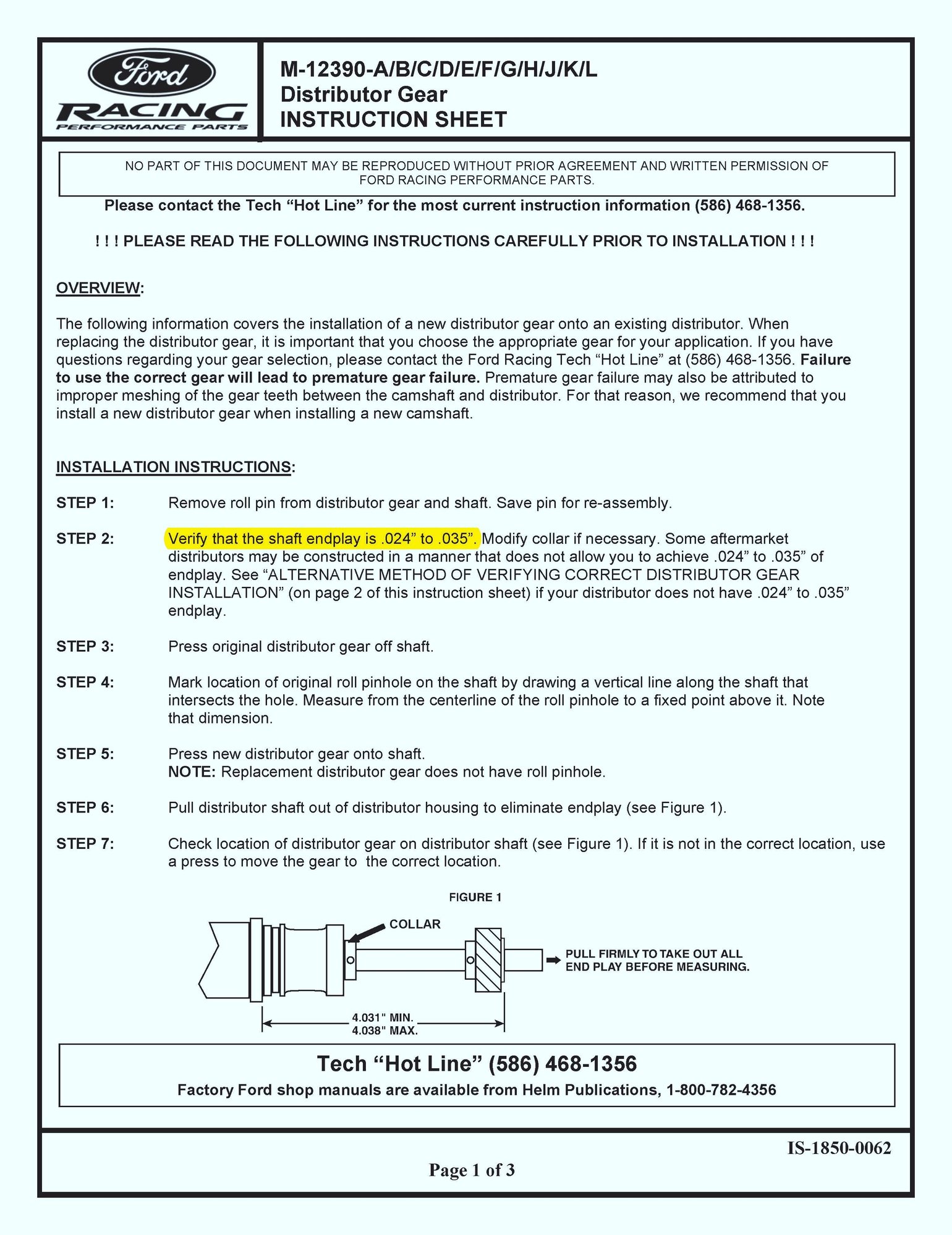

Nick before you order a distributor, you must put your engine on TDC on the compression stroke on cylinder #1, photograph where the rotor is on your distributor, then pull the distributor and see what color is painted on the distributor gear. See page 3. The distributor gear must be the right material for your cam or it will ruin your cam. So, you can only order a distributor with the same color paint on the distributor gear that your existing distributor gear has (i.e., gearis made of the exact same material). My 1995 distributor gear was steel i.e., yellow paint. So is this one:
https://www.summitracing.com/parts/s...BoCMQ4QAvD_BwE
But what is your distributor gear?
I found new old oem stock, but I think a Spectra Premium would be fine.
I have seen some 351 distributors out there with cast distributor gears. Ordering one of those would be a mistake if your distributor gear is steel.

Nick before you order a distributor, may I suggest that put your engine on TDC on the compression stroke on cylinder #1, photograph where the rotor is on your distributor, and don't move the vehicle. Then pull the distributor and see what color is painted on the distributor gear. It is likely Yellow paint indicating a steel gear. See page 3. But the distributor gear must be the right material for your cam or it will ruin your cam. So, you can only order a distributor with the same color paint on the distributor gear that your existing distributor gear has. My 1995 distributor gear was steel i.e., yellow paint. So is this one:

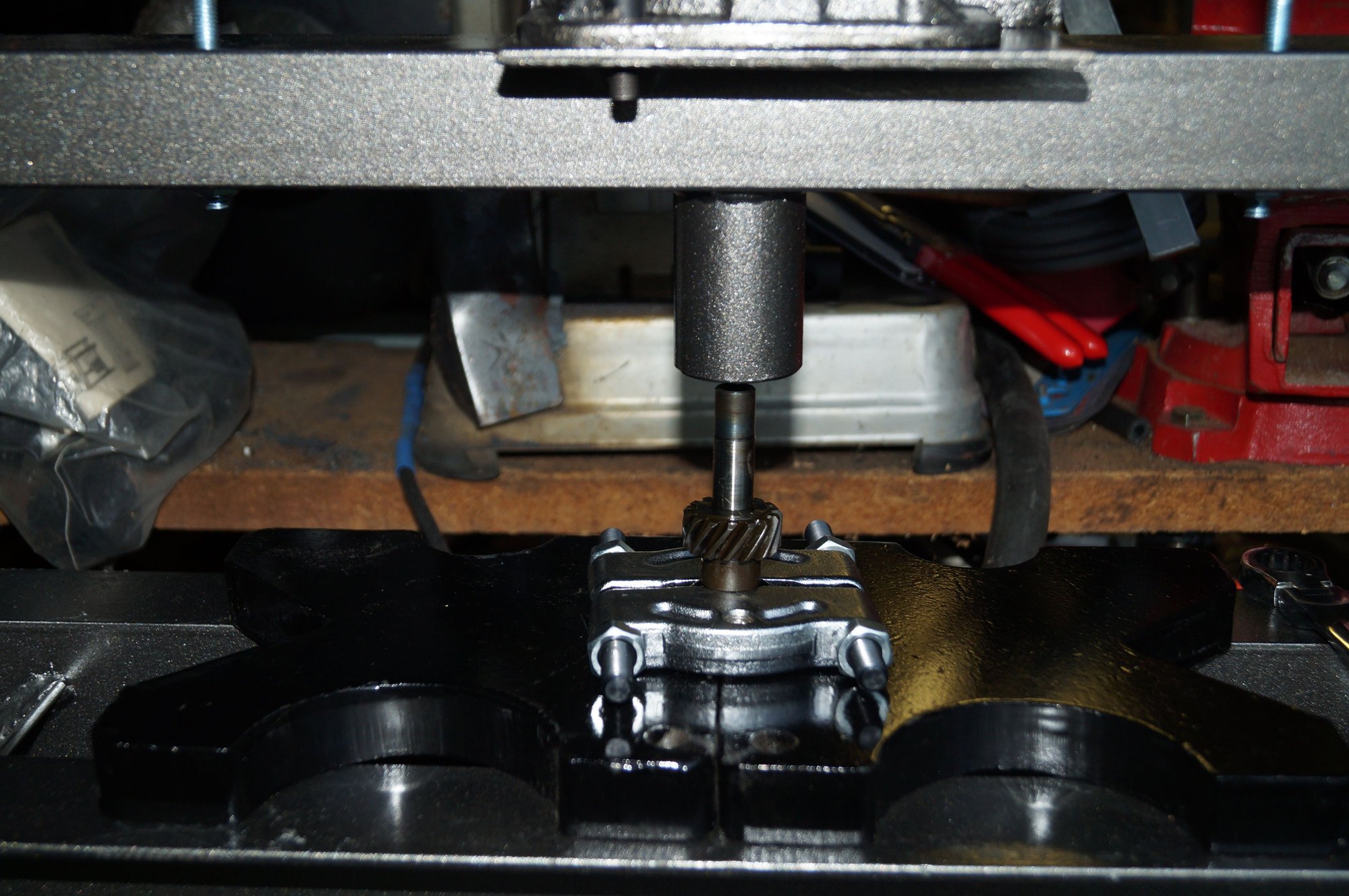

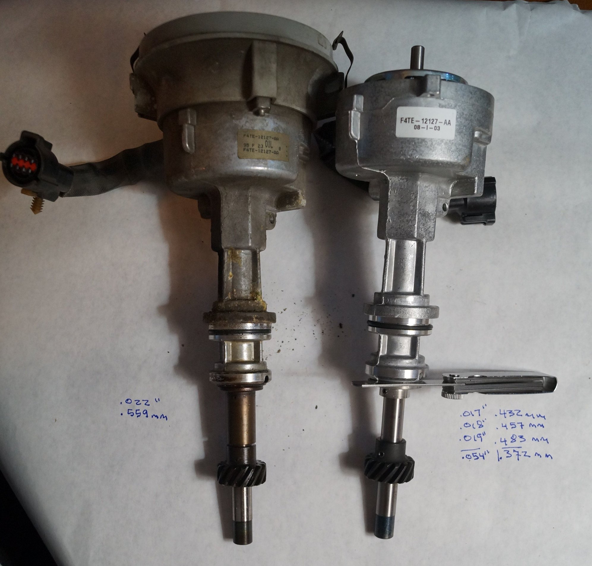

That was my plan too. But I ended up using the new distributor and having a machine shop pin my old gear in the old location on the new distributor. (The new distributor gear and the old distributor gear were both steel, but the new gear was a few thousands off were the old gear was on the shaft and since the truck had 160,000 miles on it with the gear in that location, I wanted the old gear to feel right at home with its cam gear mate on the distributor shaft in the same location.)
The new distributor will have less slop in it. And yes, the PIP Hall Effect Sensor in my distributor is what failed. I don't know when the last 5.8L was used in the E-Series or in the F-Series. It has been 23 years since the last Bronco was made with a 5.8L. So many distributors in the 5.8L are old and the PIP Hall Effect Sensor in them have failed or will likely soon fail.

Nick: Yes the gear on the stock oem distributor has the paint dab on it too. It is on the gear collar. None of my pictures show it on either the old or the new distributors. Go figure.
My paint dab was yellow. It is a 1995 5.8L Windsor in a Bronco. My guess is that your 1994 5.8L also has a steel distributor gear too. But the Ford TSB is published so that you will check for yourself and not trust parts sellers or mechanics or well meaning people like me. I do know that if you put a cast iron gear distributor in place of the stock steel gear distributor that you will ruin the cam in your engine.
I would have your mechanic pull your distributor and you and him look for the paint color together before you order anything.
But you may want to consider what I did, which avoids this problem. First, my distributor was not in spec. Second, the new old stock distributor which I bought was even more out of spec than my old distributor! (This may be why the nos distributor was never sold before I bought it?) Third, I decided that since my distributor gear and my cam gear had gotten along so well together for ~160,000 miles, that it would be a shame to introduce a new gear which would have to wear into the old cam gear. So, I had a trusted general engineering machine shop put my old distributor gear on the new old stock distributor with the same end play and other specs and in the same position as my old distributor.
Problem solved. At least to my mind. Or if my old distributor had a problem, I guess I just carried that problem forward to my new distributor. Anyway the vehicle has been driven 20K miles since and runs like new.
