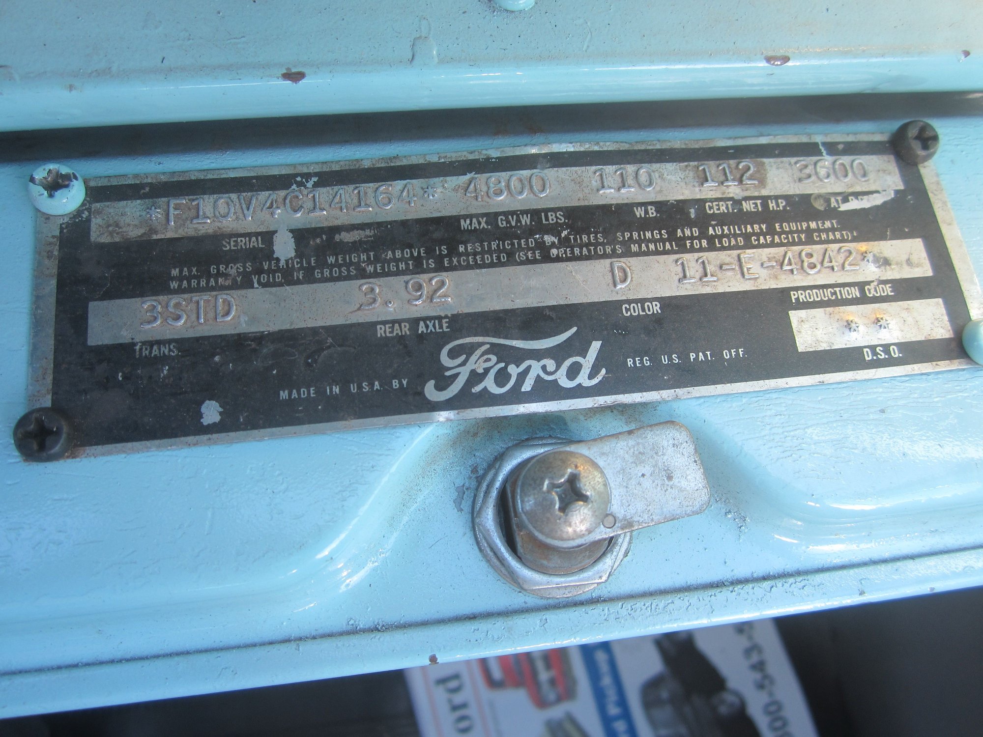

Dennis's 54 was built at the Chester, PA plant on May 11, 1954 with the serial number 14164 as seen above on his data plate.
My 54 which was built at the Chester, PA plant on August 19 has a serial number of 16490 as seen above on the bill of sale my grandfather got when he bought the truck. So my truck was built 2326 trucks after Dennis's truck so it had to be built on August 19, 1954, not 1953. So what's up? Error on the punch key operator?

Letters A thru M (skipping I) are the first year of production, letters P thru Z (skipping O) are the 2nd year of production.
A 1954 sold in December 1954 would be a left-over, because the 1955's were in showrooms in September 1954.
I am still struggling with this. So, for 54 models, if they started in August of 1953 Aug is H, Sept is J, Oct is K, Nov is L, Dec is M. Then 54 trucks produced in 1954, Jan is N, Feb is P, Mar is Q, April is R, May is S, Jun is T and July is U.
So there is no V and there should be no E, but there is as Dennis's data plates says E. And you said mine should be a V.... ????

So, Bill, so if you say my truck (19-H, August 19) was built in August 1953, how do you explain that my truck has a serial number that is 2326 higher than Dennis's (built in May, E) serial number?
And my grandfather bought it on December 22, 1954, as a left over, which was 17 months after it was built, if it was built as you said, in August 19. That is doubtful.

I did some figuring. May 11 1954 was a Tuesday, August 19 1954 was a Thursday. 73 days in between. Two holidays. That’s 32 3/4 trucks per day. Unless they had the whole week off for the 4th of July. Sound reasonable? Dennis

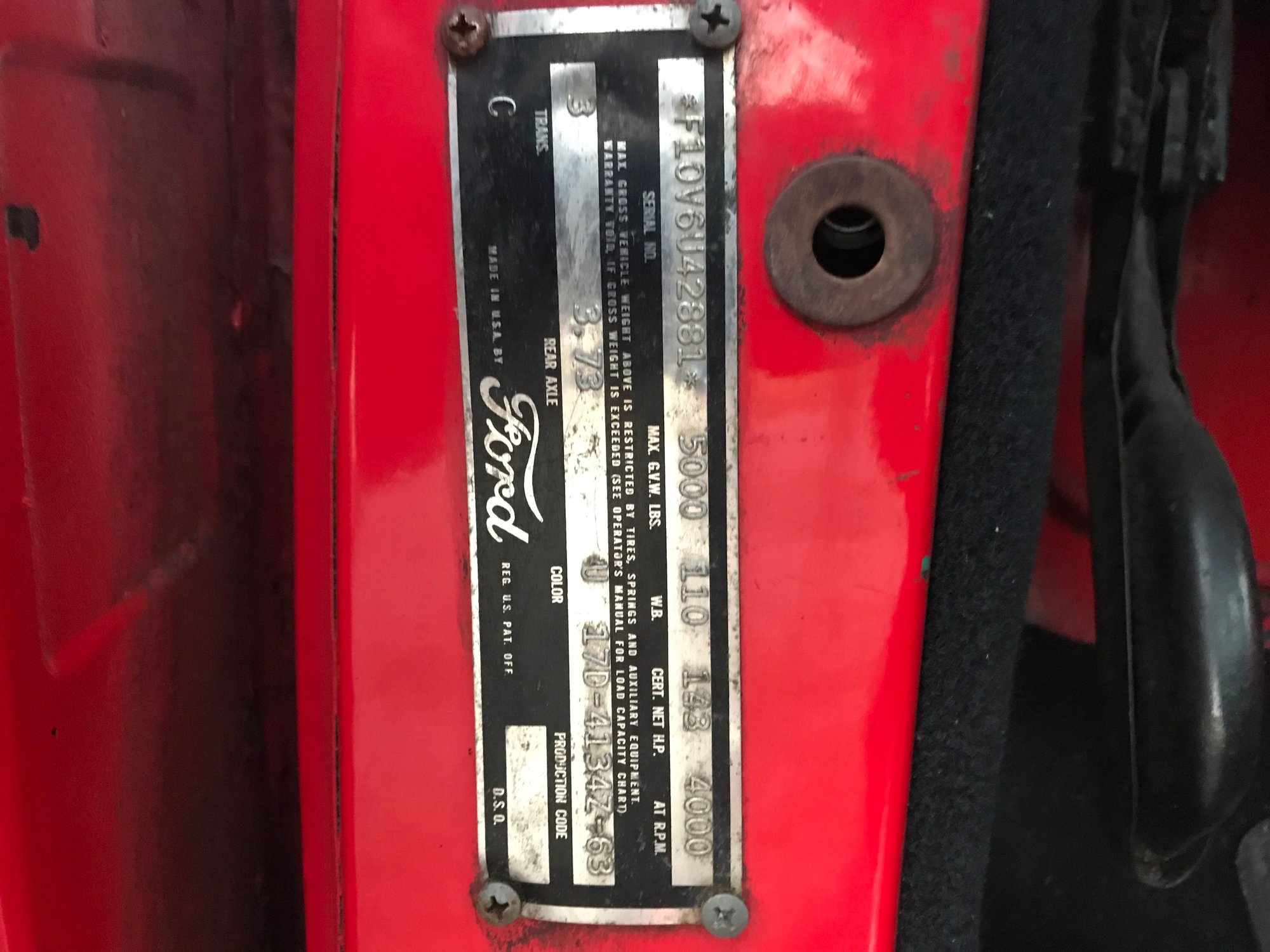

Ol Wise vin plate decoder, now I’m Curious to know about me 56.... can you take a read and tell me my past?
Thanks, Joe
