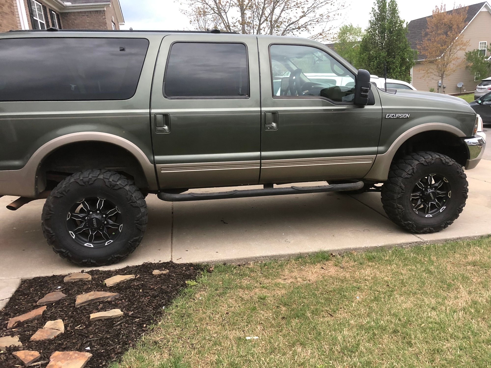

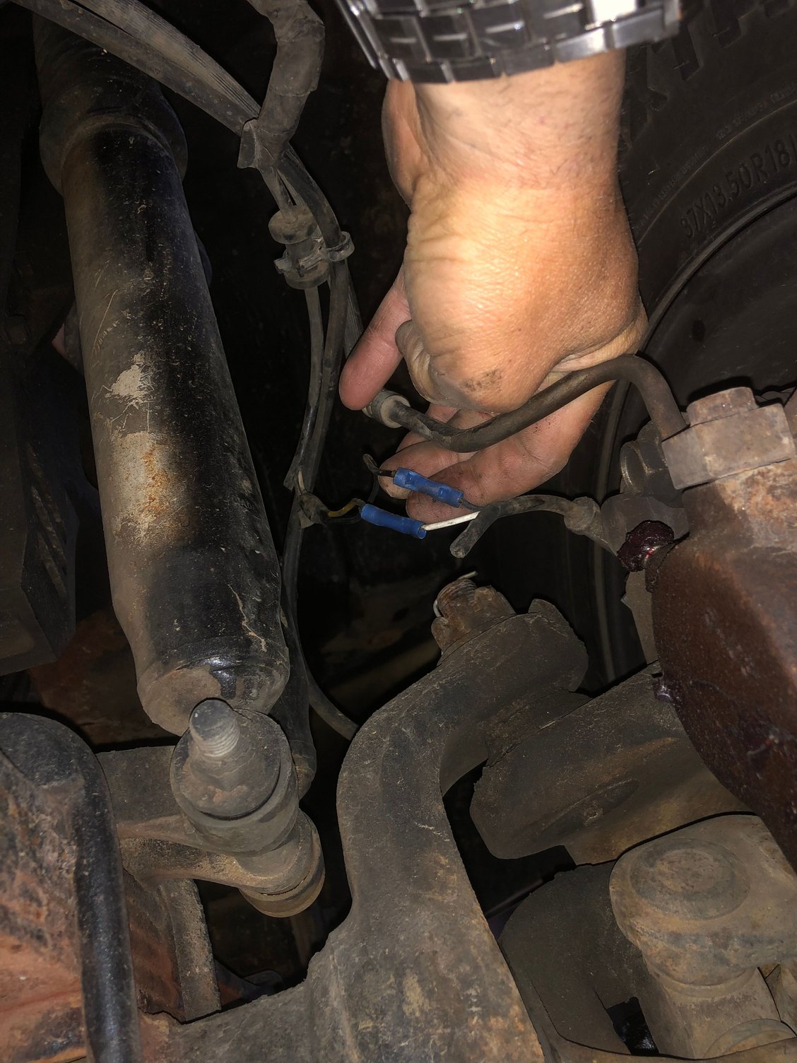

i apologize for the vacuum statement as as I had a 6.0 for years that had a similar problems and it traced back to that and and a single wire in the trans module In glove box. I also have a new born and 2 girls and all the time i try to reply involve screaming kids so that’s the second apology. It’s an electrical bypass on the hubs but can’t see where it leads to because I put everything back but will show picture. Nothing happens when I switch to low or high and tried the 5 mph switch and nothing. So I believe it’s electrical but that’s my Achilles heel. I’m attaching some pics but Just left outta town

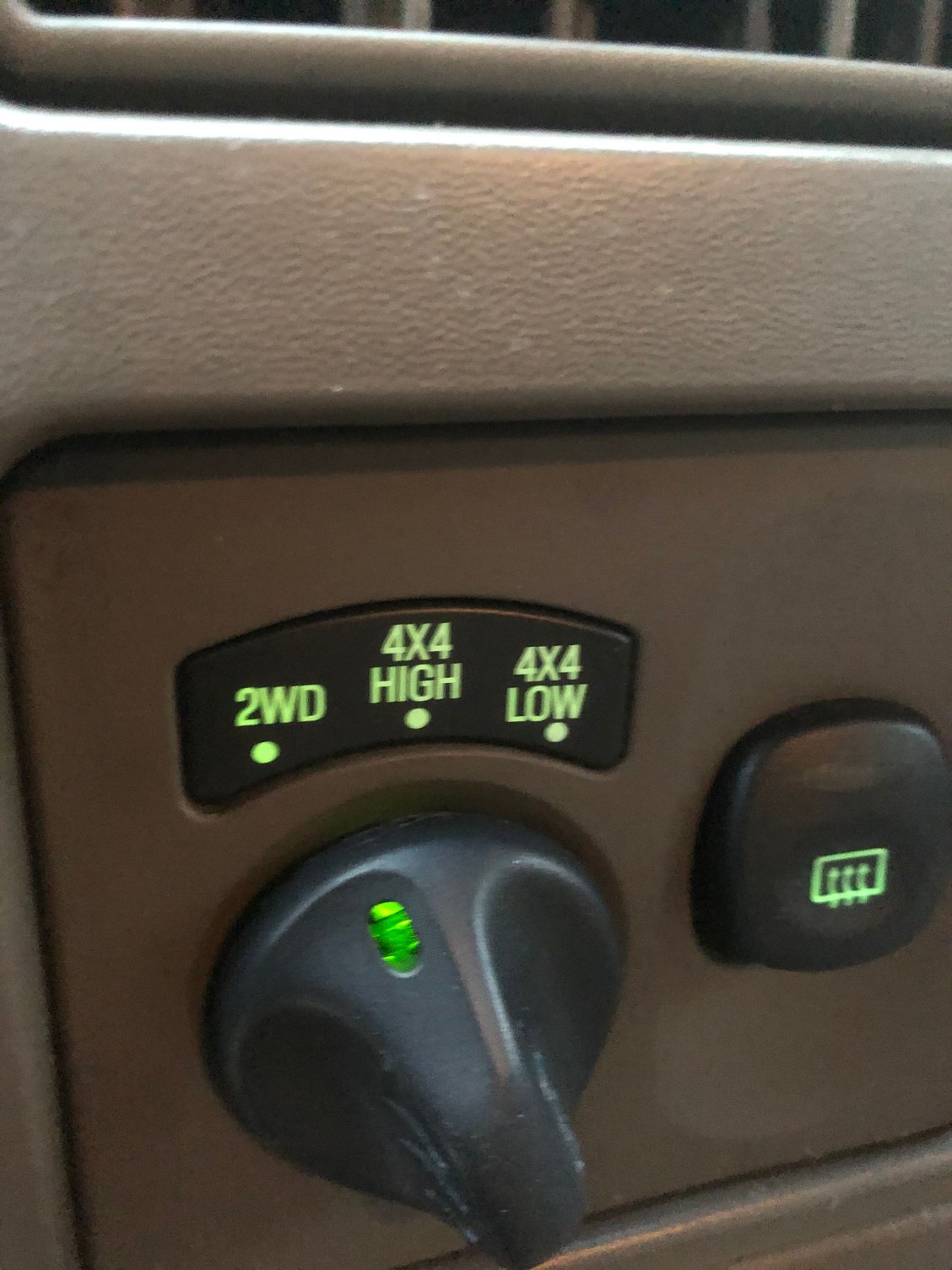

4wd lights up after I changed out actuator. But still nothing happens when it’s engaged.
Wiring to hub same on both sides so whoever wired it it was done sloppy
Wheels sorry no close up as this is the only pic I have

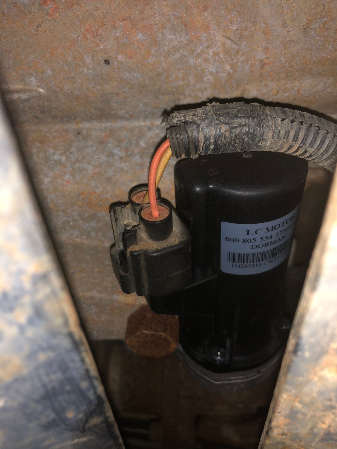

New T/C motor

Also when you switch or engage 4wd nothing clicks on the Trans Case, the only time it clicked is when I installed the new motor.

That custom wiring is for the ABS sensors, its crap but has nothing to do with your 4X4 issue.

Does the 4x4 light on the dash come on?
Old Apr 18, 2019 | 09:46 PM
Csmith4177's Avatar
Csmith4177
Joined: Apr 2019
Posts: 7
Well that is good to know on the ABS! The 4wd light comes on now that I replaced switch. But when you turn switch to low or high no click on motor
