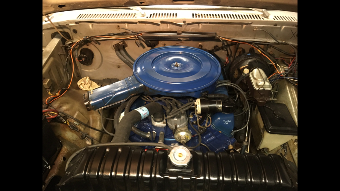

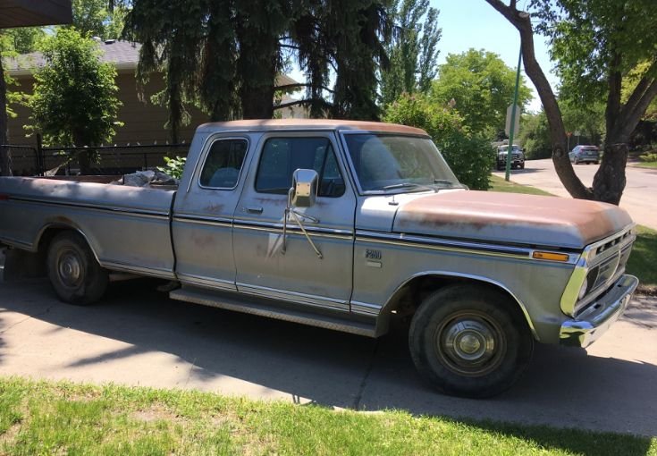

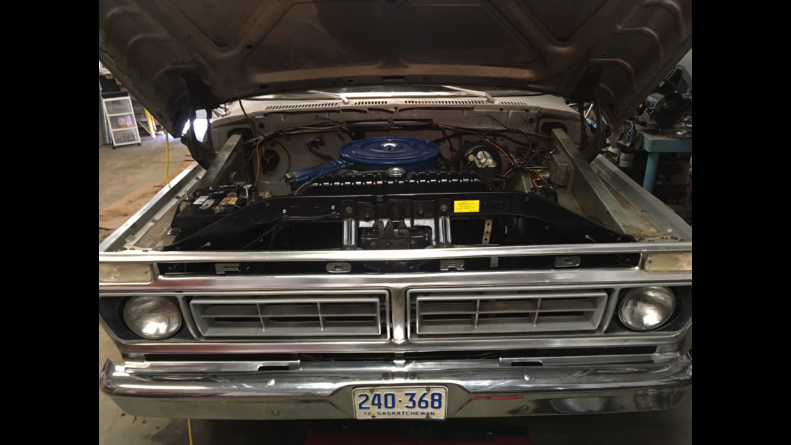

Currently my 76 camper special supercab is in great running shape. It’s a 460 c6 auto with good compression, Last winter I replaced the carb, water pump, all gaskets except head, rear main and oil pan, straight up timing set, and replaced anything rubber under the hood. Tuned and timed and it runs fantastic. I use it daily in summer to take my dog out to the beach and also use to occasionally pull my work trailer and to haul with.
