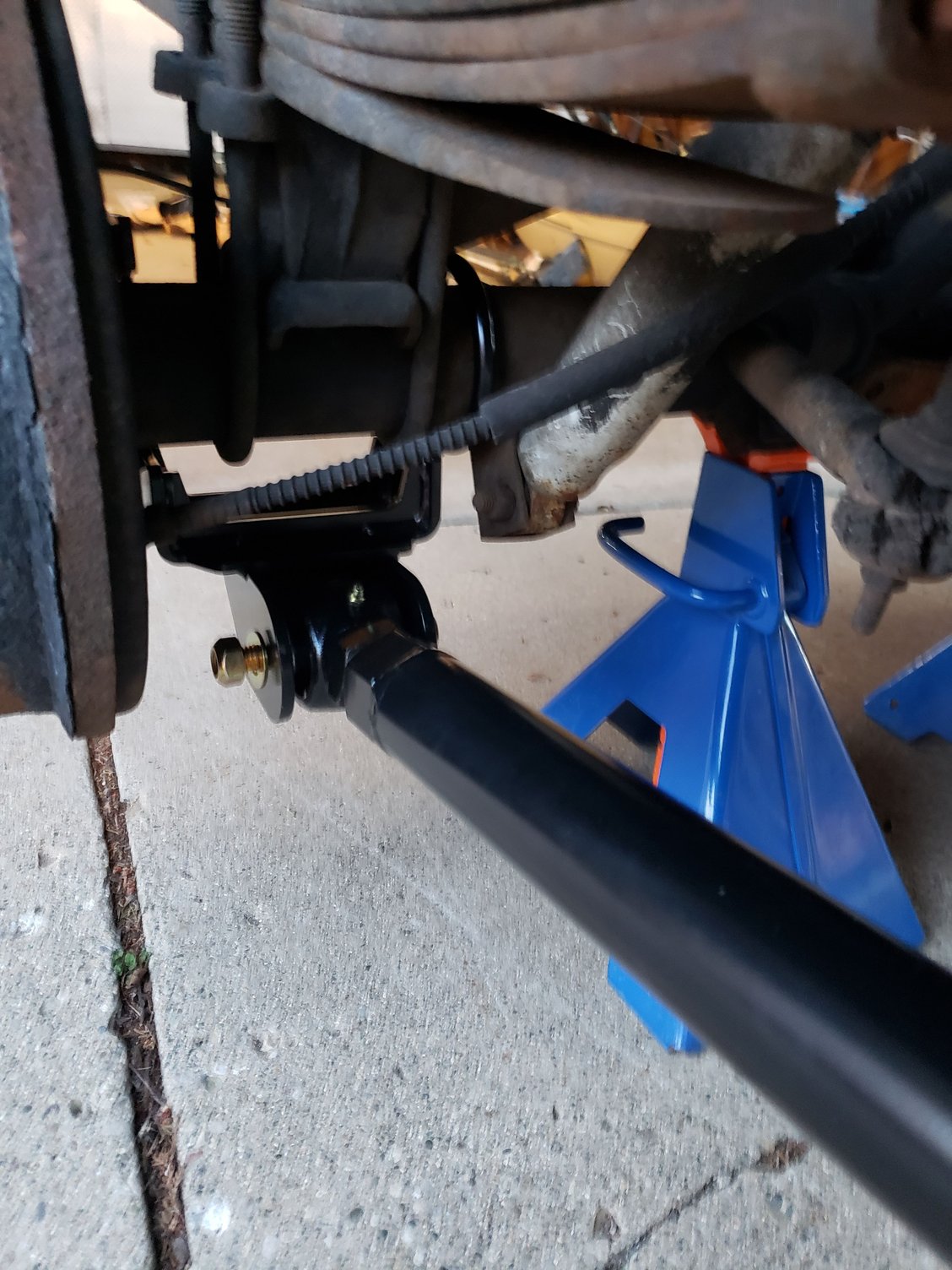

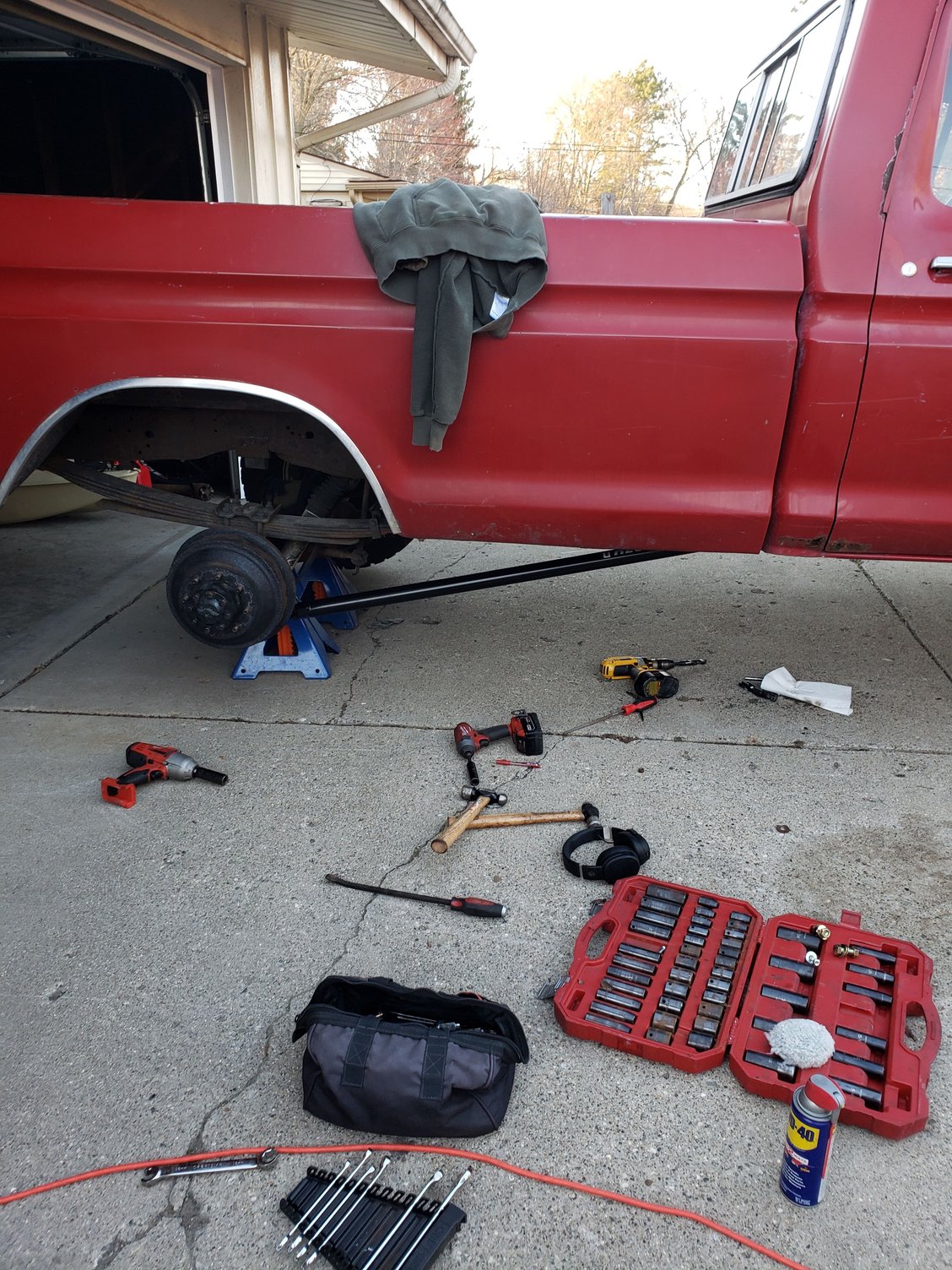

If anyone is looking for a bolt on kit for traction bars BDS makes a great kit. I unfortunately dont have a welder so i looked around until i found something that i thought would work. Well took a risk and seems to bolt right in.
BDS 123408 and 123409 is the kits you need. One is the bracket kit and the other is the bars themselves.
You will need to have a 3.5" axle tube for this kit which my Dana 60 has. It bolts right in after you drill a few holes in the frame.
Havent yet tested then to see how they perform but BDS makes good quality stuff so im expecting good results.
The only downside is the price. I feel like i was stolen from. However once again, good quality product, and a bolt in kit. You can deff make trac bars cheaper but these are good for someone without access to a welder or short in time.

Could you show a picture of how they hook to the axle & the front spring area?

Picture isnt great, but its a bracket that goes around the existing U-bolts and then has its own U-bolts to hold it onto the axle. The kit is designed for a 2015 or so superduty. I didnt install the brack in the correct orientation how it is designed. I may chang that later.
Yes i could have bought a welder for that price but im not the best welder and i dont have the needed voltage for one either and im the furthest thing from an electrician haha. I know there are other cheaper options available but like ive stated this is an easy bolt on kit that i know will ("should ") work and not deflect. These are beefy and beautiful, as they should be for the price haha.

Also yes i know the bolt is loose in the picture. It was taken mid install

What keeps the axle bracket from rotating on the axle?
Do you just tighten the he11 out of the U bolts and hope?
You said "shock"? Is there a rubber bumper on the rod I don't see in the pictures that helps soften the "shock"?
I have seen some bars like that used on cars cant remember if I have seen them on trucks?
