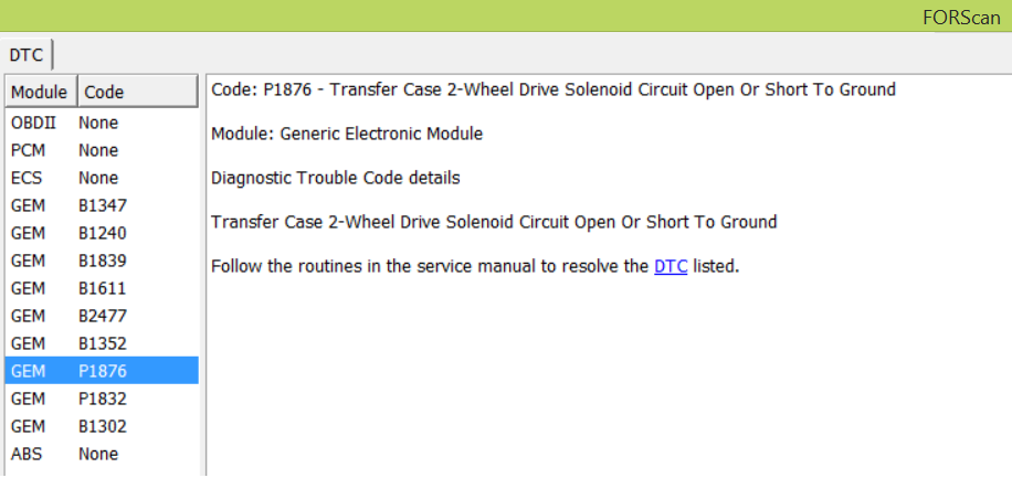

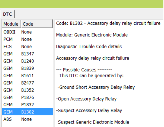

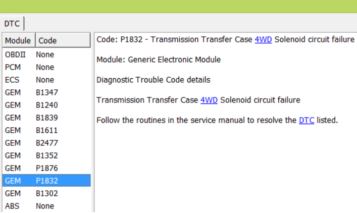

I decided to scan my truck to provide more information.
Don't mind the other DTC's from the GEM module. They are for rear defrost or heater elements I do not have in my truck (would be an issue if this was an excursion).

Decided to test my PVH solenoid that controls the hubs.
https://www.autozone.com/electrical-...52297_830050_0
Used the following..
1' piece of wire (qty 2)
aligator clip (2)
I hooked the alligator clip to the center post on the PVH solenoid and then took the other end and hooked it to the negative battery terminal.
I then used a piece of wire from the positive side of the battery and hooked it to the right side of the PVH solenoid using an alligator clip. I could hear the solenoid click
I moved the wire from the right terminal to the left terminal and could hear a click and pressure from the system drop.
Seems as though the solenoid itself works as I hear the click on either terminal. My guess is one side pressurizes the system and the other depressurizes it and the middle is the ground/common.
