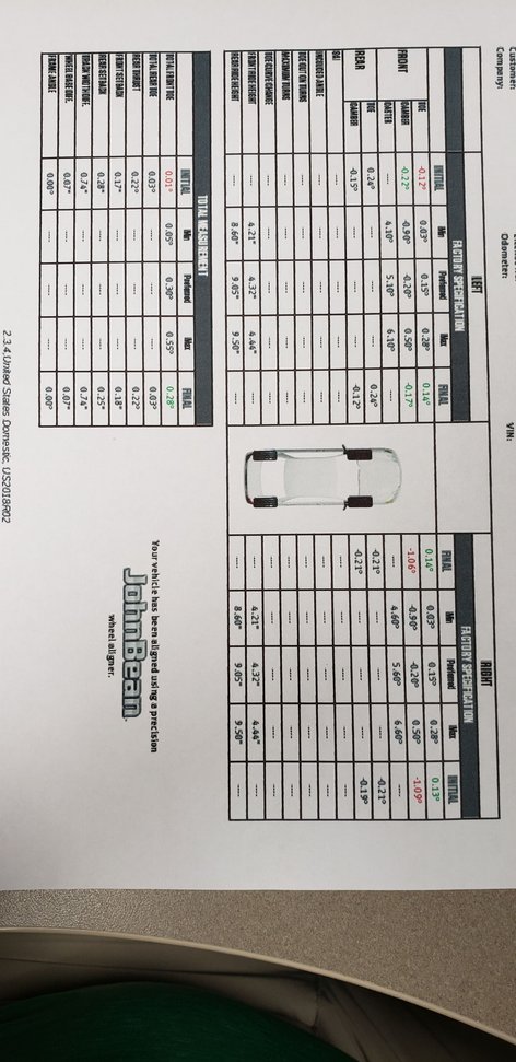

Update: Been busy with work and the little one but i managed to get a chance to take the X to get an alignment. I asked if i could walk out into the shop to take a look under the truck while they had it in the air which they had no problem with. Me and the tech pushed and pulled on the tires checking for any kind of play - everything was nice and tight as it should be. Afterwards, me and the tech were talking about the results of the alignment and it looks like whoever owned it before me must have installed an alignment bushing on the passenger side (don't know why) so we couldn't get that side's camber within spec....another thing to address lol I do not believe this has anything to do with my weak steering which is mostly what i'm focused on.
