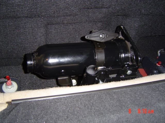

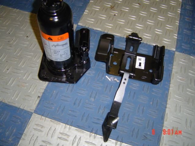

Got it installed ……
New jack and bracket ...
Installed ....

RONMCHUGH, I like the idea but am having trouble following what you did, did you get a 4-ton or 6-ton hydraulic jack for your setup? Would you be kind enough to post the part numbers for for the hydraulic jack and tool kit that you purchased? Looks good in the picture are you happy with the combination of jack and bracket and how it fits?

Originally Posted by RONMCHUGH
Got it installed ……
Installed ....
Awesome idea .... I wish I had invented that
Thanks
It is a 6 ton jack for the newer trucks , I also have a 6 ton jack for the older trucks that is 2 stage and a larger diameter . Here is where I got the jack : https://www.ebay.com/itm/Ford-Super-...53.m1438.l2649 . The part no. for the bracket is : HC3Z17B014H . Be aware that the tools that come with the screw jack will not have a part that works on the hyd. jack . I used that part from the other 6 ton set up I already had .
