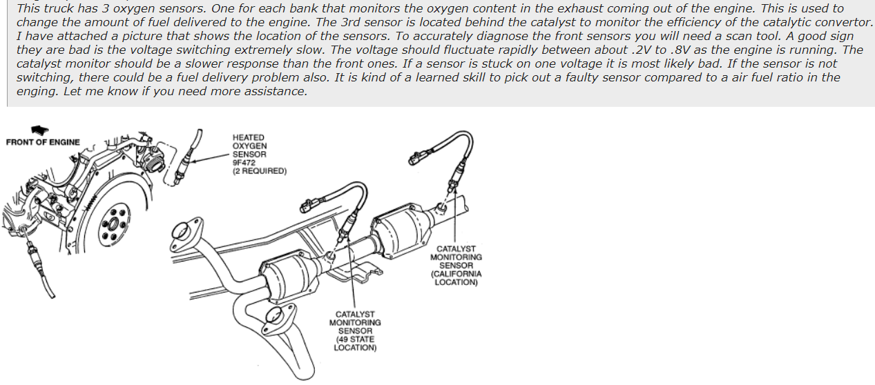

haynes says OBDII -thats your left and right o2 sensor telling you engine lean, how many miles on truck? any mods done when you did tune-up (e.g. sixliter tune-up) what is base timing set at? what was/is fuel pressure on both tanks? Did you check for exhaust leak both sides? Check that both sensor are tight in bungs(not worked loose)? It would be doubtful that both went out at same time (see pic below posted by 96blackford) to check them before just buying 2.

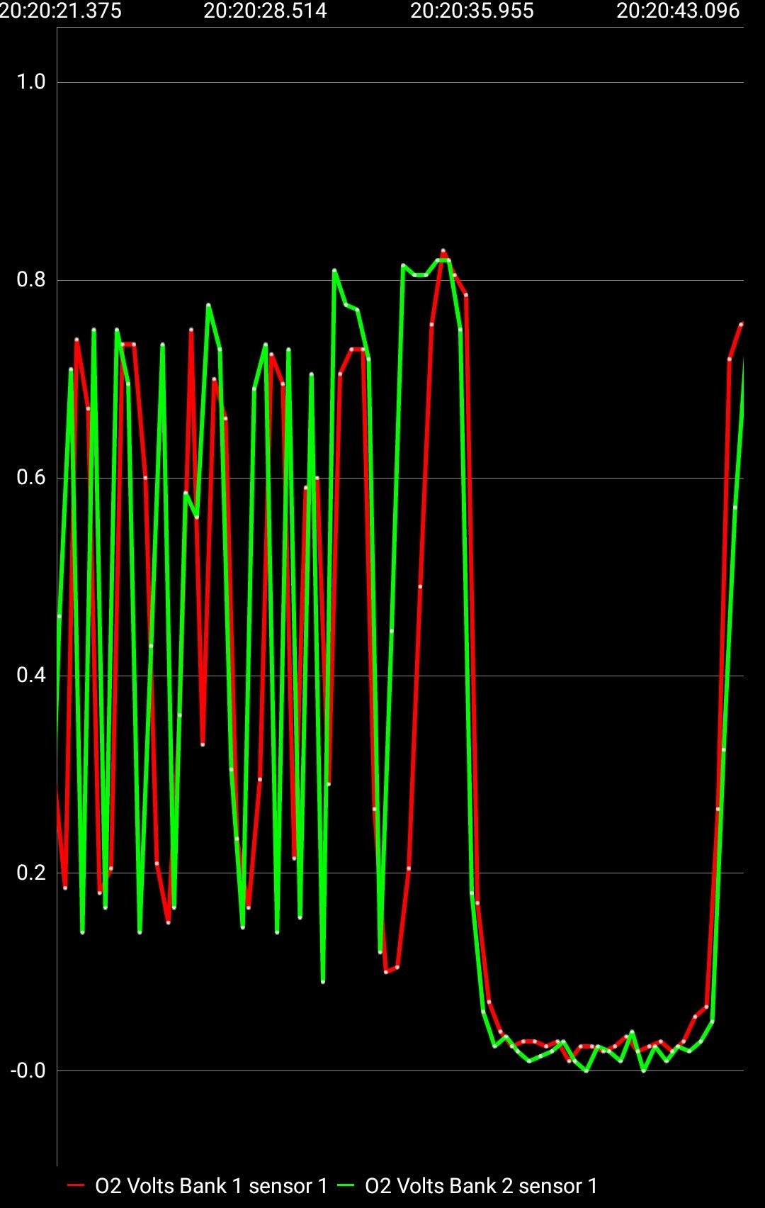

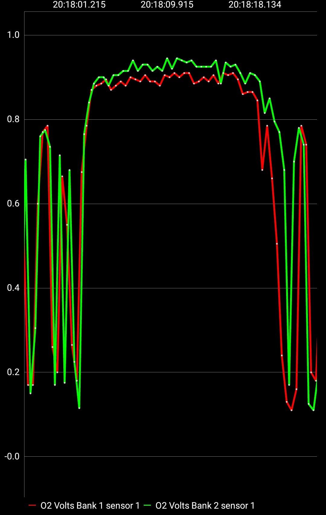

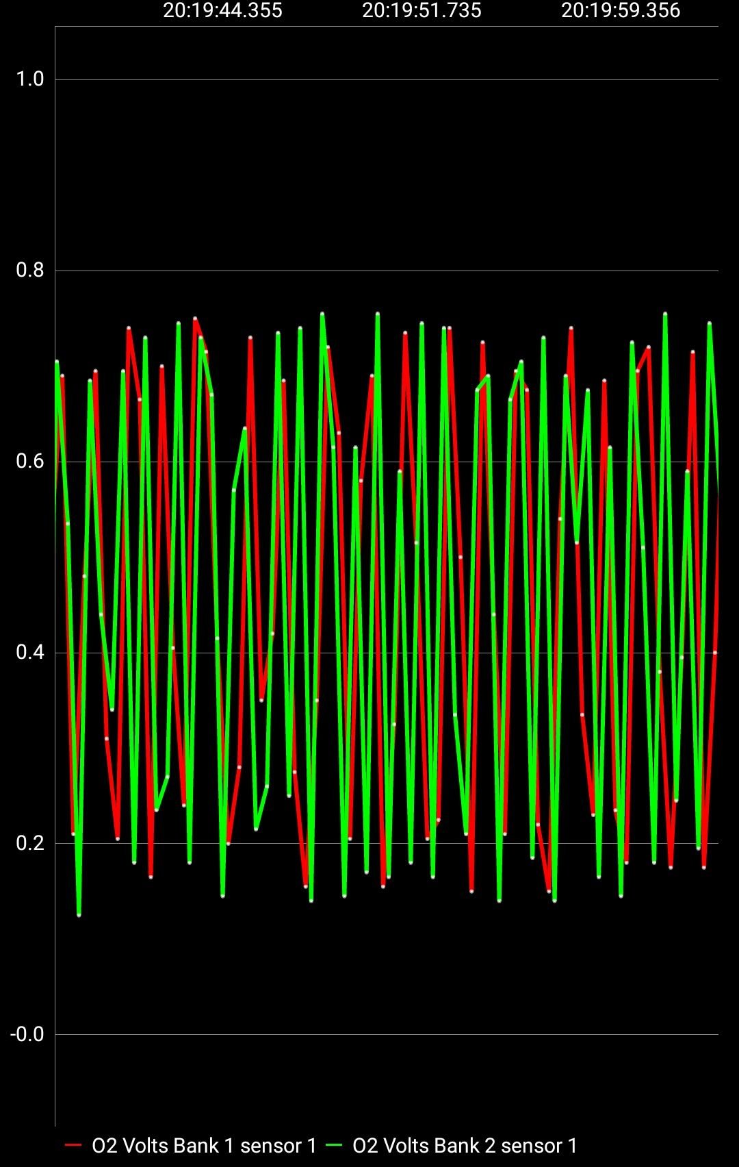

Can you graph the oxygen sensor voltages? In torque, I am able to plot this over time, along with other parameters like percent engine load. Do your voltages peg high voltage under load?
Drop is deceleration.
Normal closed loop rich/lean switching.
high load. Note Bank 2 was a touch richer than Bank 1.
If I remember right I was comparing switching speed of an old (bank 1) and new (bank 2) sensor in the above. Anyway, that's the kind of behavior you should see.
