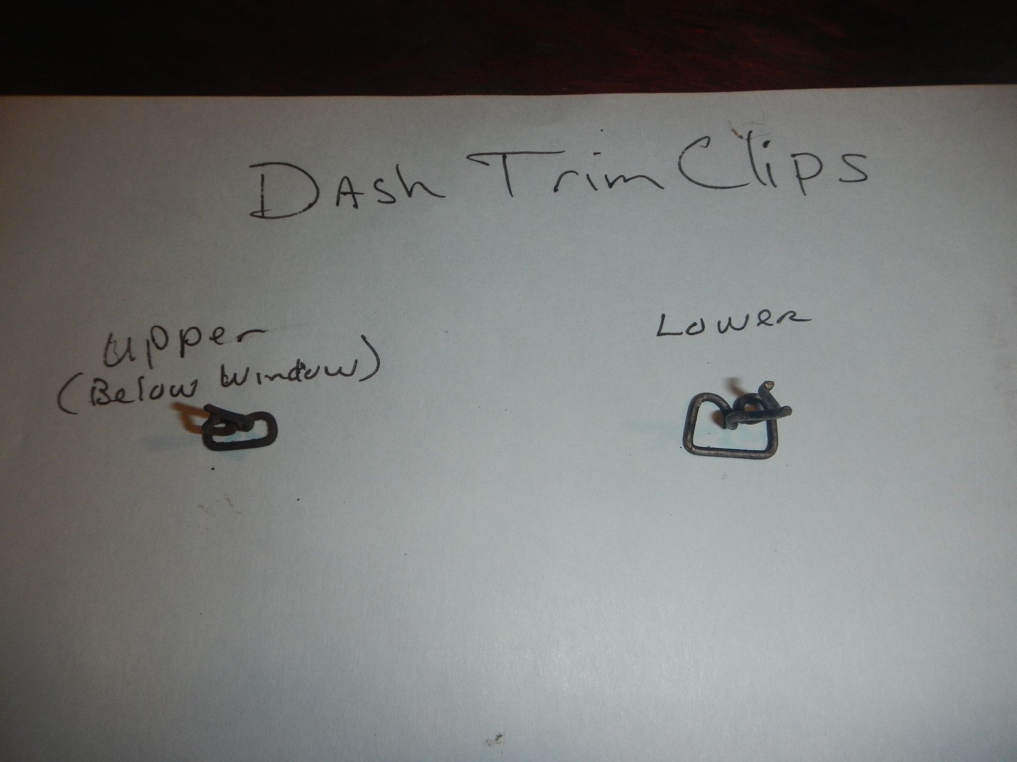

I'm looking to find a source for the dash trim clips

The upper moulding clips are the same as the moulding clips at the center of the dash.
C0AB-6404439-F .. Instrument Panel Moulding Retainer (clip) / Obsolete
1960 Ford/Edsel Passenger Cars / 1961/66 F100/1100 Custom Cabs & 1965/66 F100/250 Rangers / 1963/69 N/NT500/1100 Custom Cabs / 1967/69 F800/1000 Custom Cabs.
No Ford dealer or obsolete parts vendor has any. Similar 'scissor' type clips are available from Fastenal & Auveco.
See 04439 in pic:

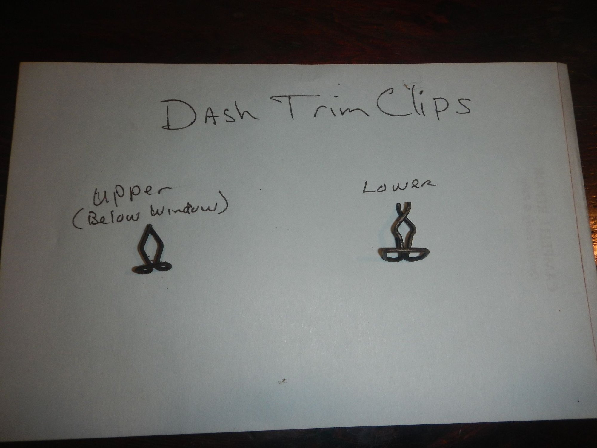

Bill you say same but they are 2 different sizes.

Basic part number is 04439 .. Here's a pic from the text section, how many part numbers do you see?
btw: I found 6 of them because I forget to type the O/0 2nd digit of the prefix jazz on rearcounter.
COAB-6404439-F = MCDONALD OBSOLETE PARTS in Rockport IN has 6 = 812-359-4965.
