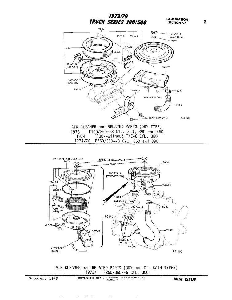

That what I was dreding the most if I went the header route getting the old manifolds off I do think I have a leaked some were dose exhaust come though the stove pipe becouse the pipe connecting it to the aircleaner is gone or dose it just pipe the heat from the manifold to the aircleaner I can weld it shut if exhaust come through there if not I'm guessing one of my manifold gaskets are leaking as they dont appear to be cracked anywhere

If you suspect a crack look for some black exhaust soot buildup, that is a tell tell sign. Most I have seen are a vertical crack right in the middle of the manifold all the way thru. The air cleaner pipe is just connected to the R/H manifold heat shield/cover. Example 9A603 with that cover installed, a crack is hard to see.
