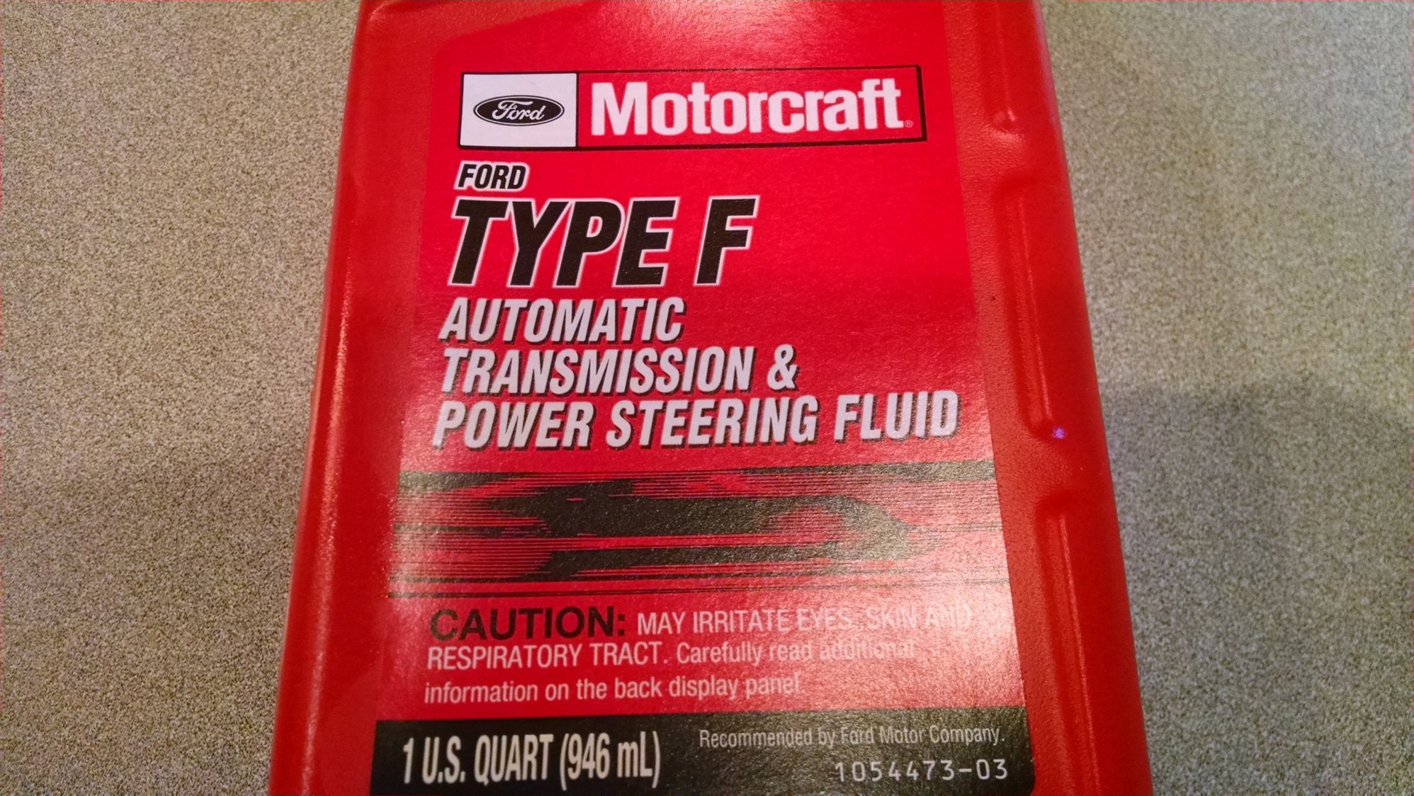

This helped mine some. Some folks have put Saginaw pumps in with minor modification. Some Ford Econolines used them. Junk Yard stuff. You can search for the mod.
I feel like I’m missing something. What helped yours some? The Ford brand type F fluid over other brands?
I have a Saginaw pump on my Bronco (351W) and I procured another for my pickup whenever the OEM Ford pump dies. Look for a 302 or 351 powered Econoline van. I got the whole pump and bracket assembly for ease of assembly. That way I don’t even need to R & R the pump pulley to swap it out.
Yes the Ford fluid helped some. Next time I go to the JY I am going to look for a Saginaw. Sandy
