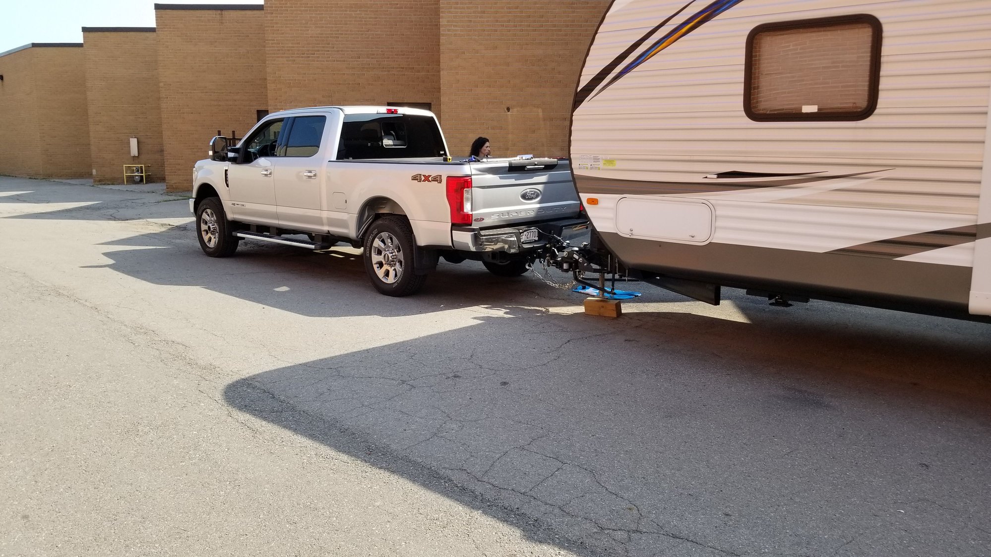

I know you stated that the trailer and hitch is setup correctly. I have to ask though. Did the dealer set it up or did you by following equalizer instructions which are spot on.
Originally Posted by R&T Babich
First impression is your tongue weight is too low.
I think these guys are onto something, and the best way to figure that out is to take it to the local CAT scales and take 3 (or more) weights while you set it up again from scratch. If it doesn't pull right, it isn't set up right, so start with the assumption that it ISN'T correct right now.
sidewinds are awful, but without wind it shouldn't feel "twitchy" or unsettled. And that combination should be able to handle moderate sidewinds without much drama.

Yep, I followed the instructions to a “t” and have also experienced the incorrect set-up from a “worldly” RV dealer.
Last year I felt the motion of the trailer was too much and tightened up the bars by one hole on the L brackets. This dropped the nose another 1/8” like I wanted but seemed to cause at least as much unwanted motion on the road.
Some of you guys were right on; I dropped the L brackets TWO holes and had a much more comfortable experience. The nose of the truck is a tad higher than I’d like but apparently that’s part of the deal.
Thanks to to you all!

Another thing. Equalizer states the torque for the bar sockets is 65lbs as a starting point. You could always go a little more. I was leaving on a trip when it was very windy. I think mine are at 90 or 100 at the moment.

Definitely check bolts for toque. I have to tighten all the time. That would be the first thing I check

I know this sounds weird but try turning off the sway control in your towing menu. I have the blue ox sway pro system and found the trailer feels more stable with it off.
I called blue ox once and they even recommended it themselves stating that sometimes the sway bars interfere with the trucks auto correct causing a wiggly feeling on the highway.

The truck’s sway control is not an active feature rolling down the road - it does nothing to stop sway in the steady state. If it senses sway outside of normal travel limits, it selectively applies the brakes to slow the vehicle and return to stable travel. It doesn’t steer the truck (by steering wheel). You can kind of think of it like ABS. Yes, the system is “on” the whole time, but it only activates if you are braking so hard that your tires depart normal travel and start sliding. Thus, disabling trailer sway control (incorrectly understanding how it works) will do nothing to the steady state ride, and reduces the chances of recovering from a severe departure from stability.

A few days ago I pulled my camper a 38 ft bumper pull jayco. I use the 14k equalizer on my 2017 F250 cclb4x4. I was in a 20-30mph diagonal cross wind. Truck was solid except for the occasional big wiggle when a big gust hit me. Semis and big trucks had little to no effect on me. Just thought I would throw my experience out there.

When you say "distributed properly" what are the actual numbers - total trailer weight & tongue weight?
We pull a 2009 TH, the axles are further back for when the there are "toys" loaded (we don't have any toys).
The tongue weight was 1450 lbs when we got it, although the sticker inside the trailer says 1007 lbs.
The sticker probably did not take into account the upgraded double propane tanks and 2 6v batteries the original owner ordered..
I've been moving things around to get the tongue weight down to 1350 lbs for now and am shooting for 1300 lbs.
I have to get the trailer weighed again since moving things around and installing a new roof and mattresses.
The trailer tows rock solid, no hint of sway, even when the hitch was not quite set up right when we got it.
If your tongue weight is toward the lower end of the range that could be your issue - 8k trailer: 10-15% = 800-1200 lbs.
