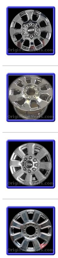

A little overwhellmed with offset/backspacing understanding. I live in Hawaii so trying to get these through Amazon Prime shippinhg. Not many places on the island that are willing to help. So we also have to have fender flares here if our tires stick out which I would like to not have. can someone just tell me if these will stick out on my 2017 f250?

Those look like 165mm bolt pattern. These trucks need 170mm.

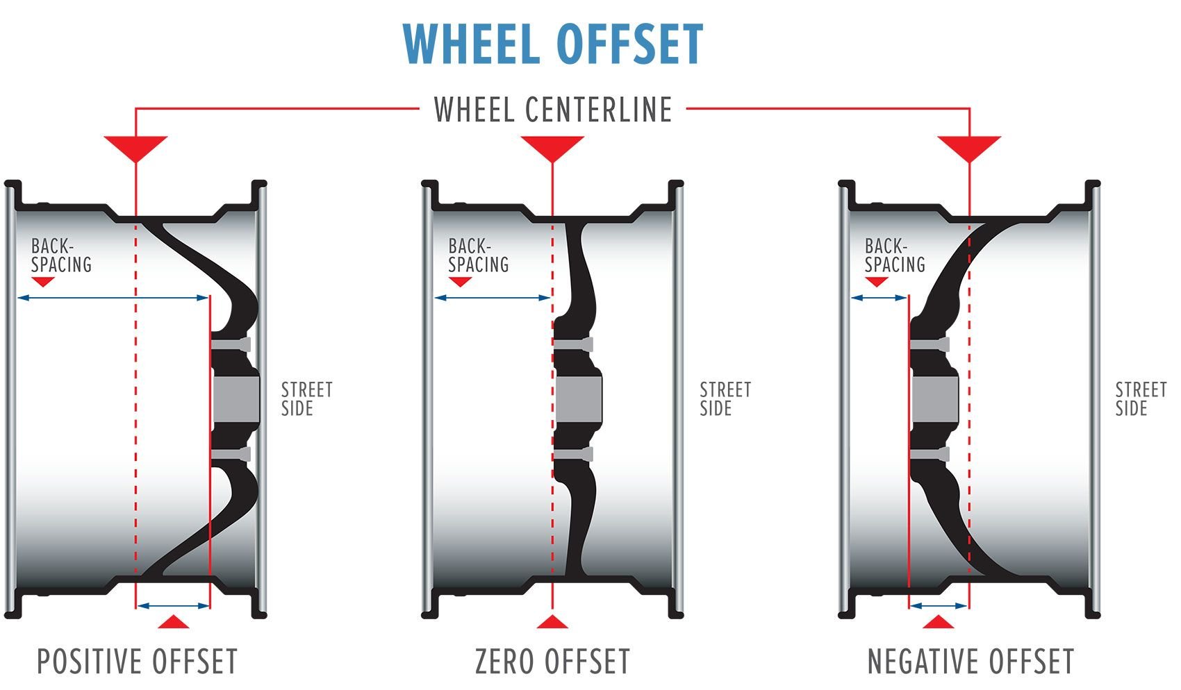

A bit of misinformation here. the stock setup is PLUS 40 offset, not negative. higher positive offset moves the wheel inward towards the engine. higher negative moves the wheel outward. check out this graphic:

The factory offset is +40mm, and lug pattern is 8x170mm. I recommend running a +20/18mm offset 18x9 wheel. The more postive the offset the more it keeps it under the fender. The negative offset pushes the wheel out away from the axle hub, therefore out from under the fender. I have run after market 17" alloys on my 2017, and I was never comfortable with the minimal clearance to the calipers. I prefer the 18" wheel myself and if you wrap a 275 or 285 series tire on there you will be sitting as good as you can as far as keeping the tire under the fender.

Sorry, yes...+40. I had them reversed. 3 years ago when I was wheel shopping I had this all committed to memory, it is gone now. LOL
Crap...Thats what I get for trusting an automated fitment! Glad I didn't order!
