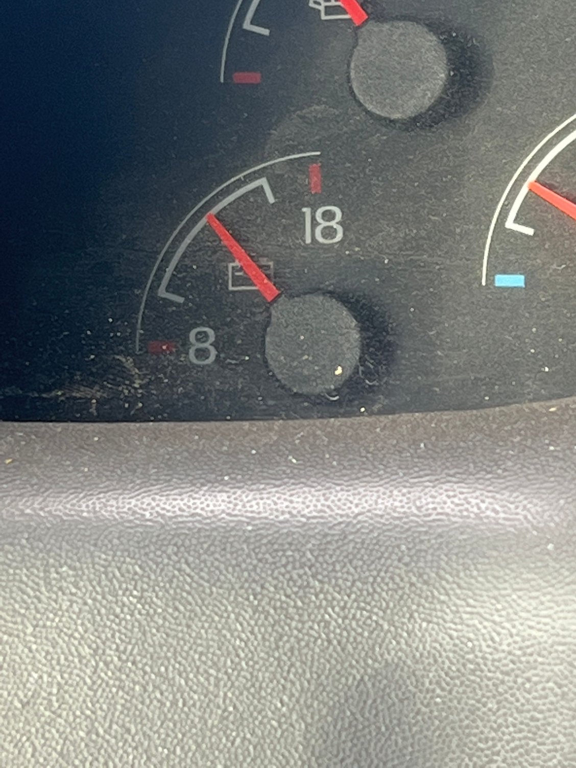

I disconnected pig tail on top alternator now about a hr, still showing same voltage on gauge

So drove truck 4 hrs and voltage is low again, enough to set off warning light, so I’m guess the bottom alternator is shot, plugged in wires and top started to work again and gauge is back to norm.

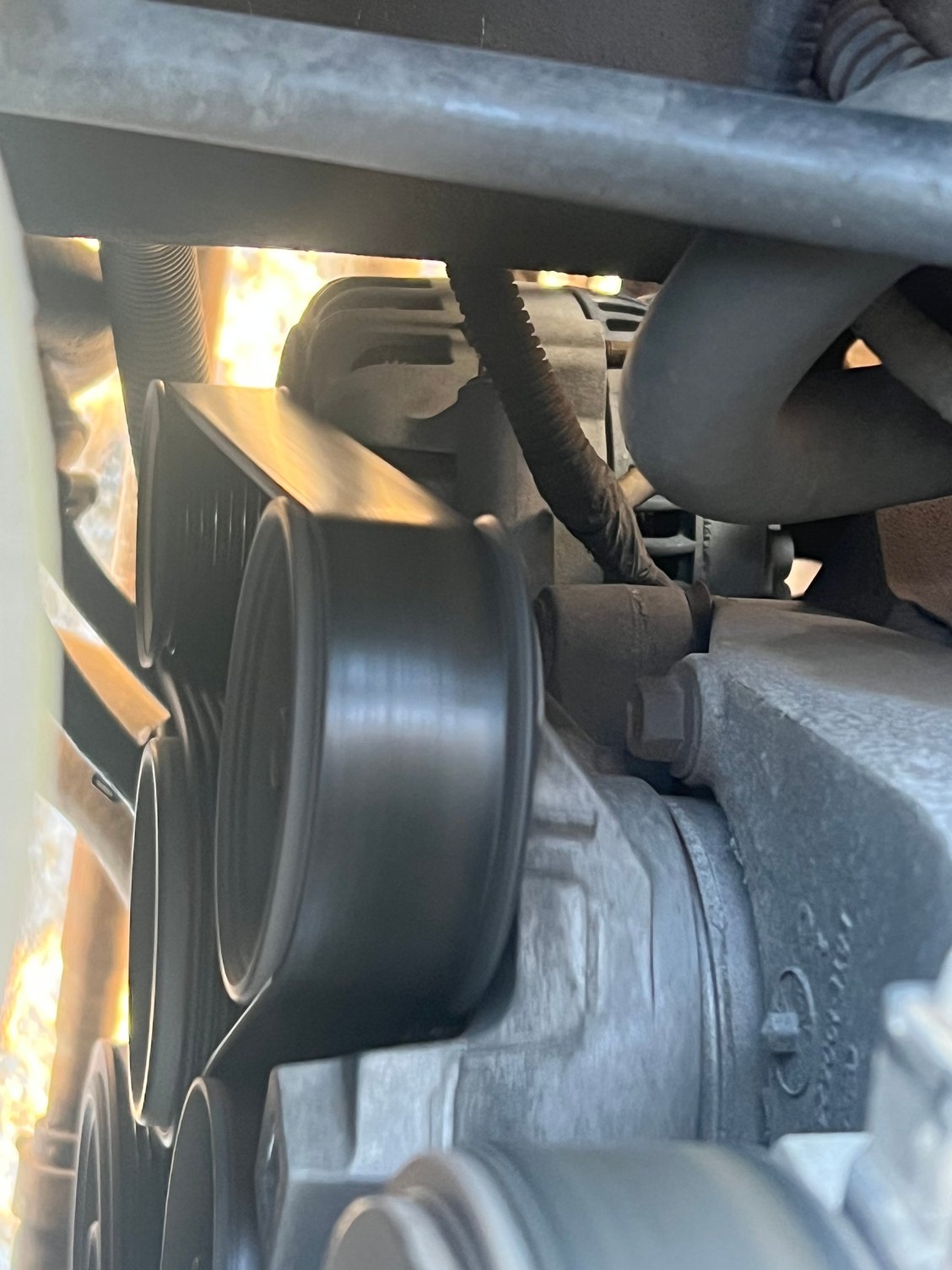

so what is the bottom alternator we need for this, and where can I get one from? Best price
Bottom alternator

Cheapest option would be to rebuild your lower alternator yourself. That's what I did, using a kit from rebuilderinabox.com. About $60.
Another option is to purchase a new alternator from Rockauto. Buy the ACDelco 3351155 upper position alternator for $127, and re-clock it to fit the lower position. Real simple to do by removing three screws and rotating the front and back case halves until they line up correctly. Remove the slightly larger drive pulley from your old lower alternator and install it on the new one.
For a straight bolt-on replacement, I've listed two additional options, also from Rockauto. They should be clocked correctly and have the correct pulley already, for about $40 more.
