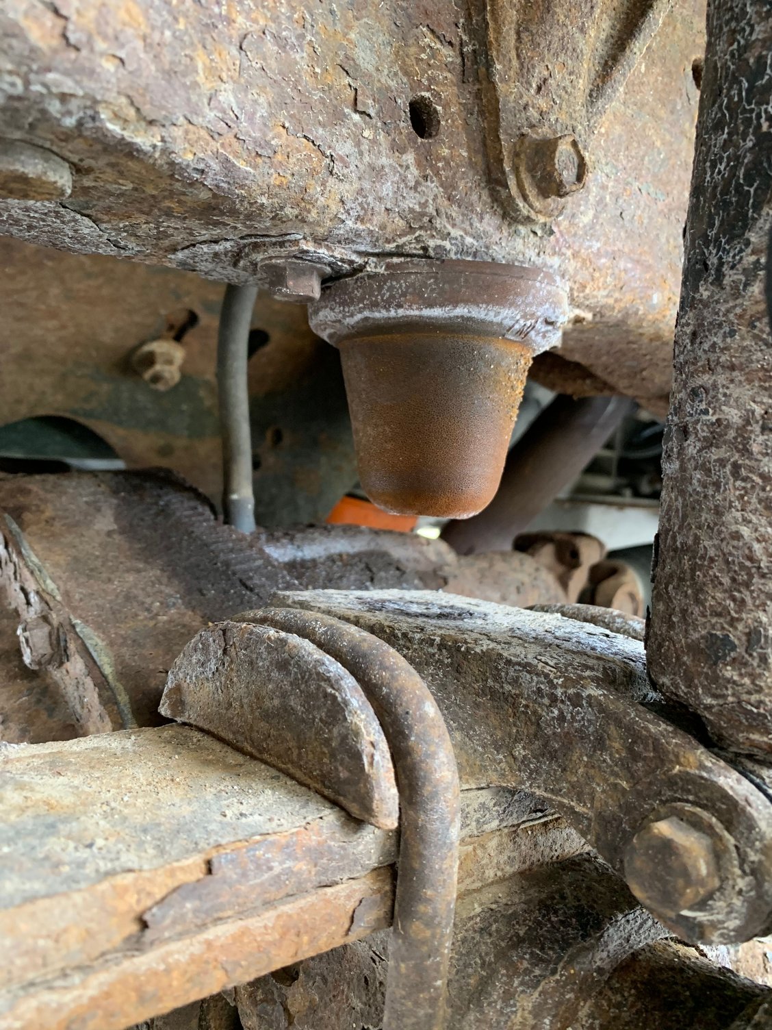

Its an 05 6.8l and the bump stops are in great shape and I don’t really ever experience bottoming out. Here’s a picture of them if that helps.

Evidence of it bottoming out is right in front of you in that pic. Doubt you just want to add a leveling kit from those pics.
