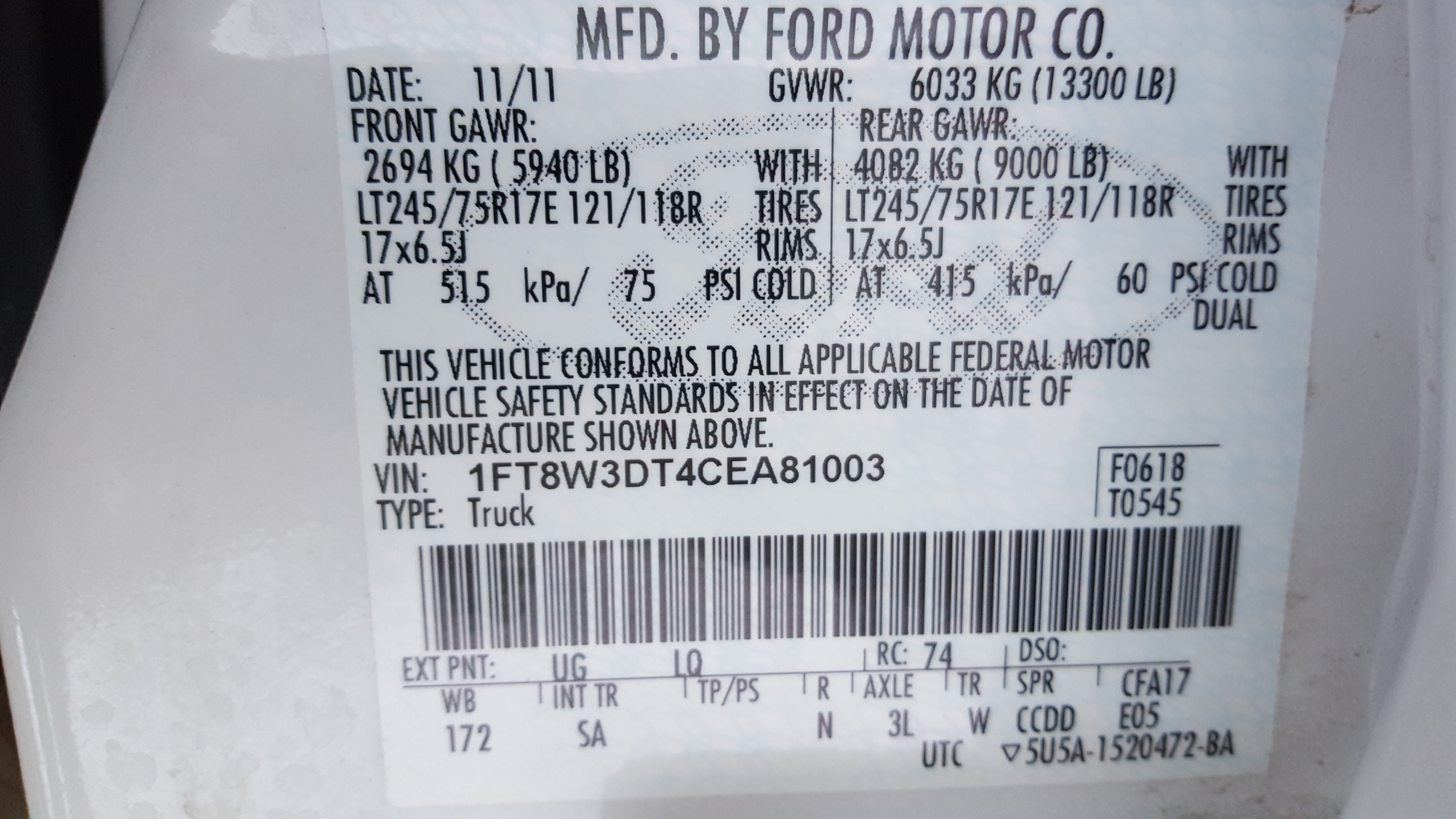

Door jamb sticker!

Originally Posted by Tim Young
Door jamb sticker!
Attachment 263605
Tim, there should be another sticker as well. THAT is the one that tells you what the load capacity is on *YOUR* truck.
Here is the one in my new truck
Note that it is for *THIS* truck only. Each truck should have its own sticker.

I took a photo of the other sticker today, as Don had mentioned! By looking at that I would have been overloaded with the big camper anyway!

Wow. Yeah. That's for sure.
