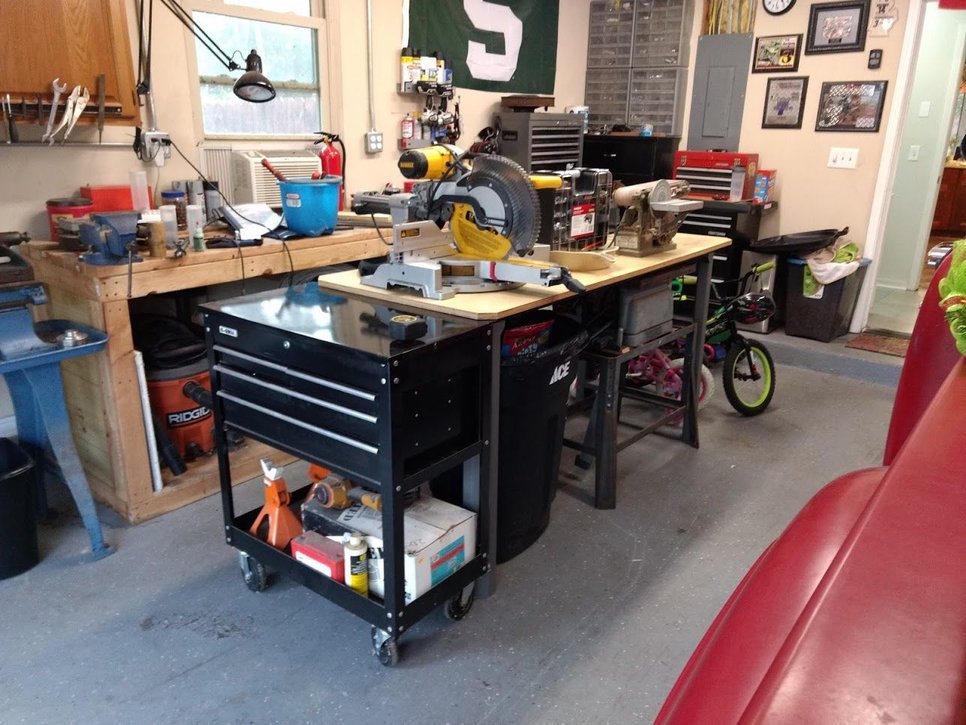

My garage is a standard attached two car about 24'x24' in size with a wooden garage door and I've added some fiberglass batt insulation above the ceiling. I use a window mounted AC unit to take the edge off the Florida summer. We moved about three years ago and I had a leftover window shaker that I had used in my master bedroom at the previous house. It was on the small side at 5000btu but it worked well enough to drop the humidity and cool the space. It did take a couple hours to notice a difference but I could supplement it by opening the house door for a bit. I recently traded it to a co-worker for a 13,000 btu unit that barely fits in my window opening and should improve things a lot. I have an old furnace fan that sits on the floor to help move air around also. No real complaints on cooling but I could use more space.
Four year old for scale.
