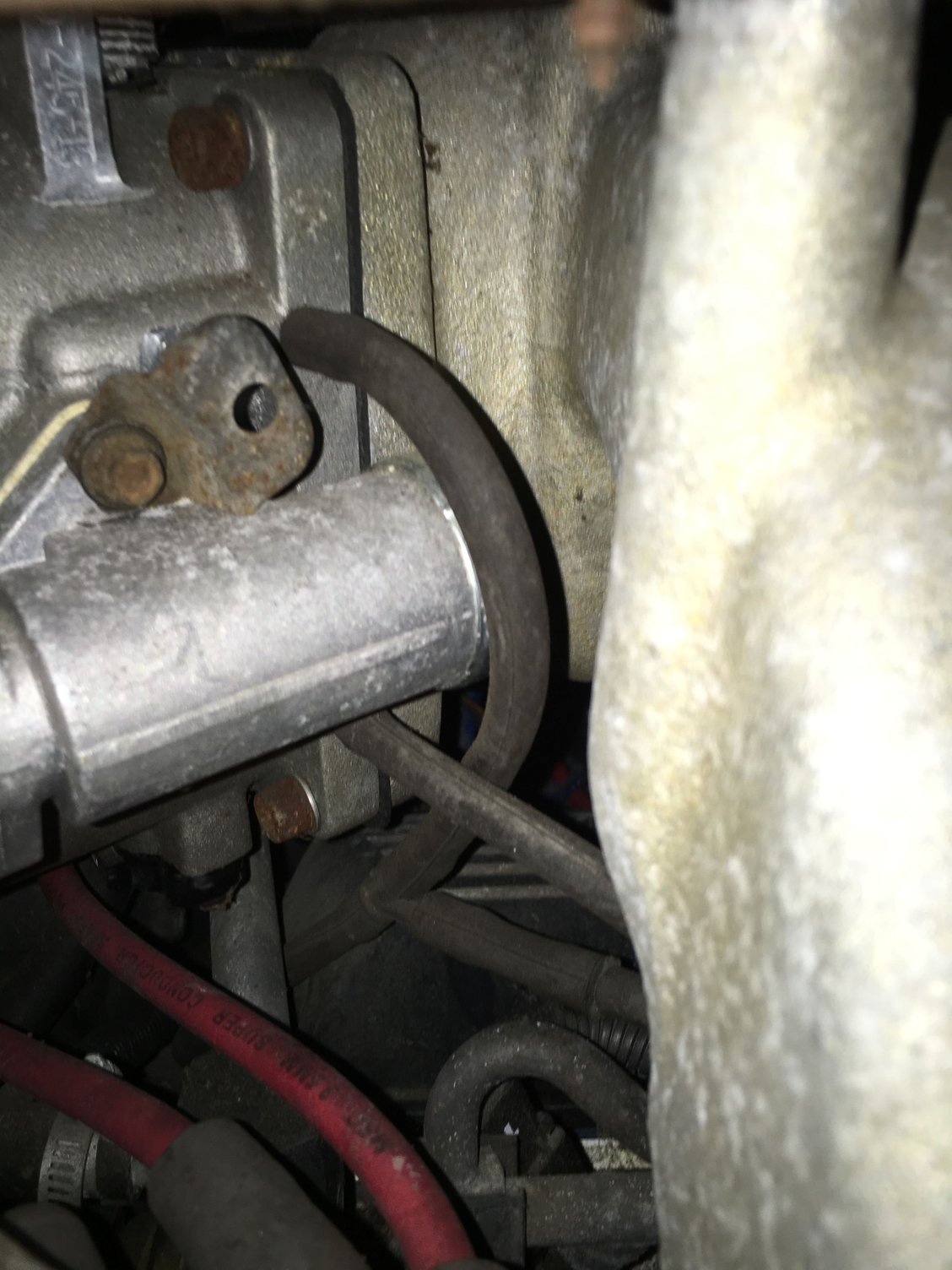

On older models, the vapor canister is connected to the driver’s side as pictured below.
Vacuum connection on my ‘87
You cannot leave an open vacuum port. My hardware kit came with three vacuum caps.

I capped it, there was no change in how it ran. The truck only will backfire for the first couple minutes after a hot start. I also checked my timing. It was at 20BTC, factory is 10 I believe, I lowered it to about 15BTC but iradic Idle is still present. I noticed that my timing light seemed to skip a flash about when the RPM would drop, I'm not sure if my timing light has an issue, or possibly the truck is misfiring although it does not sound that way. I would like to note that the distributor cap and rotor was replaced a year ago, along with the ignition coil, spark plugs and spark plug wires so I believe a misfire is unlikely.
