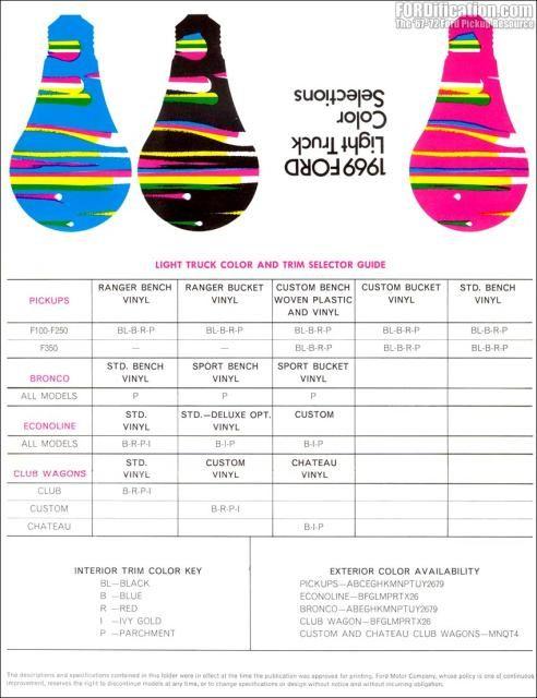

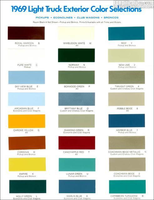

Ive just bought a 68 long bed Ranger, I believe the body colour is Poppy Red (code says otherwise) however the steering wheel and column is an off white colour. Would anyone know the name or paint code for the steering wheel as I have a replacement wheel that I would like to colour match.

First off, Welcome to the Forum! Here is some color info for 1969. I don't know if it was the same in 68.

The "off white" is Wimbledon White, COLOR code M on the Warranty Plate. This color was introduced in 1964, used into the 1980's, but Ford dropped the Wimbledon name after 1972.
Note: 1960/63 trucks also had a M COLOR code, but this was for Corinthian White which was a bright white.
1964/71 Passenger Cars also came in Wimbledon White using the same Warranty Plate M COLOR code. There was probably a gazillion 1965/66 Mustangs painted this color.
The basic Ford part number for Wimbledon White is 1619. It remained the same after the Wimbledon name was cancelled.
Edit: You can see this color, both the M & 1619 in the chart in post #2.
