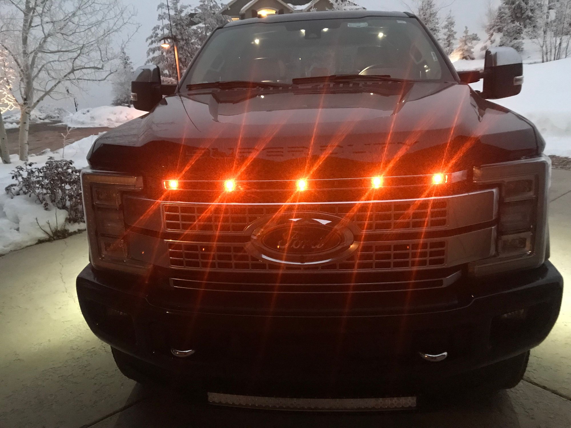

went with 5 on my Platinum, spent about $40 and about an hour wiring them up, no drilling required.

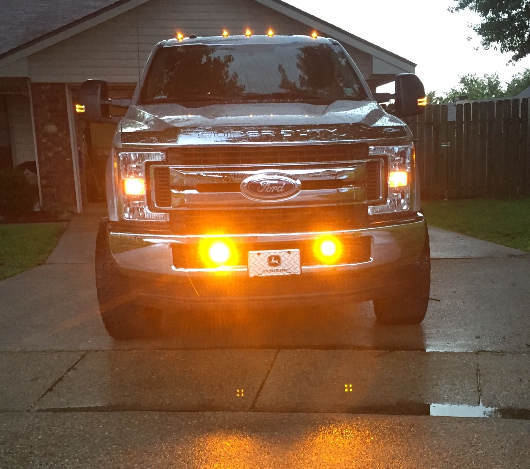

I bought these in amber off of amazon. I removed the upper inboard tow hook bolts, and used the supplied hardware to mount them in their place. They are oriented where adjustment is left/right. They are wired hot, and switched in the cab on a 15amp fuse. My truck is not equipped with upfitter switches.

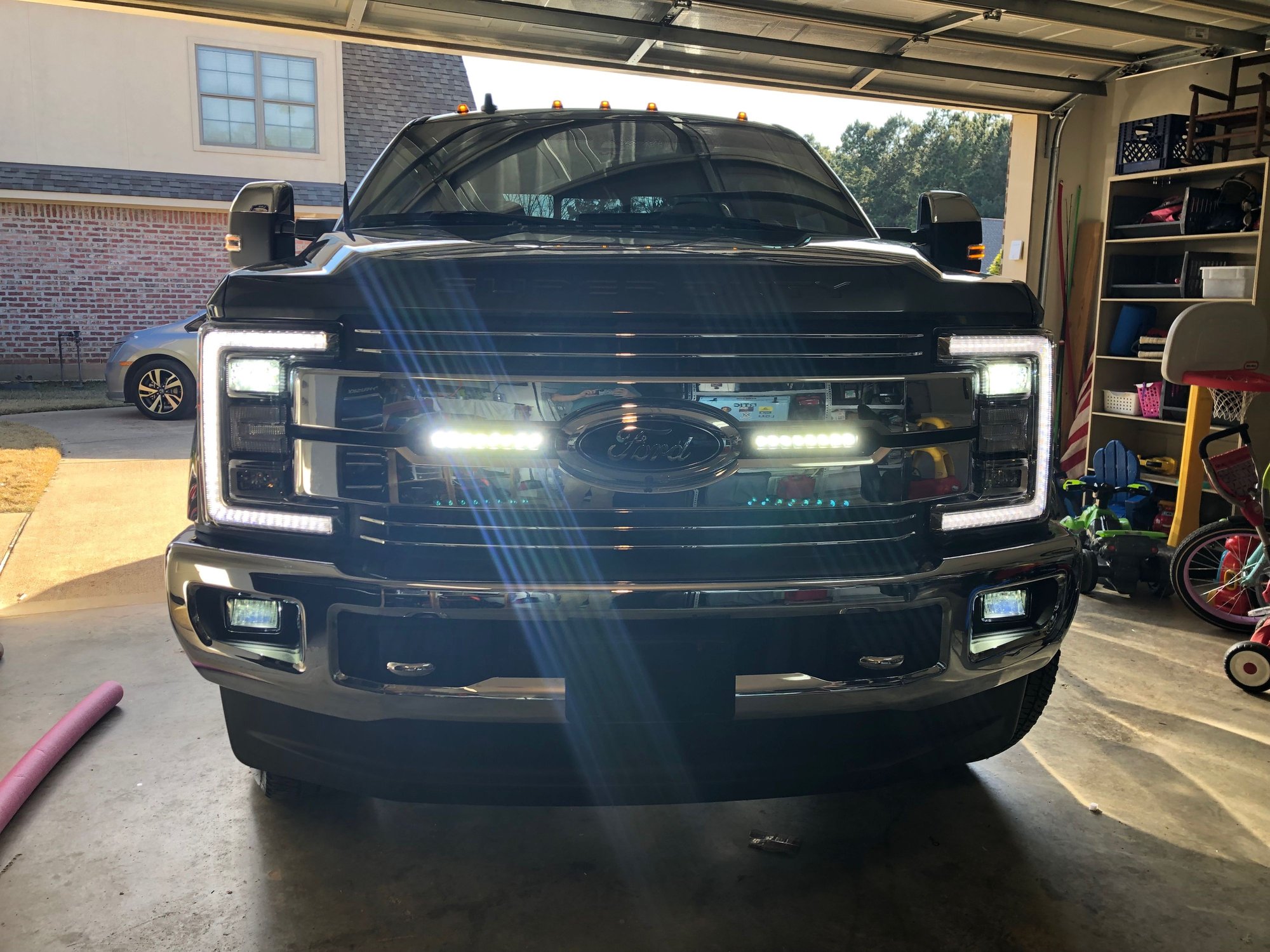

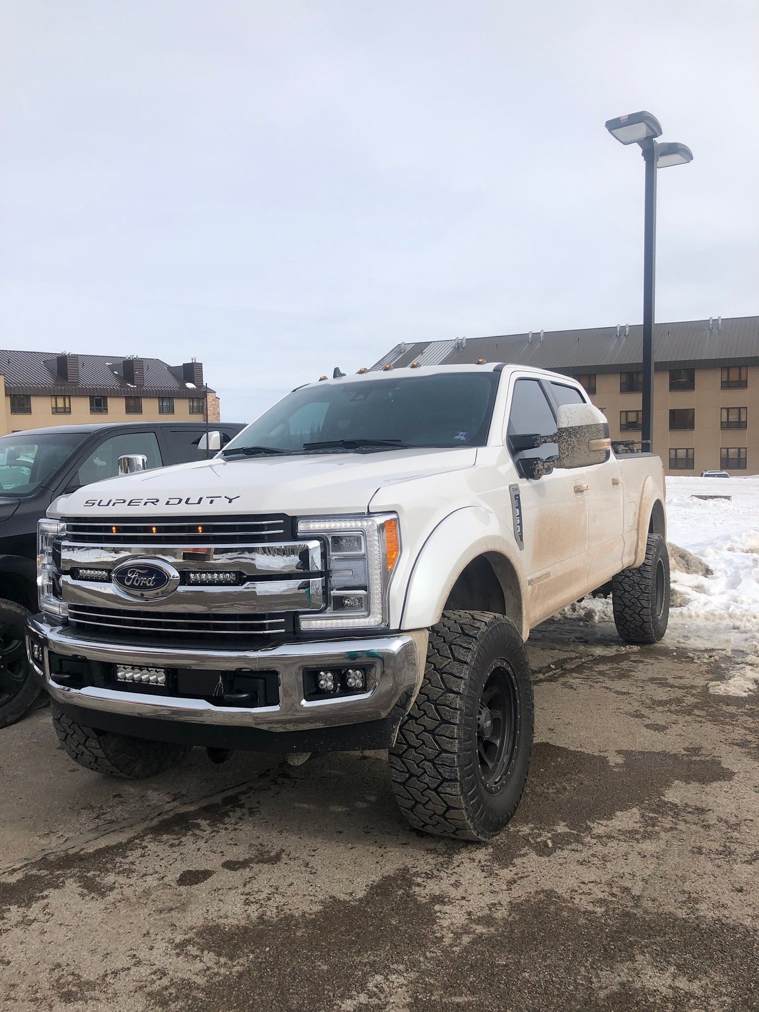

here is the mount I bought, but I bought the midnight edition lights which are black. they are 6" lights. https://www.rigidindustries.com/2017...sr-series.html

Bought these at Orielly Auto Parts and paid about $8 each, under $6 at Home Depot online
https://www.homedepot.com/p/Blazer-I...4BAK/300250042
They have a rubber gromment on the and they fit perfectly in the Platinum grlle like they were made for it, you can place them anywhere in that grill bar. Tied them together and wired to key on hot wire. Funny thing is the black wire is the positive and the white is the ground on the LED lights.

Rough Country

BIGT8600 Did you wire them to upfitter switch?

Yessir. running the harness wasn't hard but it was tedious. Lots of zip ties. Mostly hid it under the radiator shroud. The ground of the harness went to the neg terminal on the battery and the positive went to my upfitter #2. The harness has a push button switch built in. I left it on and wrapped it up well in tape which tucked up under the fender by the upfitter harness.
