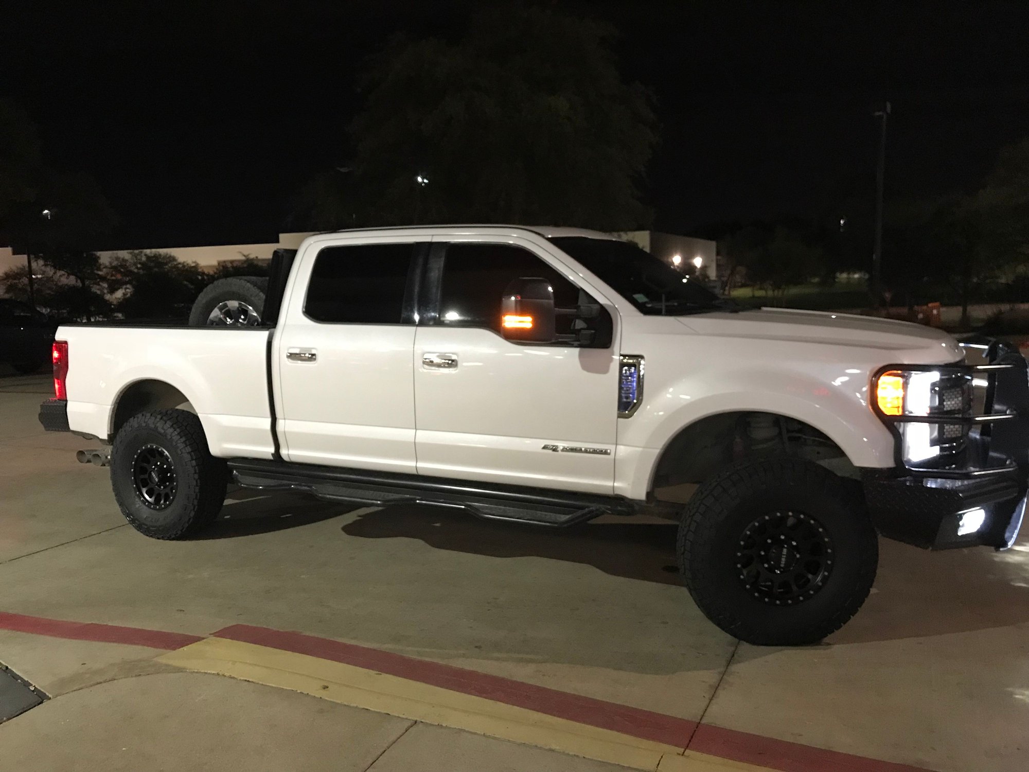

Here is my truck looks like. I'm running 17x9 wheels with a 0 offset (5" backspacing) and 37x13.50r17's.

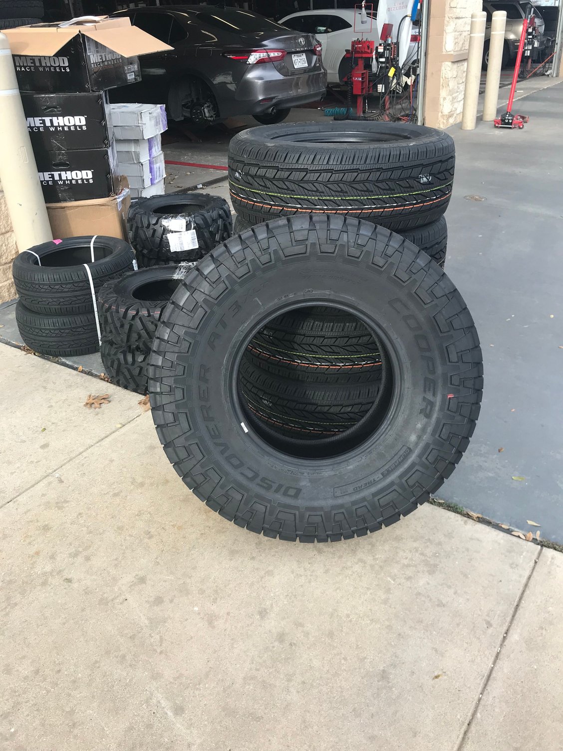

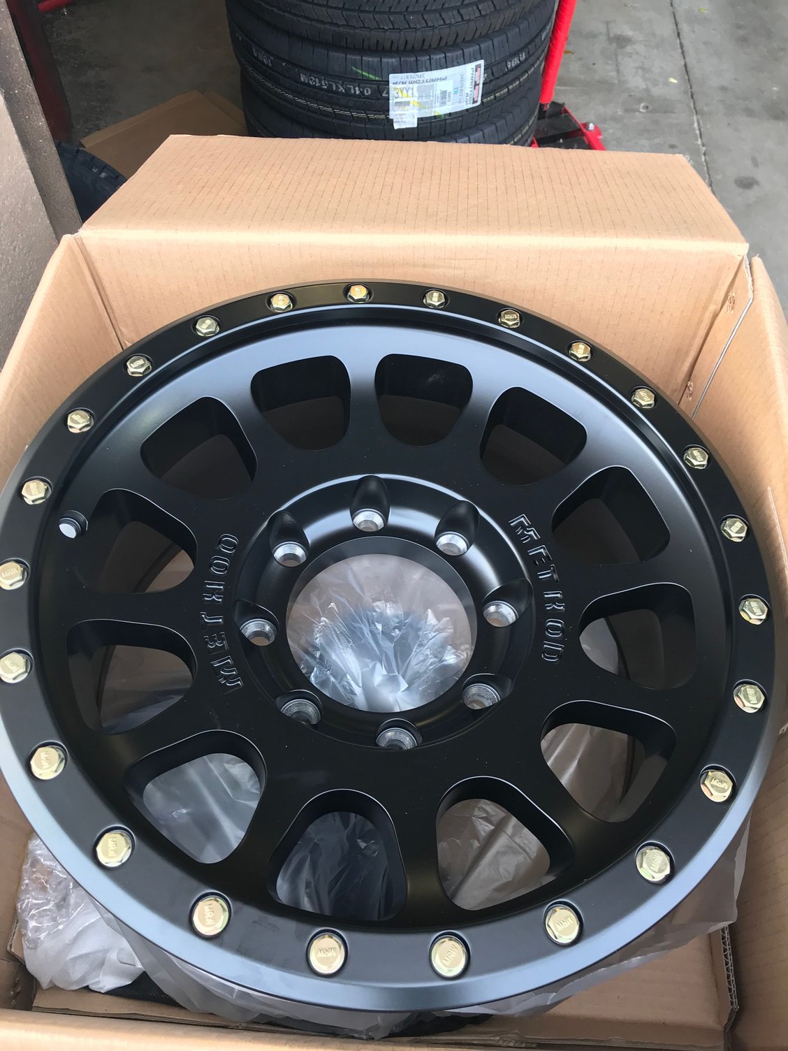

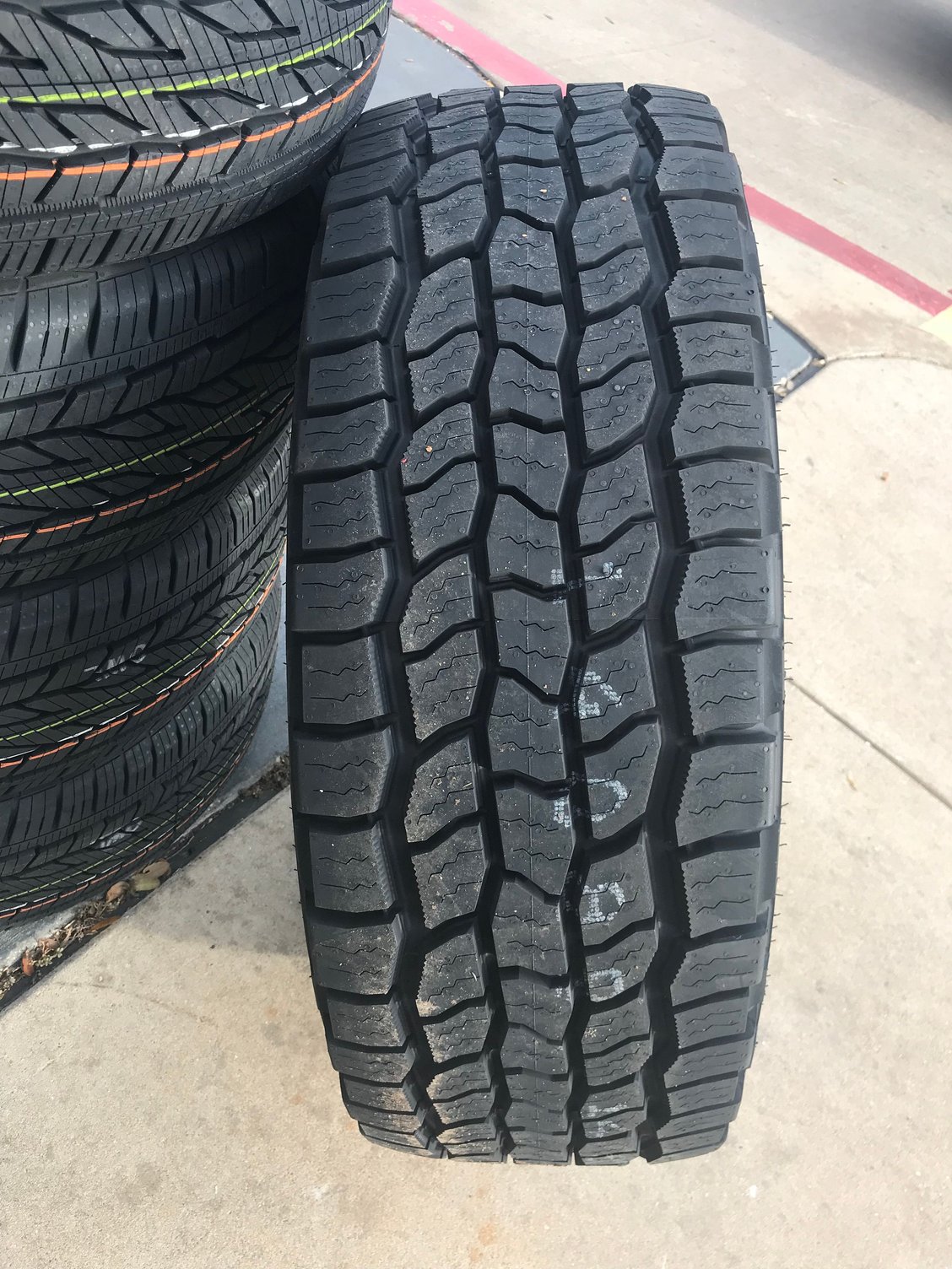

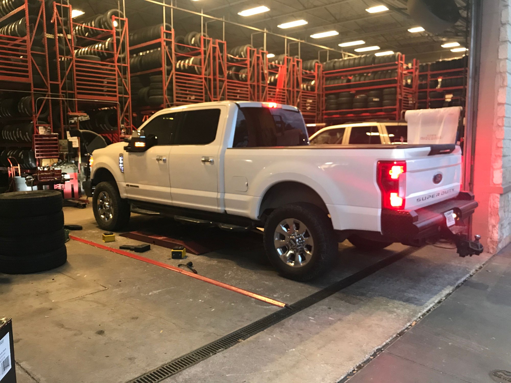

Just installed the new Methods NV 17’ with 0 offset and 4.75 BS on 8.5” rim. With Cooper AT3 XLT 37x12.5x17 They stick outside the wheel well exactly 1 1/4”. Sitting on a 2.5” Readylift kit and absolutely no rub yet. I’ll confirm tomorrow when I get out to the jobsite, but very pleased so far. I’ll upload better pics tomorrow from the front and back.
37x12.5x17 Cooper AT3 XLT
Method NV 305 0/4.75
Stock rims 295/65/20

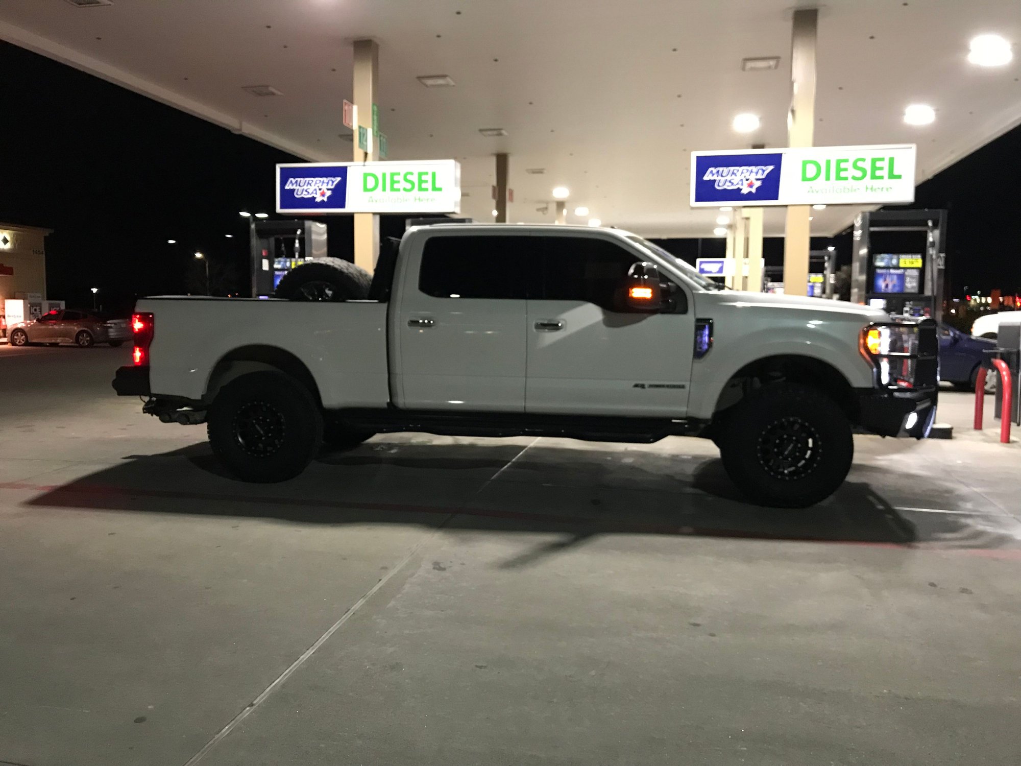

Not the best angles but these are 17" Methods with 0 offset and 35's
