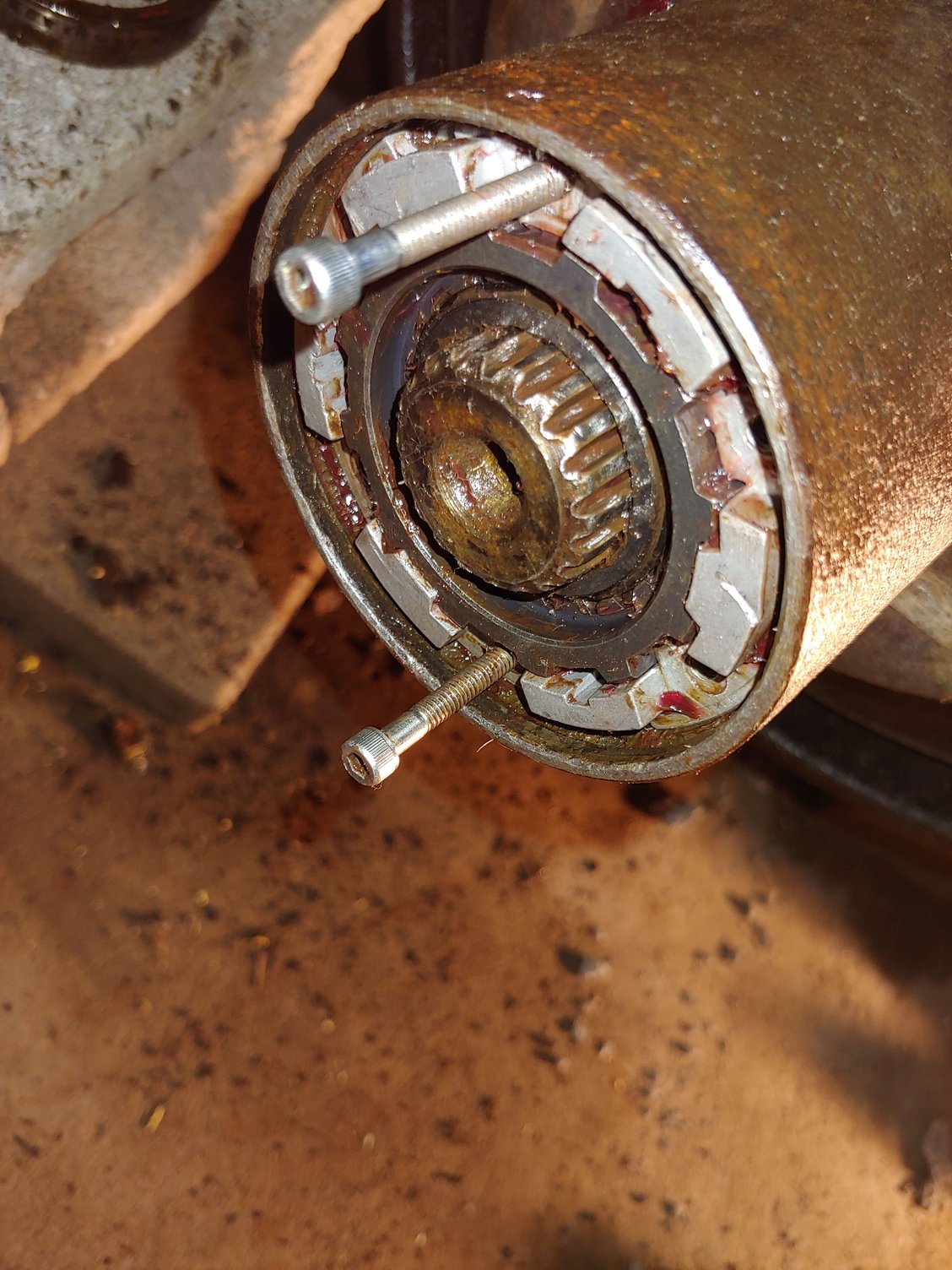

I got mostly every thing back together but seamed to be haveing an issue getting the lock out assembly far back enough I can get the inner snap ring on but can't get the assybly back far enough to get the outer snap ring on the one you have to use pliers to remove am I missing something

If it is what I am thinking, you can use a screwdriver as a pry bar, and push out on the U-joint to give you just a tad more space. Probably gonna need an extra set of hands to do it.

I got the axle as far forward as I can get it and the grove for the c clip is still not showing
