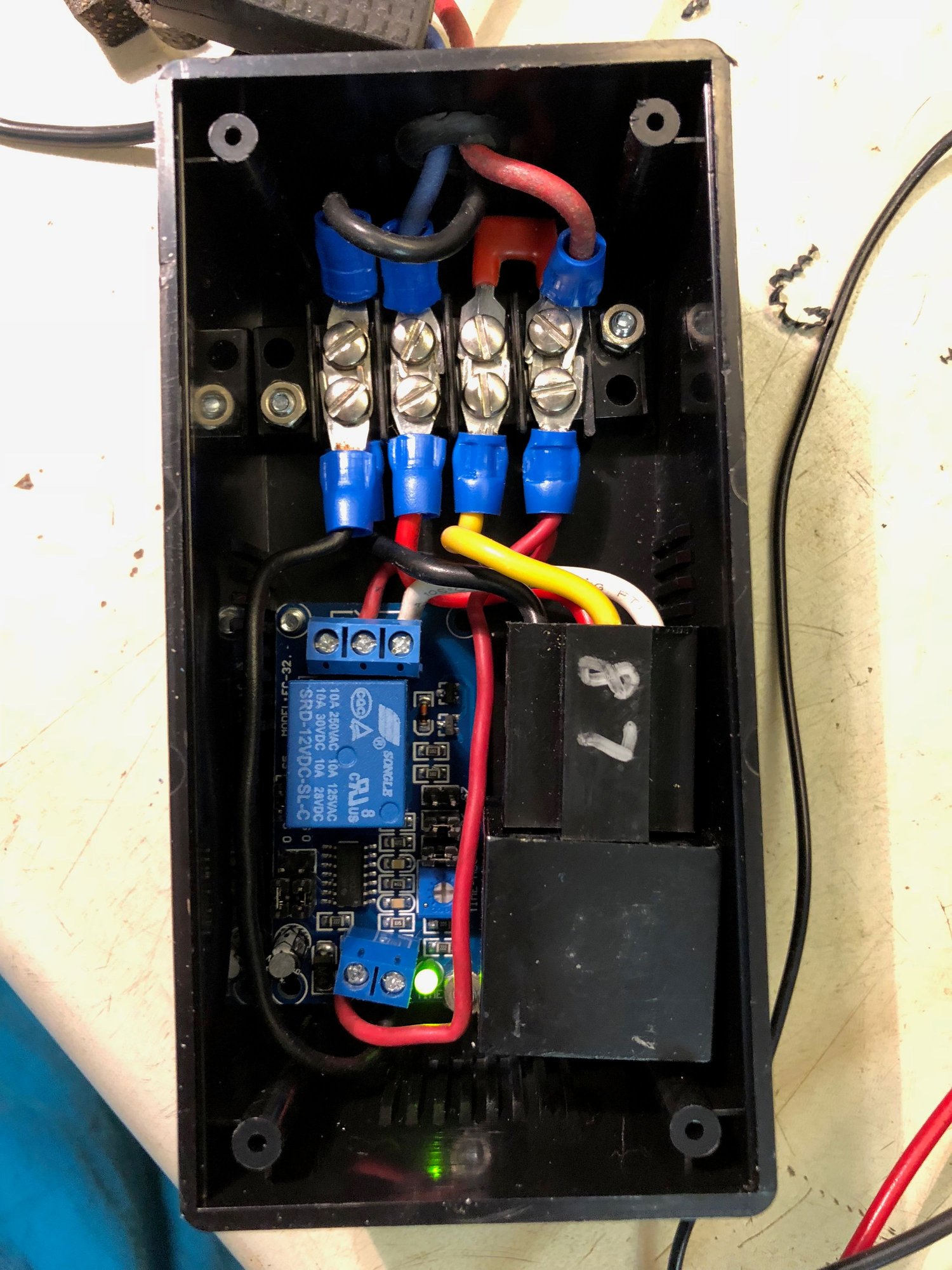

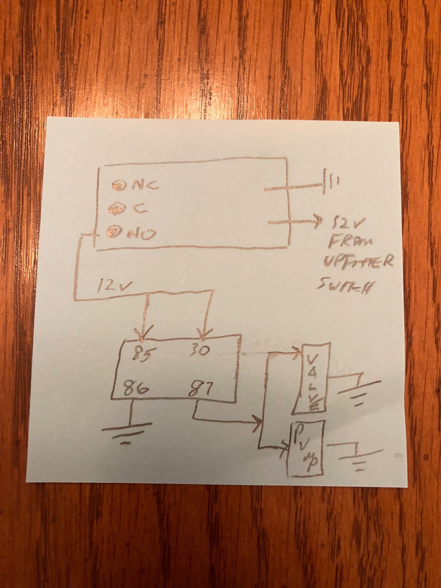

I have a 37 gallon RDS tank. I plumbed it into the main tank vent line and use a fuel pump and a solenoid valve. They are wired to upfitter switch #1 to a timer that allows the fuel to flow for about 8 or 9 minutes thus pumping about 12 gallons into the main tank. I taped off of the draw tube on the aux tank, not the bottom drain.
I've written this up on this forum and included photos. You can probably find it by searching on my user name.
It works well. The timer is adjustable; I only activate the switch once I am just under 1/2 full on the main tank. The approximate 1 gallons brings the tank up to almost full.

Can you give us info on the timer? What part number it is , how did you install it? etc.
Here are photos of the timer set up and the (very rudimentary) schematic.
The relay is a standard 12v, 30a relay. The timer relay board is from Amazon:
Amazon Amazon
I am thinking of putting in either a momentary switch to activate the timer in case I forget to turn off the upfitter switch. As it is now if you leave the switch on it will activate the pump everytime you restart the truck.
oh - I also have an amber LED I put on the dash in the bottom of my instrument cluster that stays lit when the pump circuit if active.
