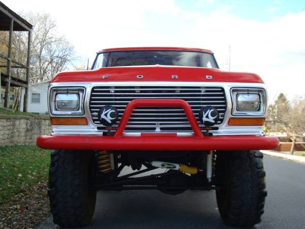

Parts to repop or custom make? Here are my recommendations:
Cactus smasher/OE pushbar
Bucket seat brackets
Rear "contour" bumper brackets
U-weld headache rack with light tabs
U-weld rear tube bumper kit
U-weld tube nerf/step bars.. bolt-on.
Bed rails... U-weld or fully assembled
Good luck on your enterprise!

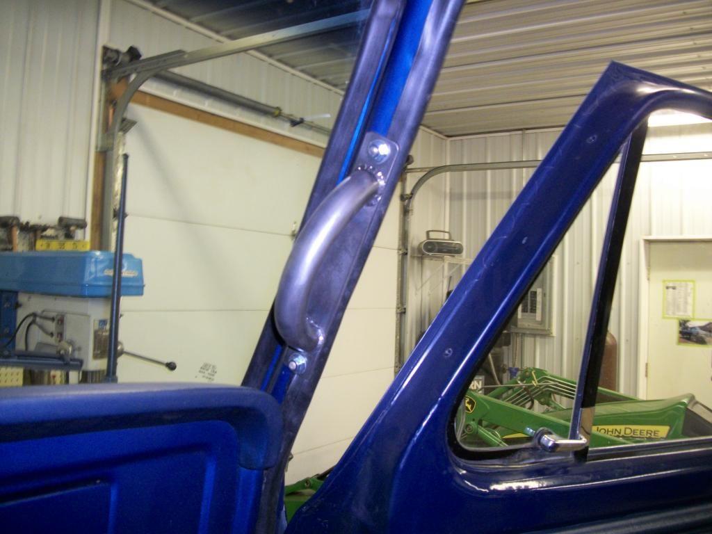

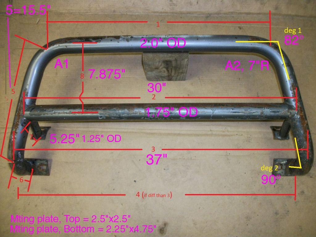

Well here you go and another BIG one IMO is the metal side fuel tank cradle used on 78/79 4wd. Sorry NO measurements on the other stuff. As far as the Catus Smasher they are the same for the most part, but different angles on the top bars for a 73-77 versus the 78/79 bumper. I do have a set of CAD drawing for brackets to mount newer style nerf bars/tubes to our older frames. Looking for it. The grab handles were made by a fellow FTE member. I am lucky enough to have a set from him and they are not mounted yet. Made the handle out of race car drive shaft safety loop material.

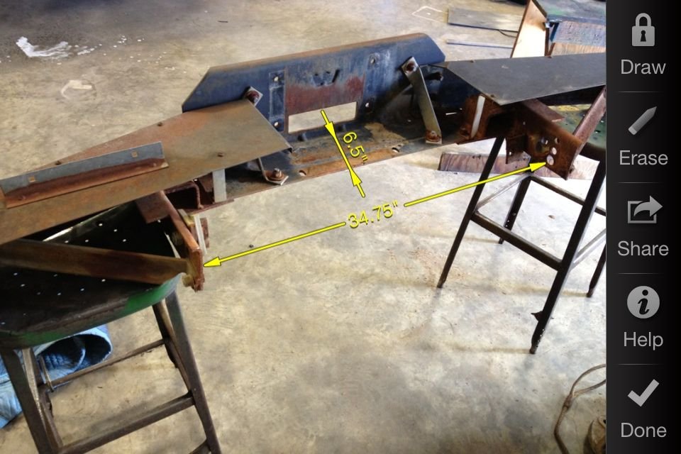

Another idea...duel battery mount bracket (battery mount for DVRS side of truck). Push bars...I have both black and chrome bars in my shop to get real time measurements. I even have a 73-77 and a 78/79 OEM push bar setting on the shelf.

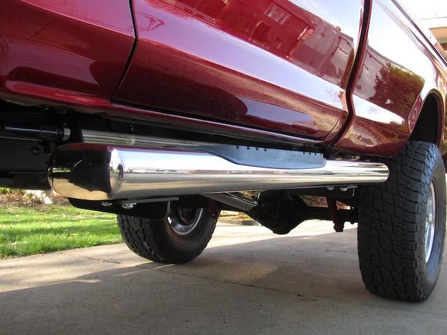

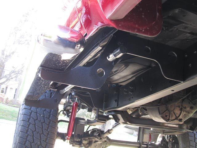

And the bracket to put most common aftermarket/modern day nerf/step tubes bars on our trucks.
