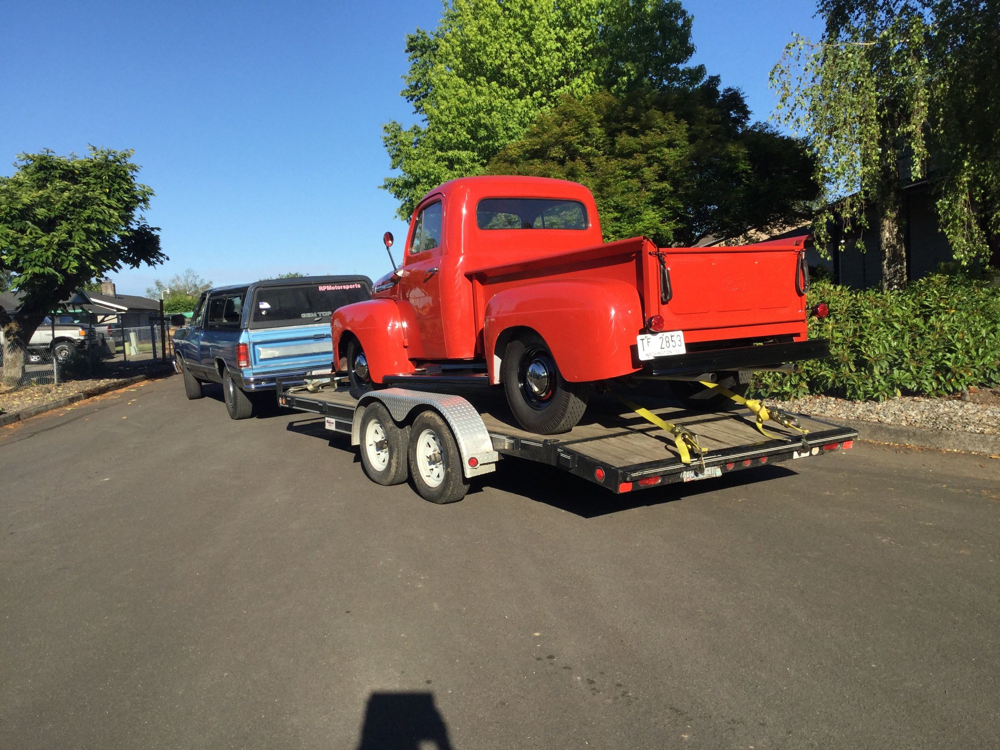

I used a SIDS dropped 3” stretch axle. Poise Superslides on rear. Everything had been rebuilt by previous owner so it was a bolt in. 6.00 x16 front,7.50x16 rear and it sits just right. Dovetail on trailer makes it look higher in the back than it really is.Bottom of stock bumpers to ground is 11” front 17” rear. I was going for an older look with bias tires and Steele’s. Did have some front wheel shudder when hitting a bump but a steering stabilizer took care of that.
