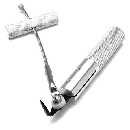

To pull the glass out there is a tool to do this. This is what I use to remove all my glass. In your case you don't have to worry about cracking the glass LOL You will find little rubber blocks at the bottom to hold the glass from slipping down don't throw away them blocks just incase you need them.
