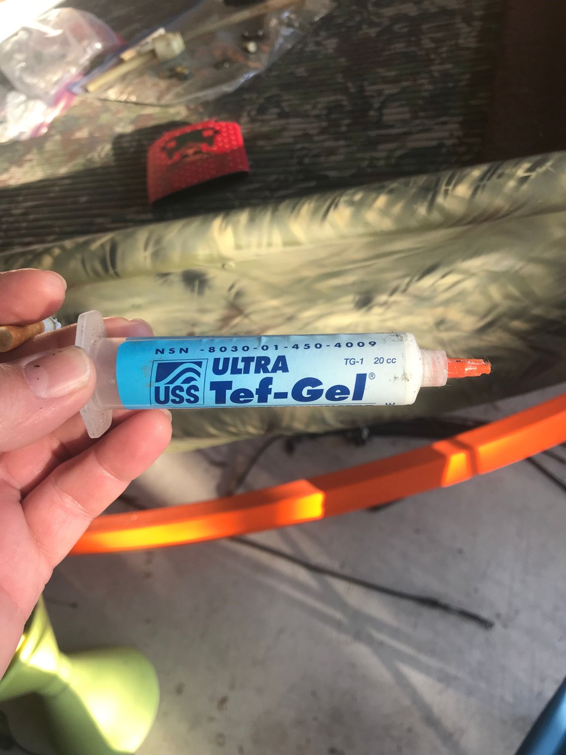

i started using thiis product years ago. It is expensive, but its the next sliced bread. I apply it to any fastener that is going to come into contact with a dissimilar metal. It will also keep nuts and bolts from corroding. 5 years later a fastener exposed to saltwater spray will still come apart like they were mated and torqued yesterday. I’d suggest every man keep a tube in their tool box. I also use nylon washers anywhere torque specs are not crucial. Just makes me sleep better at night. ​​​​​​​

And look the product has a NSN. So it meets all the mil specs and is a proven product. Years of experience and expertise plus military grade product.

Well no it does not mean what you are stating. A National Stock Number (NSN) is a 13-digit number consisting of the four-digit Federal Supply Class (FSC) and the nine-digit NIIN for the product. It does not in any form or fashion MEAN it meets any Mil-Std or is a "military grade product". It only means it is cataloged and put into the system IF approved by the DLA. Commercial items as in this case are bought as such have National Stock Numbers just as a FYI.
The part that contains the NSN may be a qualified part for a F16 or F22 just as an example or it may be a tool or a lubricant just as an example.
Do not want to confuse people here with incorrect, misleading information so thought this needed clarification.
