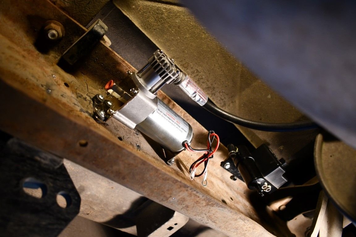

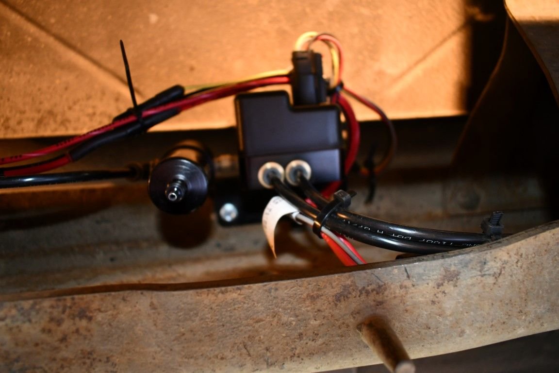

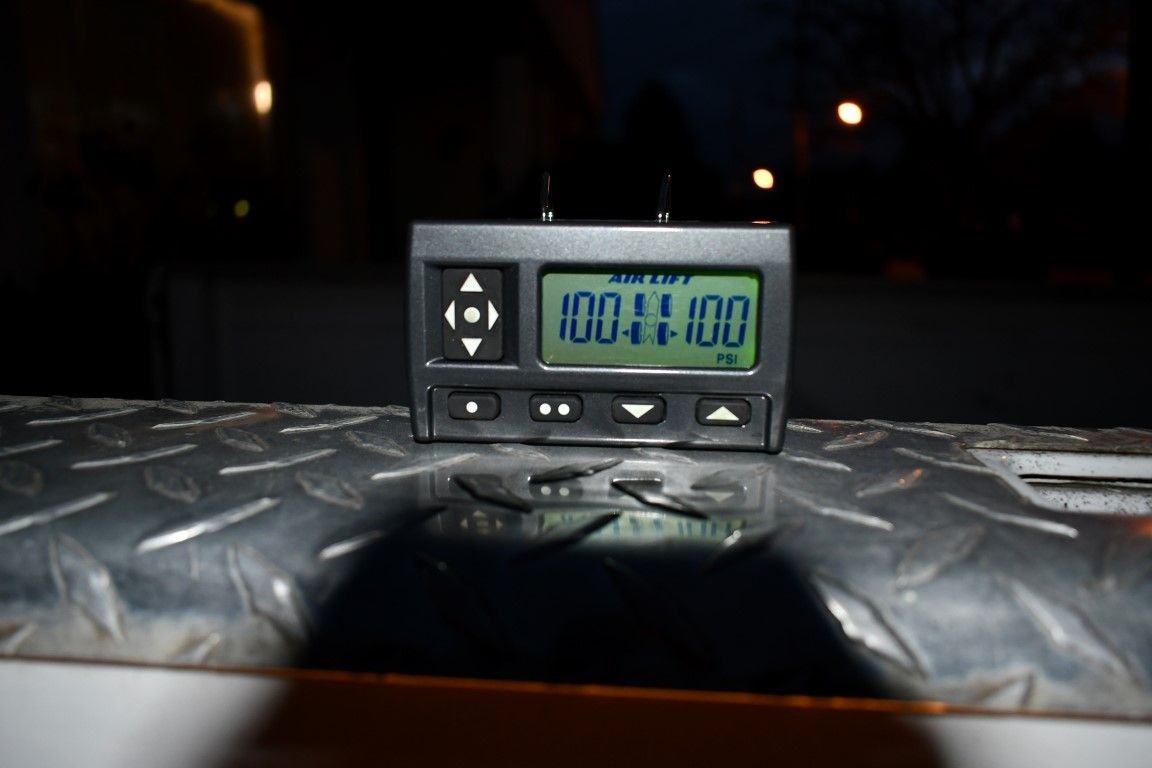

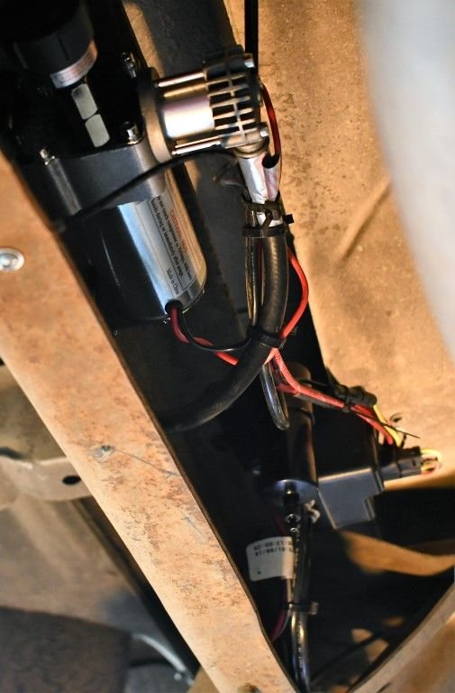

If you have an on board air compressor and it is not plumbed for manual fill as a backup to the compressor, I'd do that as well. Like River Wild I pretty much eye ball. I also go by 'feel'. When driving down the road, I gauge how the steering wheel feels and reacts. If it feels light or like it has 'super power steering', I add more air. My camper has a "revolutionary new roof design" (to promote drainage) according to the sales brochure. Makes it look 'sunk' in the rear end even though it is not and the overloads not even engaged.
This is not necessarily where I run them out. I took this right after I installed the remote air compressor and was running a test looking for seeps or leaks that the soap water didn't show right away.
