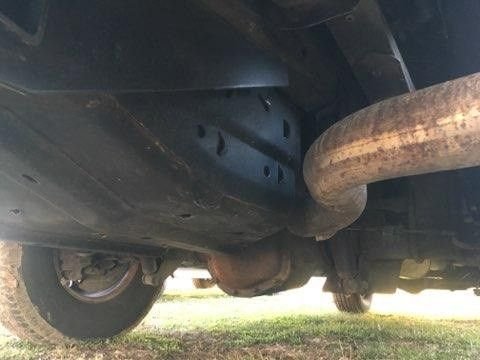

Hi guys, I am looking at buying a 2002 Excursion 4x4 7.3 Limited. The truck is 300 miles away from me so I have asked for quite a bit of photos and most everything looks good. I did see something that caught my eye though, and thought this would be the best place to ask.
Under the hood, on the right side near the firewall is a wiring harness. There are what appears to be 4 wires sticking out about 5". The ends are not capped and aren't hooked up to anything. Any ideas? Also, I'd be looking for any feedback on what else to keep my eye out for. I have heard the usual about making sure the tranny shifts smooth, no steering wander, goes straight while braking, etc. Any help would be greatly appreciated!

Get close ups of the rocker panels, with the doors open, real close ups and then the back side too. Common area for bad rust.
Oil pan pictures
Oil leaks are an issue too. Every 7.3 will leak at some point, not if but where and when.

Thanks for the help!
Everything looks good to me so far. I will be asking for a hoist when I get there, to check for leaks and what not.

Looks pretty good so far! Keep 'em coming!

The rockers below the rear doors rust out before the fronts. I'd be more interest in see those.
