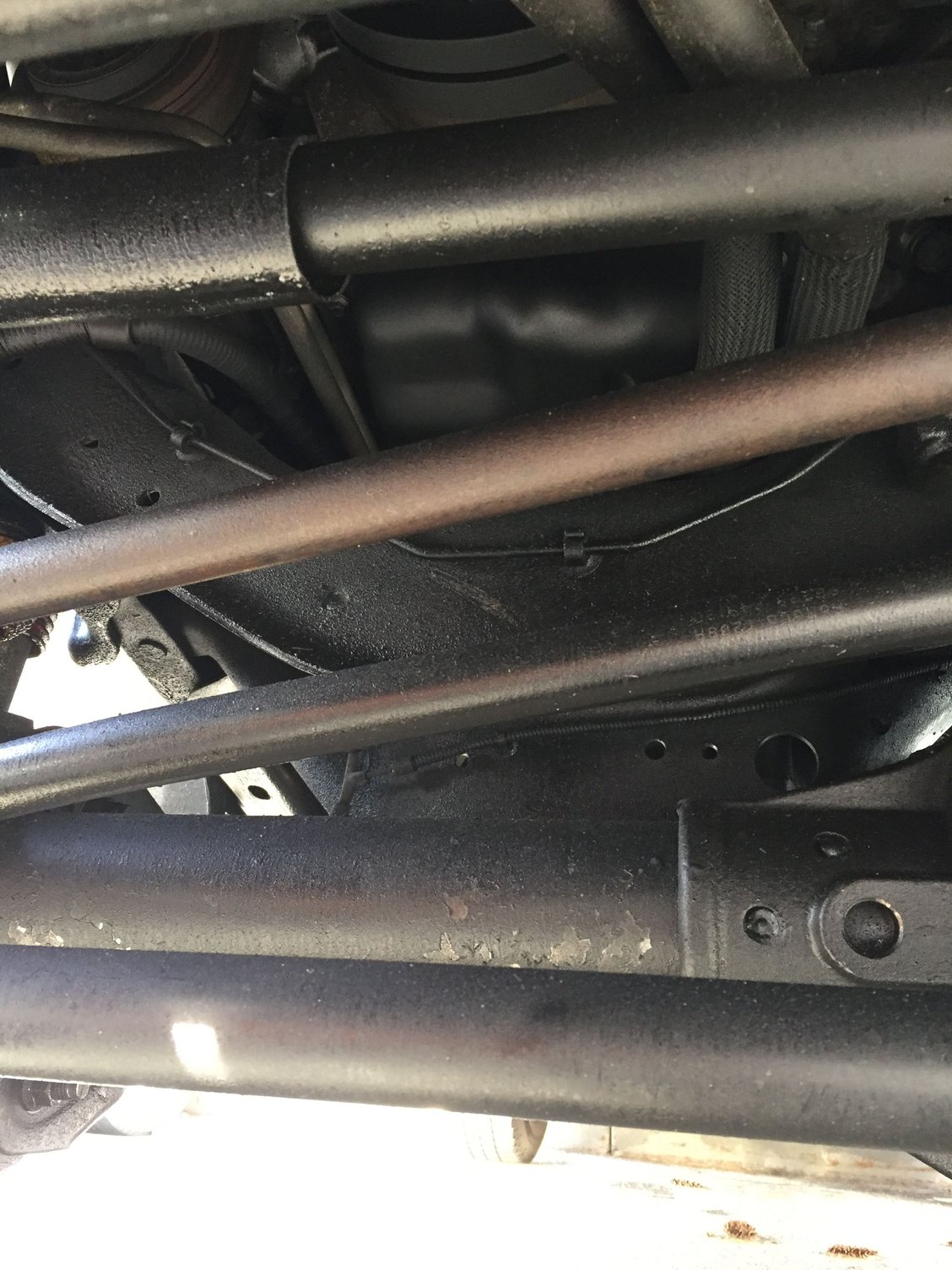

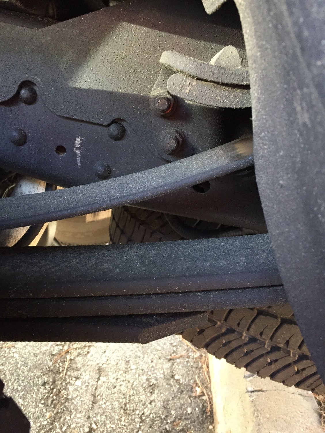

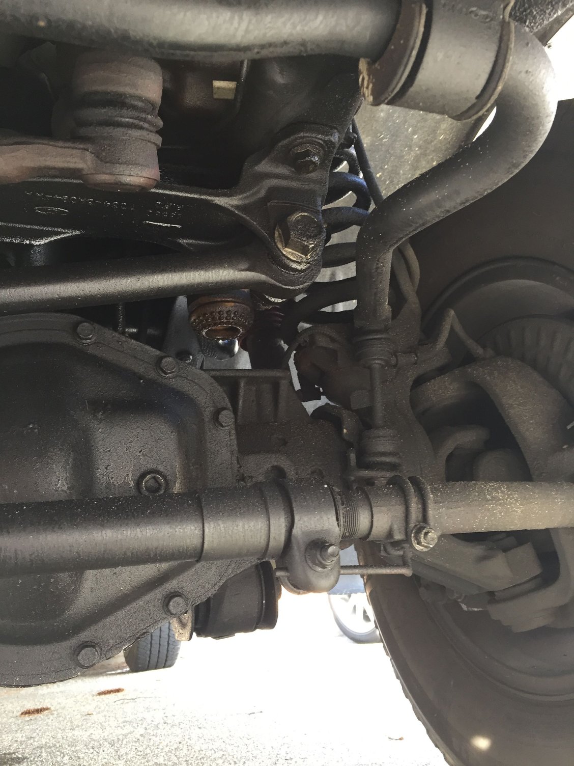

Don't know what happened but the stuff I wrote in the last post was deleted when I added pictures. Anyway, these pictures are from last spring when I did my spring wash and fluid film treatment. The truck had been through five winters. The dark spots you see are leftover grime I didn't get washed off, I don't do a spotless wash but get most of it.
Like mentioned above I wash and apply FF twice a year, spring and fall and dont' really touch the underside outside of those times and so fat I've been pleased with the results. If I drive through some manure(it's everywhere here) or really heavy water I'll wash and touch up the FF but that's about it. I did notice last week the ends of the rear sway bars have some surface rust but it looks like the FF was rubbed off, probably from driving through the grass during hunting season. Also noticed the bands around the rear spring packs are rusty, not sure why because they have been kept coated but they do catch a lot of debris from the tires. Other than that I do have some surface rust on the axles, tie rod ends, and steering gear but those parts were rusted from the factory and the axles I didn't coat the first year because it's hard to catch leaks if the part is always grimy but started coating when the rust showed up.
I don't have a lift but drive the rear end up on some ramps and that gives me enough clearance to do a fairly good job cleaning.
ETA. For the foam above the wheel wells I just soak it down really good with FF and am hoping for the best. It's pretty hard to get up there to do a good cleaning and I really dont' want to introduce more moisture up there then I have to since it doesn't dry fast. I usually touch the foam and if it's still damp with fluid film I add a little more for good measure and call it good. This area I only hit once a year in the spring. Inside the doors, rockers, and any other hard to reach area that doesn't get direct water spray only gets done once a year and I dont' introduce water into these areas, I only add more fluid film. So far the inside of the rockers are spotless from what I can see through the access holes.

Fordman— those pictures are amazing. It looks like the truck is still sitting on the dealer lot!
